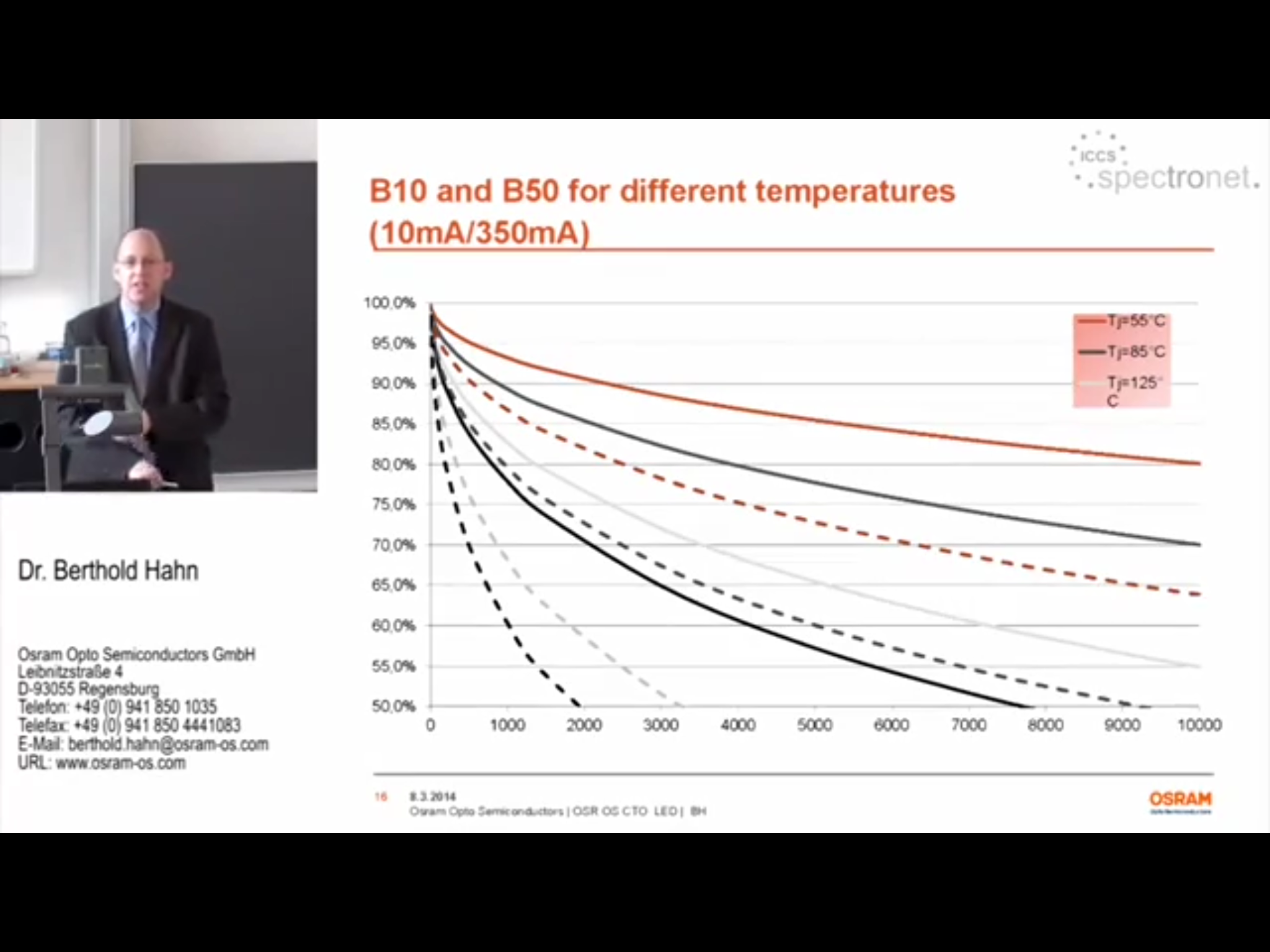

They get dimmer. In the datasheets one can usually find “L70” lifespan. This tells you how many hours on average it takes for this led to dim down to 70% of its inital brightness. At this point it still works though! Just a bit dimmer.
Heat kills LEDs! The higher the average temperature, the lower the lifespan.
Also what most people don’t know is that higher currents are actually better for LEDs than really low currents (at the same temperature). Very low currents drastically reduce the lifespan of an LED. This is something that is not stated in most datasheets.
Interesting. Could you explain? I couldn’t find a figure in that presentation that explained it. And I don’t understand German.

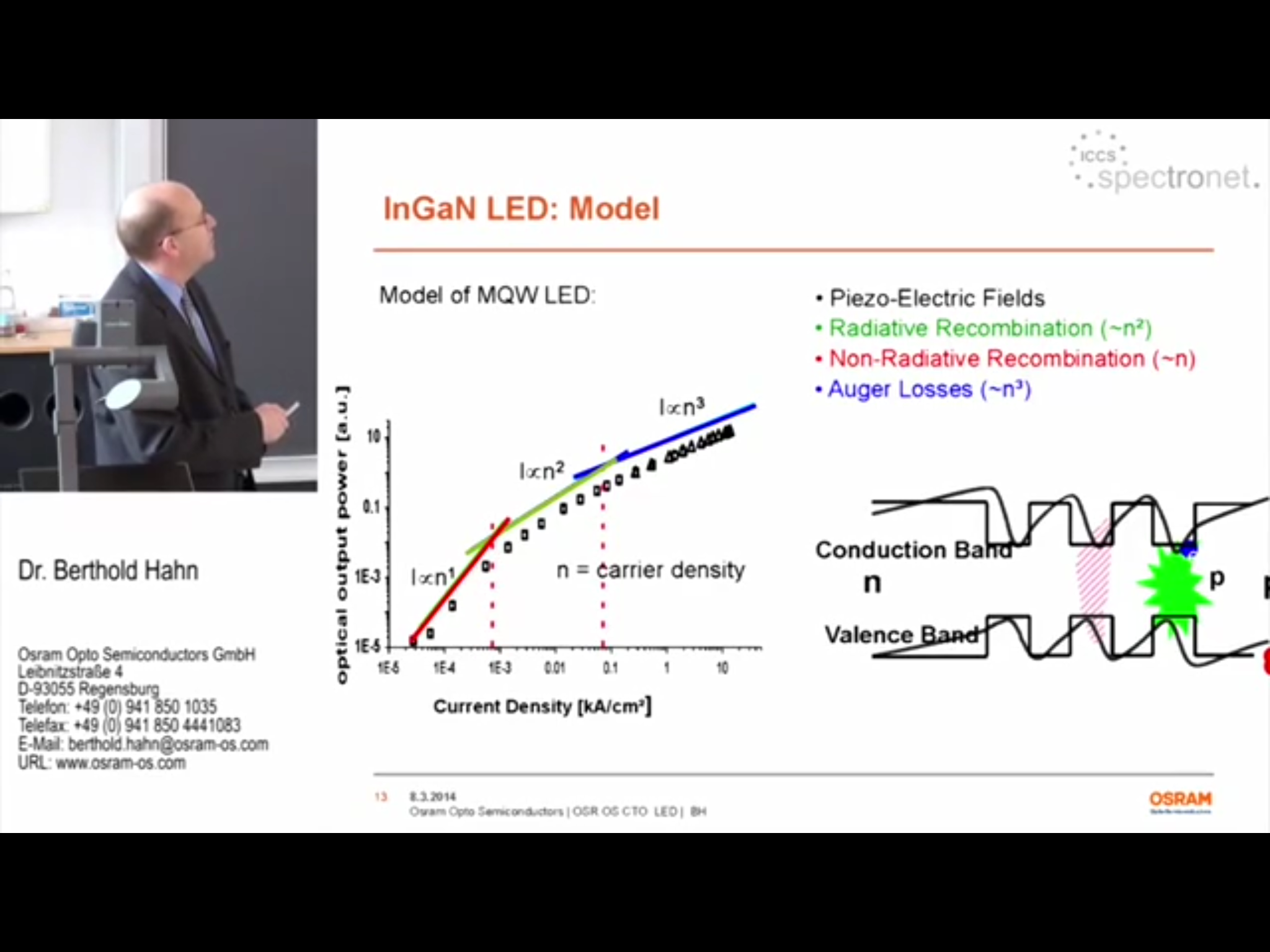

From 13.16 to 16.20 he talks about how low current is responsible for dimming and color changes over time. much more so than high current. He shows three graphs to illustrate this.
My knowledge of electronics is very limited, and his Austrian(?) accent doesn´t make it any easier to understand. But i think that is what he is saying.

The guy is an expert working for Osram on these things. You would think that he knows his stuff when he holds a presentation on this topic. I just saw this video a few days ago and it was interesting, but seemed plausible.
In the video he states that this is something that manufacturers don’t tell you in their datasheets. That is a known problem. For example most manufacturers don’t state the luminance (cd/mm^2) of their LEDs even though it is crucial information (for throw). Osram is one of the few which do this.
If you look into the datasheets of some power LEDs you will see that they state rather high minimum currents. Maybe part of the reason is the reduced lifespan.

No, because how low “low” is depends on the specific led type. A Cree XM-L has a different range compared to an indicator light.
Larger LEDs are usually more expensive compared to smaller ones. For an indicator LED nobody would use an LED that is underdriven. It makes no sense.
Similarily in flashlights nobody will make a light with an XM-L powered at 10mA in the highest mode. It just doesn’t make any sense.
I think this “problem” is not really a problem. Basically nobody will ever notice.
