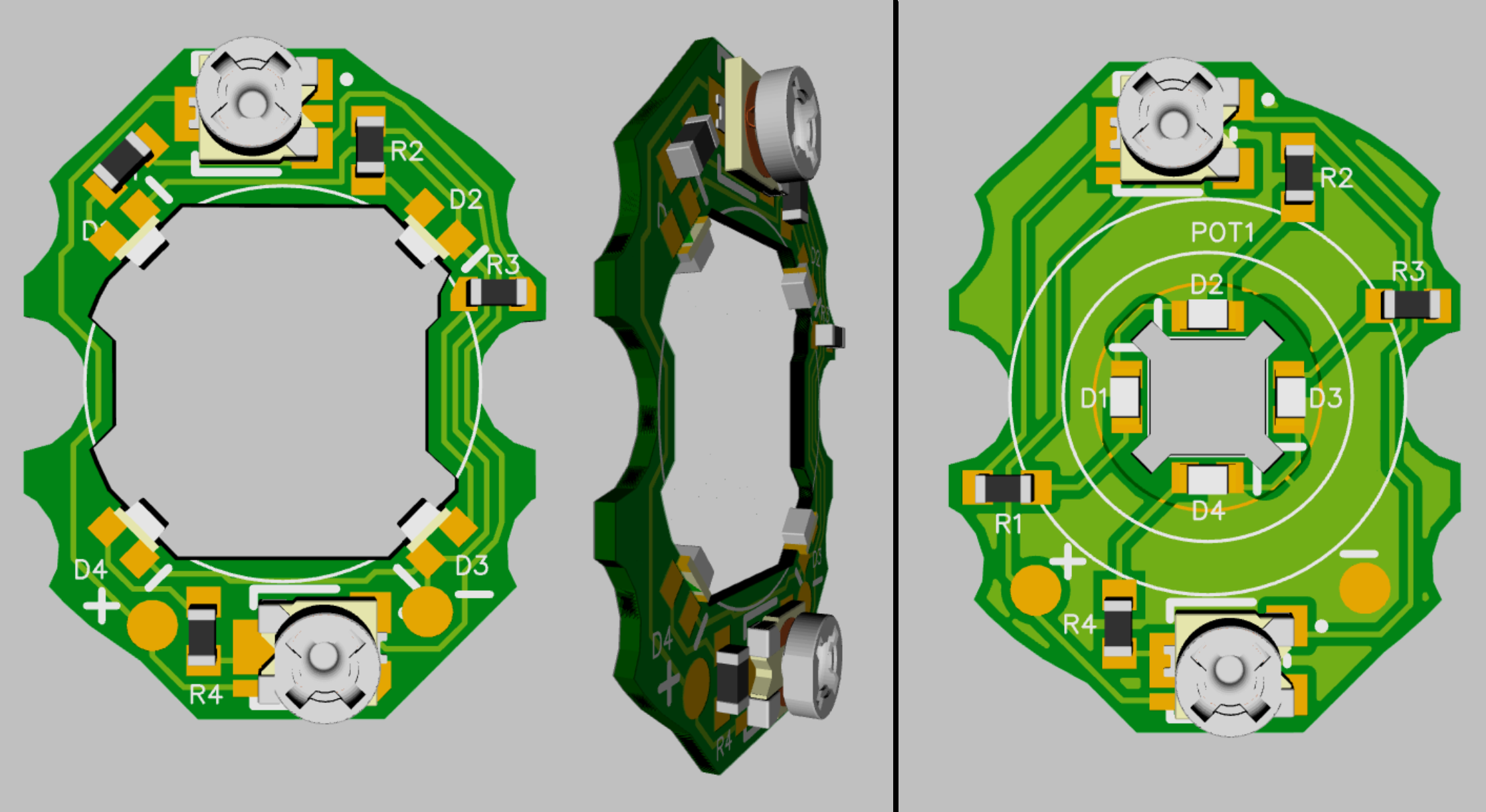

[SALE] lighted TIR boards, D4, D4S, ROT66, MF01 multicolored with low battery waning and LVP
D1 is not TIR its reflector with aux boards placed inside the gasket
I sanded that board to about 0.1mm thickness
the board with indirect gasket leds is not tested yet
Send me one and i’ll destroy my D1 for science:
LED Light Pipe + Dremel + UV Glue = ???
its meant to indirect light the white gasket
direct light version looks like this
I know, but why let it go to waste? The D1 doesn’t get that hot anyways I can make some holes, lol
edit; I mean in some cases they help cooling too…

It is not easy to install. The driver is hardly pressed in and there is verry less space for wires and soldering.
You will need a tiny wire for battery- on the aux-board. Battery+ is the same as LED+.
Usually most people do a reflash to D4S Firmware and use LED pin on driver for +
You could also flash Anduril for D4 with Aux support. D4S might work, but it’s not ideal as the part for the thermal regulation is made for a bigger part. Also the level mixing is off, as the D4S has more AMCs.
see here: How-To: D4 with Anduril + Aux support (windows)
But the whole process of installing (and flashing) is not a newbie task
So if I understand correctly, the LDO on the D4 TIR board causes it to have only one level of light? But if you took out the LDO then you could have low/high? I’ve never used aux lights before, so I’m basing it off of the H03 lexel driver with anduril, the light under the button has a few modes, high, low, flashing, off. Would this be the same with the stock D4 TIR board? Or would the LDO need removed? What are the implications of doing this?
I know I will need to flash the D4S firmware, or D4 anduril with the aux code added. But the LDO has confused me.
Sorry for all the questions, I want to learn, trying to understand.
Yes if you want high low then the LDO can be replaced with a resisor, which fits 0603 to get between the pads or build with resistors based on 3.7 not 2.8V
The LDO is to stabilize the current while battery voltage drops

Edit 2: also, will building without LDO drastically increase current?
1. they are ready
2. you will need to use a resistor to get same brightness if you mod a board which was built with LDO, or it gets a lot brighter

Can I order a D4 board with a trimmer installed instead of an LDO so I can adjust current without soldering?
If yes, what is the approximate adjustment range for the “0.3mA” and “0.15mA” levels?
Problem with D4 board is it has no space for a regular 3x3mm trimmer
2x2mm trimmers may be possible to fit would need a new design and are pretty expensive so I never invested in that build
It is possible to replace the LDO carefully soldering with a resistor and you can use high/low feature with D4S Firmware to get on low tritium brightness
or just build at very low constant current with LDO
