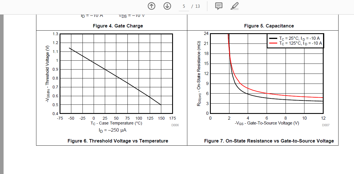

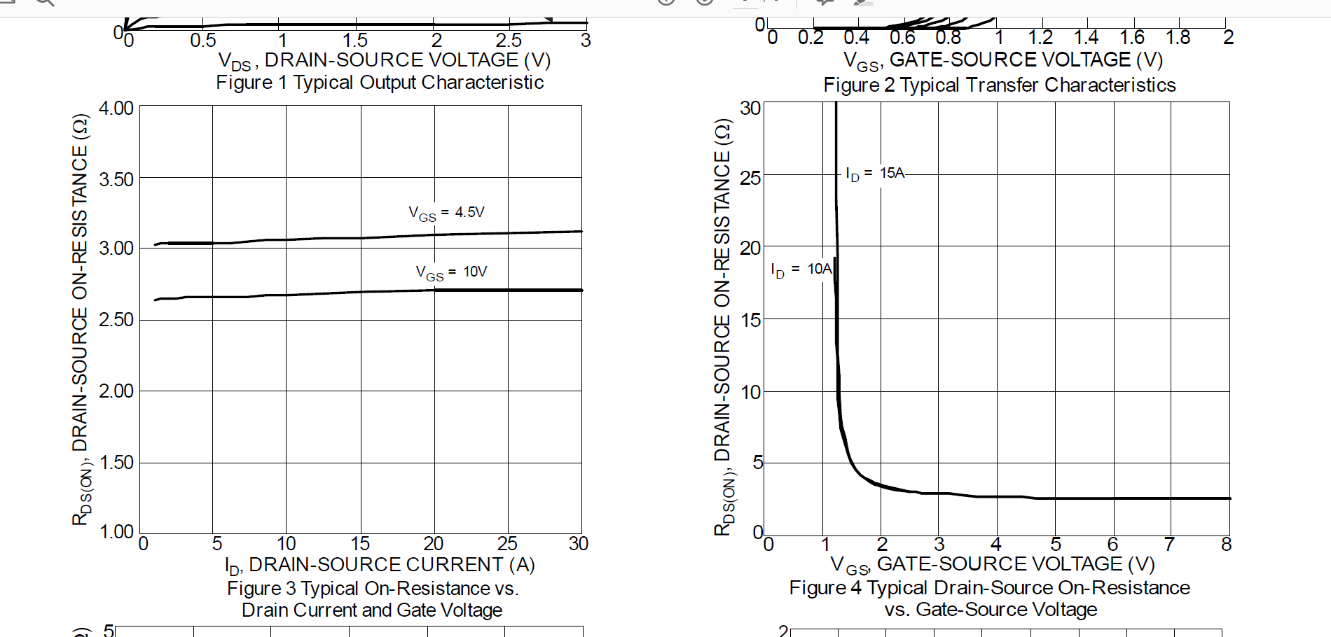

Wellp, went to the Alpha & Omega Semiconductor site to look for AON7403 alternatives:
  • AON7405, higher rated than the 7403 but still no good performance at low VGS.
  • AON7421, yes now we're talking. Nicely low RDS(ON) (< 9mΩ) even at VGS = −2,5V.
  • AON7423, out of production unit even better than the 7421 (?); maybe there are units lying around.

I mean, you could get this too:
https://www.digikey.ca/product-detail/en/toshiba-semiconductor-and-stora...
It’s in the same package, and has even low resistance at 6mOhm even at VGS = -2,5V.

Nice find BlueSwordM, also in stock at Arrow (free Wink shipping): https://www.arrow.com/en/products/tpn4r712mdl1q/toshiba
TPN4R712MD.L1Q datasheet
Also cheaper than the AON7421, but way slower switching speed though. tr + ton + tf + toff is 198ns for the AON7421, 617ns for the TPN4R712MD.L1Q, and just 42,2ns for the AON7403. The buck converter frequency is probably ≈300KHz, I wonder to which point do these parameters matter.
I'd like to hear some experts first. Big Smile

That buck controller is an XC9221, you’ll find guidelines and the relevant formulas in the datasheet here.
I think 4.7µH is already on the low side for 300kHz, any lower might cause stability issues, but if you can fit a bigger size inductor anyways you can up the current rating at that value.
I don’t think switching speed of the FET is that big of an issue at 300kHz, but what matters is the input capacitance (recommended <1500pF), otherwise the controller can’t drive the gate fast enough. (That’s where the Toshiba shits the bed)
btw, Vishay and TI have very good FETs (like the CSD25402Q3A )

Thanks for the input kikkoman, seems the XC9221 wasn't designed for higher than 3A output and I want to make it go a lot beyond Crazy that LoL. Thank God at least the schottky Innocent is generous.
Both the TPN4R712MD.L1Q and the AON7421 have about 3x the maximum recommended input capacitance listed in the XC9221 datasheet. The CSD25402Q3A is a nice find but it is not available in single pieces at Arrow, so I have to keep looking.

There’s its brother, the CSD25404Q3 – slightly lower Rds, slightly higher gate capacitance (but still quite low), and it’s a bit pricier. 0.95€ for 1.

Thanks again kikkoman, I was even then hopelessly looking at the PowerPAK 1212-8 section at Vishay.
Guess will have to try that CSD25404Q3. The input capacitance is specified at 10V, it should be a bit lower at a bit less voltage, doesn't it? Also, the QX9221 shouldn't complain if a little bit above 1500pF…

Been peeking into some small package p-channel MOSFET datasheets with low input gate capacitance. There are some better offerings over the stock AON7403, the Infineon IRFHM9391TRPBF for example. However, all of them exhibit noticeably lower performance at less than –4.5V of VGS, and already a lot lower at –3.5V. I am surprised at how this driver did not have some problems on high mode with less than 4V of input, but of course this is due to the relatively low input current. Sucks, really.
Sat, 04/06/2019 - 20:53
Lexel
Lexel's picture
Offline
Last seen: 20 min 55 sec ago
Joined: 11/01/2016 - 08:00
Posts: 5145
Location: Germany
Hi,
you may have a look on 3×3mm footprints I found there some way better P-FETs
you can PM me if you found the right
a slight hint which makes you think its a N-Channel buts its indeed a P-FET
I have looked also at ultra low Vgs N-channel FETs I found one that has down to 1.5V almost no increased Rds
btw your infineon datasheet link is not working
it is a really bad choice looking on Vgs graph for 1S drivers

those are 2 very good fets
the one with red graph P-channel
the other N-Channel dont mix em up together
I dont write the type as its sort of a lot research I did to find them but you should be able to find them
if you look for an 1/2S replacement FET you need one that stays at a relative stable Rdson down to 3V better 2.5V
