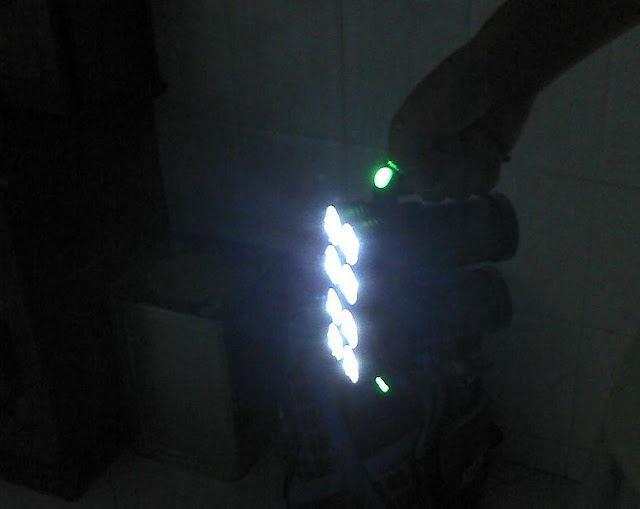

DENGOH
DENGOH's picture
Offline
Last seen: 2 months 3 weeks ago
Joined: 10/06/2012 - 05:26
Posts: 2157
You guys should try with 2x Terminator outputing 5000 lumens. I attached them together thought just for experiment, but 10 days ago until now I don’t want to take them apart. No more darkness in front of 2x Terminator.
Low quality picture below taken with my handphone.
!https://lh3.googleusercontent.com/-MAsMScEEbhY/URe9pxM8jUI/AAAAAAAAALY/R...!
ERMAHGERD.
Very cool! Not real practical, but cool none the less.
DENGOH
DENGOH's picture
Offline
Posts: 2157
Because they have two handles, one of the way I hold them is on the top of my head. I can also hold them with single handle just like the picture.
This configuration makes me not considering Olight X6 and Klarus RS80 as strong as before because they are quite similar to me, or I am afraid I will not be amazed anymore by X6 or RS80.
I think it will be practical if one knows the limitation of their flashlights. Or one really needs 5000+ lumens and above, and this is cheaper way to achieve it with branded LED flashlight and quite portable with its size and handles.
