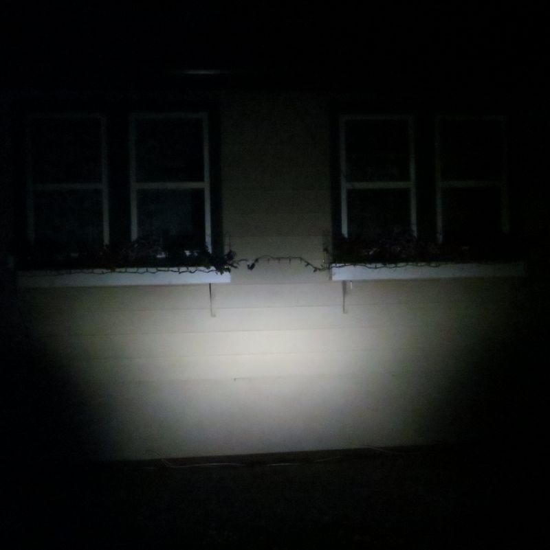

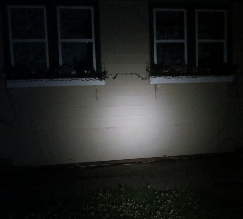

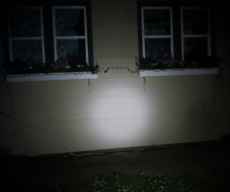

10 meter Beamshots:
The green button seems to be the ‘spot’ beam, here illustrated on high setting:
The yellow button is the ‘flood’ beam:
When they are both turned on they combine to look like this:

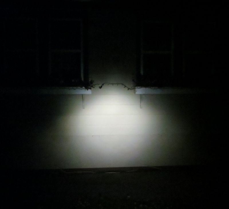

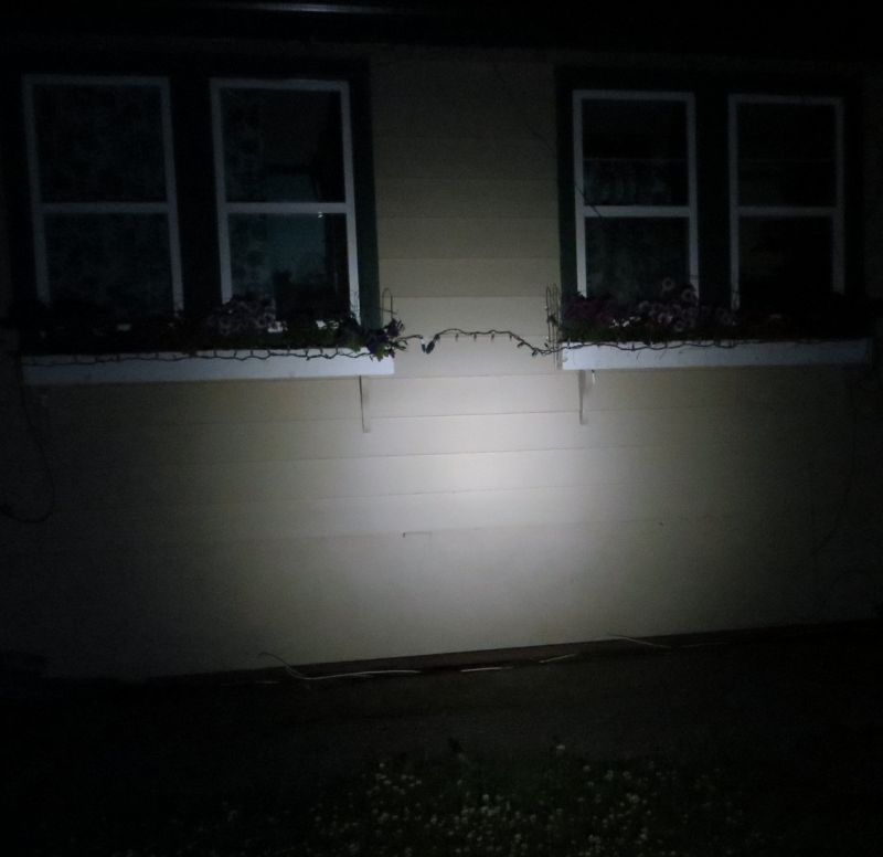

For comparison purposes, some lights with emitters you may be familiar with:
Spark SL6S-740NW XM-L2 Flashlight (on ‘High’, not on ‘Turbo’ as I think Turbo does auto step down):
Convoy M2 with XM-L T6 4C, direct drive:
Convoy S4 XM-L T6 4C Nanjg 105c @2.8A:
