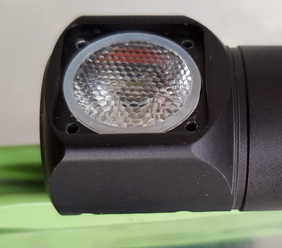

The new TIR back light is ready and works fine. Only problem now is a stripped thread. The original screws are M1,6*2.5mm. Extreme short! On the front SS frame you loose 1mm and at the o-ring another bit. So the srew was only in with 1/2- 3/4 turn. I ordered a few A2 1,6*4mm screws. Will have to grind the screw head a little bit (3mm to 2,5mm). But i have to wait 2-3 days for the package.
On the picture you see two strips of copper foil (what you use for making Tiffany glass art) on Kapton tape. Next i soldert the leds to the foil added the leads and covert it with UV resin. Then cut it out with scissors and glued it inside the head. On the picture is the light without the Stainless Steel frame. The color is more ice blue with a glimmer of purple/pink if you see it in real. And it is more dimm in real. Also i disconnected the switch led so only the TIR backlight is connected with the Switchled output from the driver (NarsilM).
Update.
Not happy with the build quality from Skillhunt. Trying to screw in a longer srew was not possible because there is no thread in the holes. Only at the first mm (i think instead of cutting a thread into the holes they screwd the SS screws directly into the holes). But with the slightly longer ones this is not going to work. So i ordered a set of 3 M1,6 threadcutters. That should not be a problem with a light in this class.

It’s not so much a matter of the class of light, but a parameter set by it’s designers. They saw no need for longer threads, they made the light fit their design… that is all. Some of these guys are seriously OCD, they probably thought it was a fine matter of paying attention to detail, only making the threads as long as they Absolutely Had to be…
When you mod lights, you acquire tools to do so. You simply would not believe the stacks of flashlight related bits I have over here!

I have a lot of threadcutters. But not the 1,6mm i need. And i forgot how expensive they are (if you want to buy the good stuff).
Here are a few pictures of the head (so you can see how far the oring is standing over the edge). And a picture of the frame with the original screws. Not much to work with. I had hoped that they cut the threads with a threadcutter not with the SS screw. But that will be fixed soon! I really like the TIR backlight! Wanted to do this for a long time!

Sheesh! That’s cutting it awfully close!

In a pinch you can take the longer screw and cut a groove down each side of the screw with a thin dremel type cutting disc. This works especially well with harden screws and threading into softer metals like aluminum. Don’t go to deep with the grooves though and take your time reversing direction when tight or the screw will break off. Nice job TheOnlyDocc Thumbs Up

I have done anything to my Q8 to get the resistance as low as possible. And i get on fresh charged VTC6 in the first seconds ~23-24A. Now i am waiting for a good use of the led4power Q8 board. But it still want to have a good efficiency on the low and mid modes. And warm high cri is prefered!
The new screws arrived today (very fast) but not real cheap (25 cent/pcs). Head is even a bit wider than expected. And grinding down 4 of these tiny things cost me more time than making a copper sheet for a flashlight by hand. Hope the 3 threadcutters arrive tomorrow. The holes in the flashlight are only 3,2mm deep. So to get as deep as possible i will have to grind the tipp off the M1,6 threadcutters.

Careful about grinding those taps, they’re hardened and can be quite brittle and you might find you break them in the light which is very frustrating…

Working on this monster a bit more today, sometimes I wonder what the fuck I’m doing.
Co-owner/Engineer at STO Flashlights.
