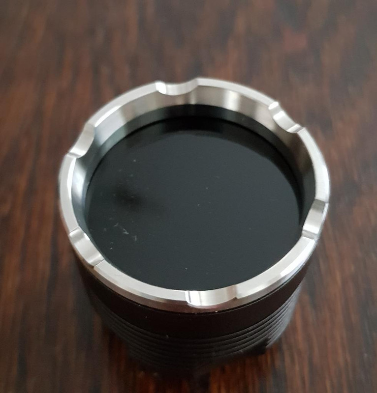

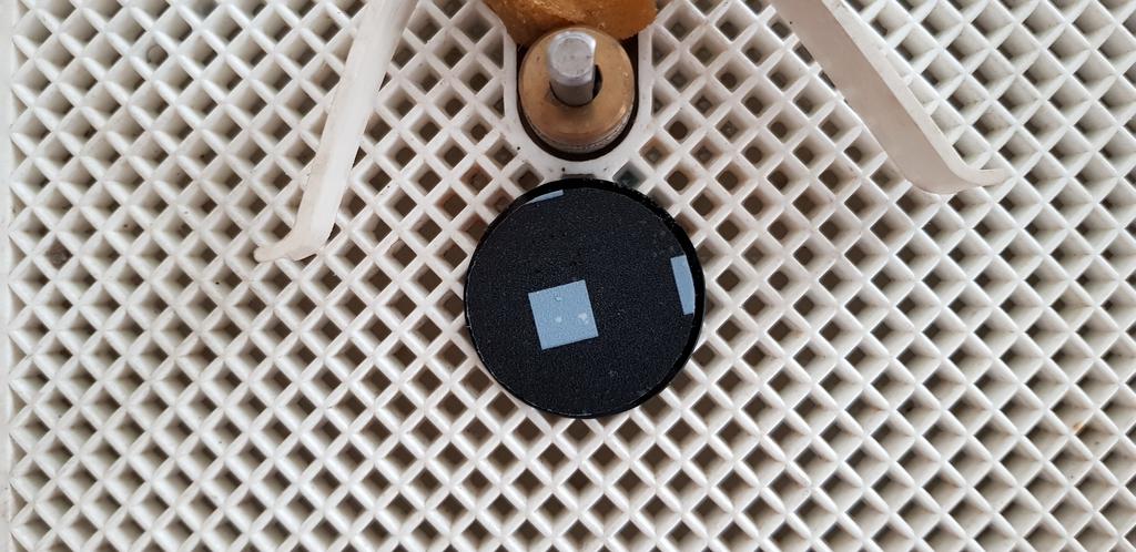

Today my Uv LED arrived (and a few really nice leds are on its way to me) so i wanted to work out a way to solder the LEDs to the MCPCB (My selfmade hotplate with modded PC Powersupply was damaged because of a broken waterpipe that flooded my workbench a few month back). But i had a few spare heating elements, my old Aluminium Block (i grinded it out of a Amplifier Cooler) and i could revive the temp controller. Using a car battery for the ~10Amps draw and my vise to hold it in place. The right side is cold enough to touch when the left side is above 200°C. Worked like a charm Temp set to 198°C (overshoot to only 203°C with hysterese set to 5°C) . Now i should get a new Powersupply and some kind of case to make it nice.

That’s awesome Docc! Really good work on improvisation, you’re all set to go into the re-flow business now! Big Smile

Grinded down the zwb2 filter and removed most of the rough machining marks (where the MCPCB is placed).
Today i reflow the UV led and then i have to wait for the driver.
