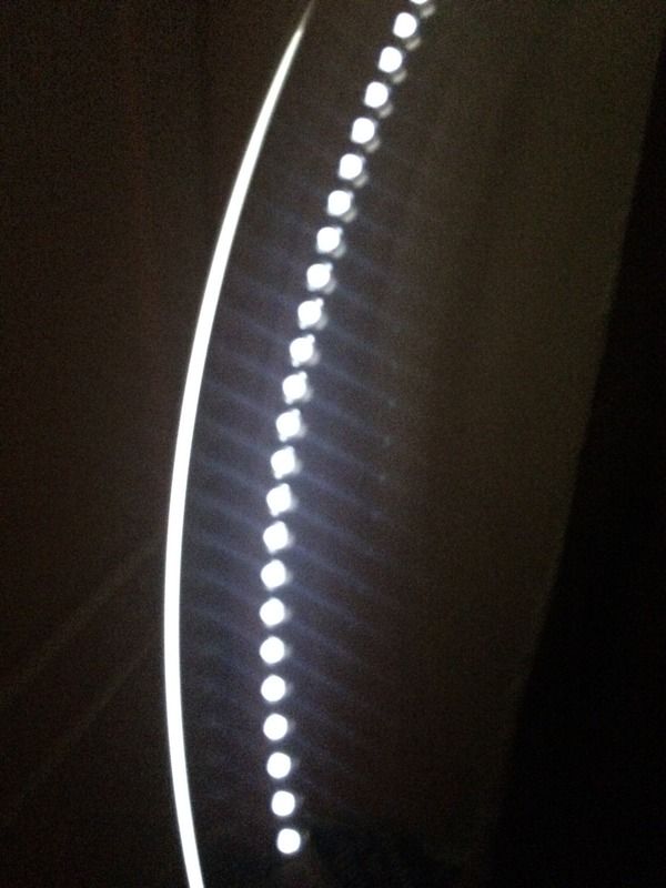

< begin Constant Current Circuit Noise Rant >
the E02, like the Lad, uses constant current, however, there is a current monitoring feedback loop that creates another type of fluctuation, that selfbuilt calls circuit noise. It can be detected in photos, but is very hard to detect by waving the light.
Here is the LAD dragons breath (constant current circuit noise):
LAD constant circuit noise:
Lad on Left, no PWM detected, Tube on right, yesPWM:
Tip, no PWM detected, this is constant current circuit noise:
this is an example of constant current circuit noise, a fluctuating current feedback loop, on a scope:
zebralights are also constant current w circuit noise:
also EagleTac:
Control Shot, Constant Current with NoPWM and No Circuit Noise:
< /end notPWM rant>

Not sure of all of the variables in the pictures above, as I don’t know what equipment was being used. I do know the picture of the oscope looks to be set at 0.002/division. If the gain of his setup is 1A/V, that would be 0.002A/div, or 2mA. Commentary here is my experience is the gain of most current probes is lower than 1A/V, but we will just leave that number for now.
Absolute worst case above is 2 divisions, or maybe 4mA. I have measured the current of all my lights. Ignoring moonlight mode, low mode for my E02 is 0.1 to 0.15A DC current. The current in the waveform above is a variation on top of the DC value (DC is “direct current”). So a 4mA, or 0.004, variation on 0.1 is 4%. Just referencing numbers above, the actual variation is likely smaller,perhaps much smaller.
4%, 2%, <1%, These numbers are too small for me to detect, but I am not super sensitive to PWM. I have actually not used a light yet (that I know of) that uses PWM. YMMV.
