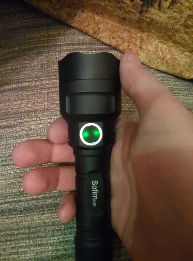

The original C8F from Sofirn had a tail clicky and no side switch, the new one has the side switch and no tail clicky, I’m sure it could be arranged to use a different tail cap to get a switch back there… Wink

I can confirm my Sofirn C8F WILL NOT work at all with the Convoy Clear C8 tail cap.
I can confirm my Sofirn C8F WILL work with the Convoy Clear C8 battery tube & tailcap.
