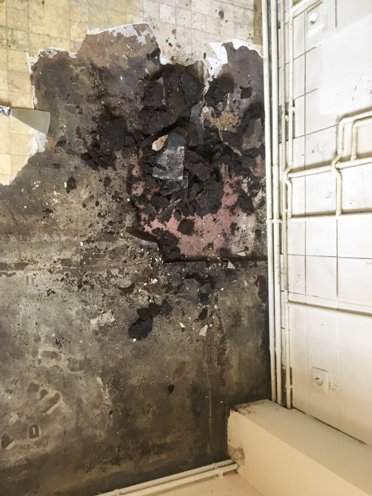

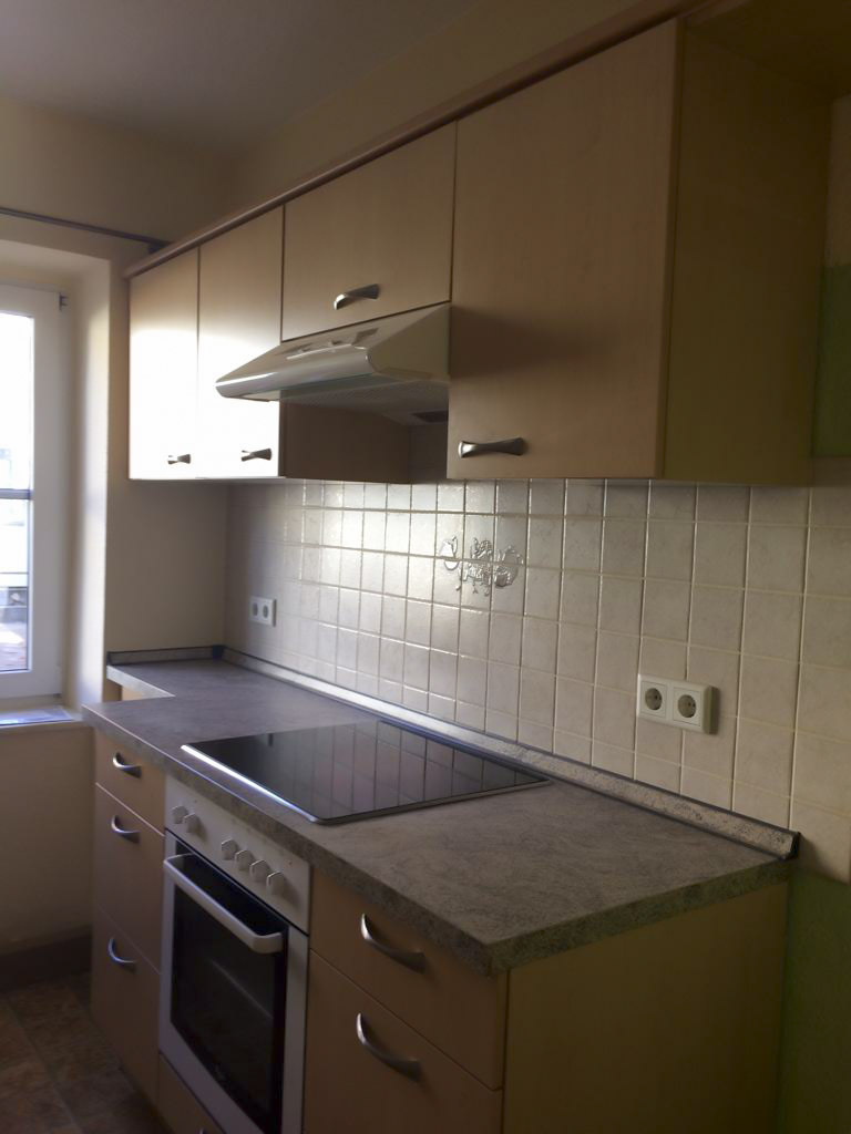

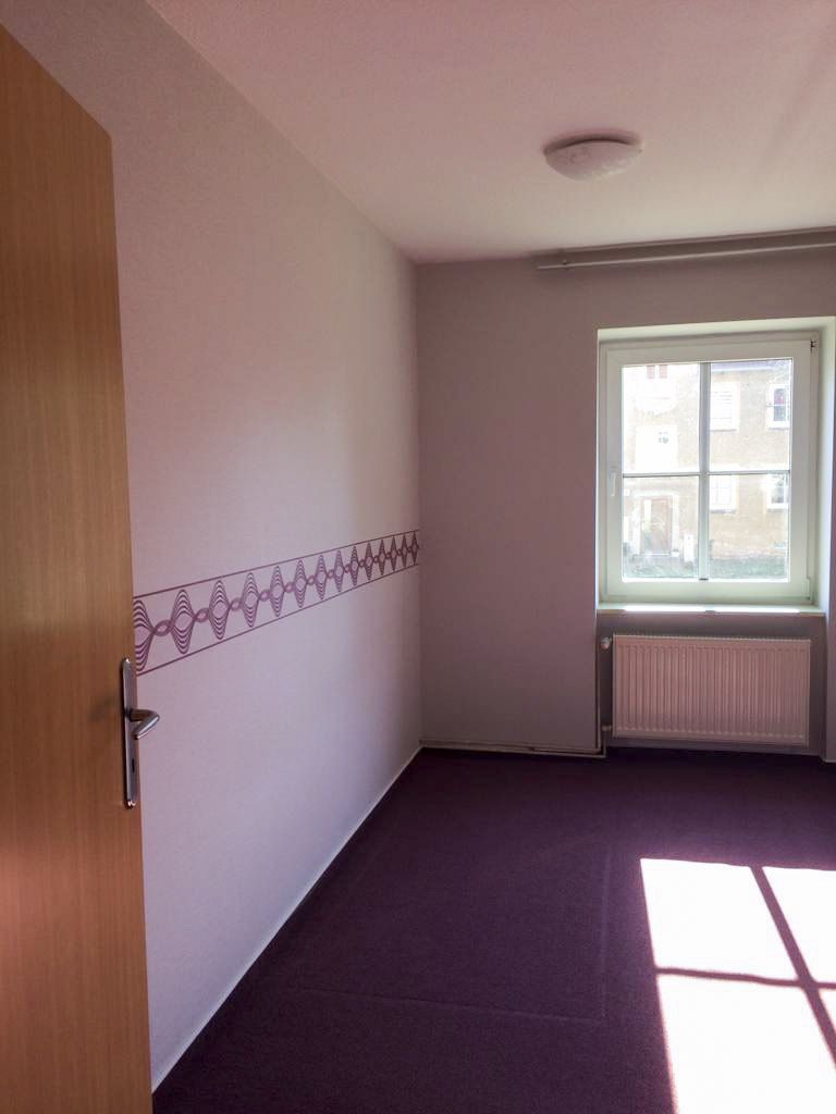

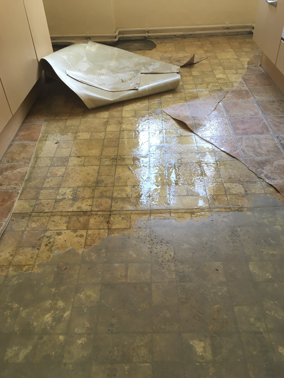

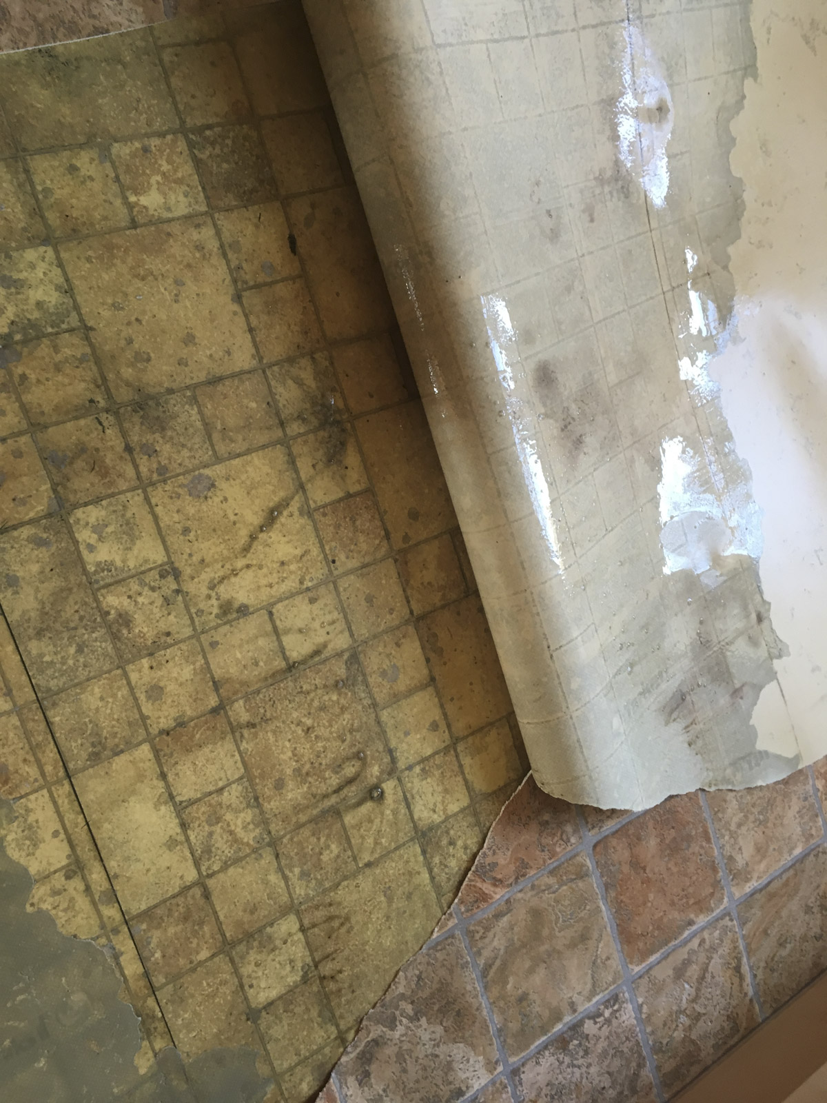

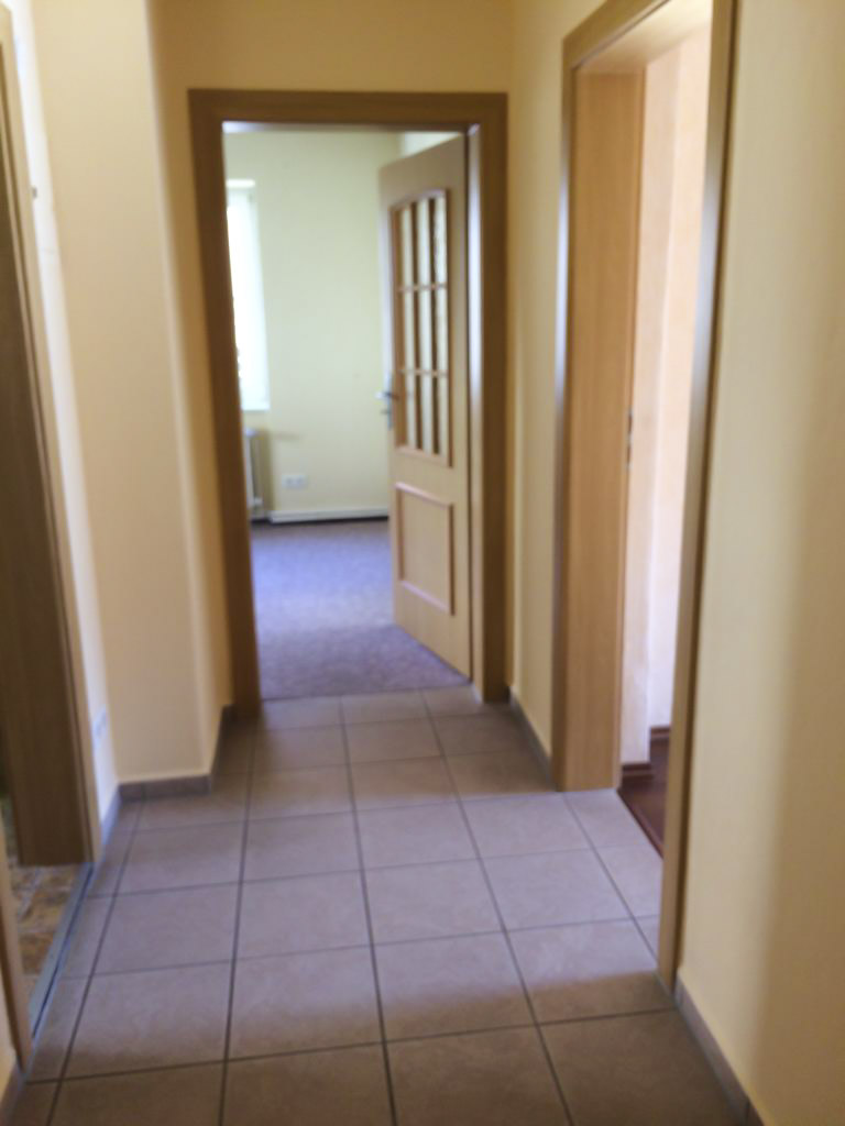

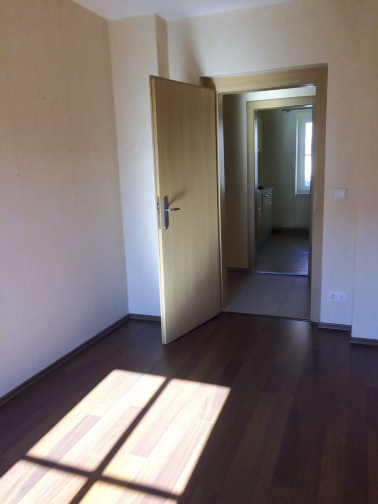

bought a new shiney apartment, started to pack a lot stuff to move there fully till 31. Nov,
so thought I got enough time to get a few things done
Looks OK 2 minor things on to do list

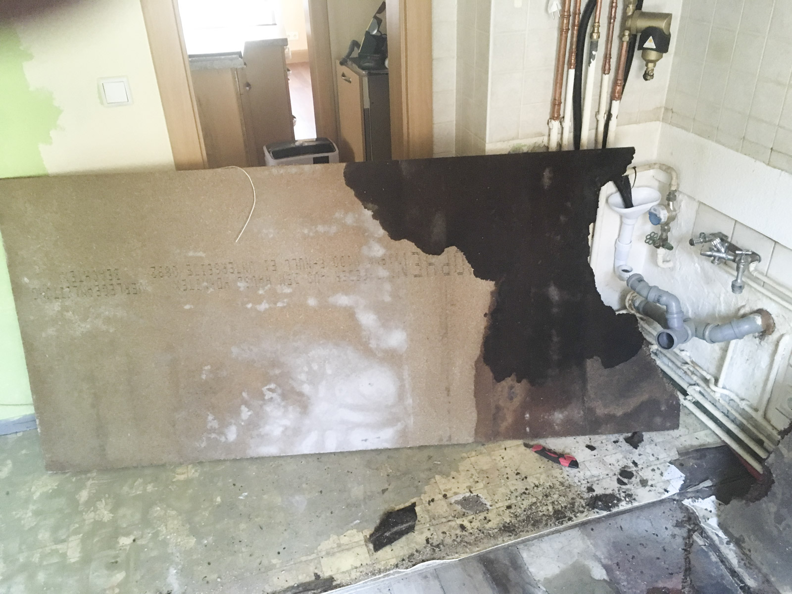

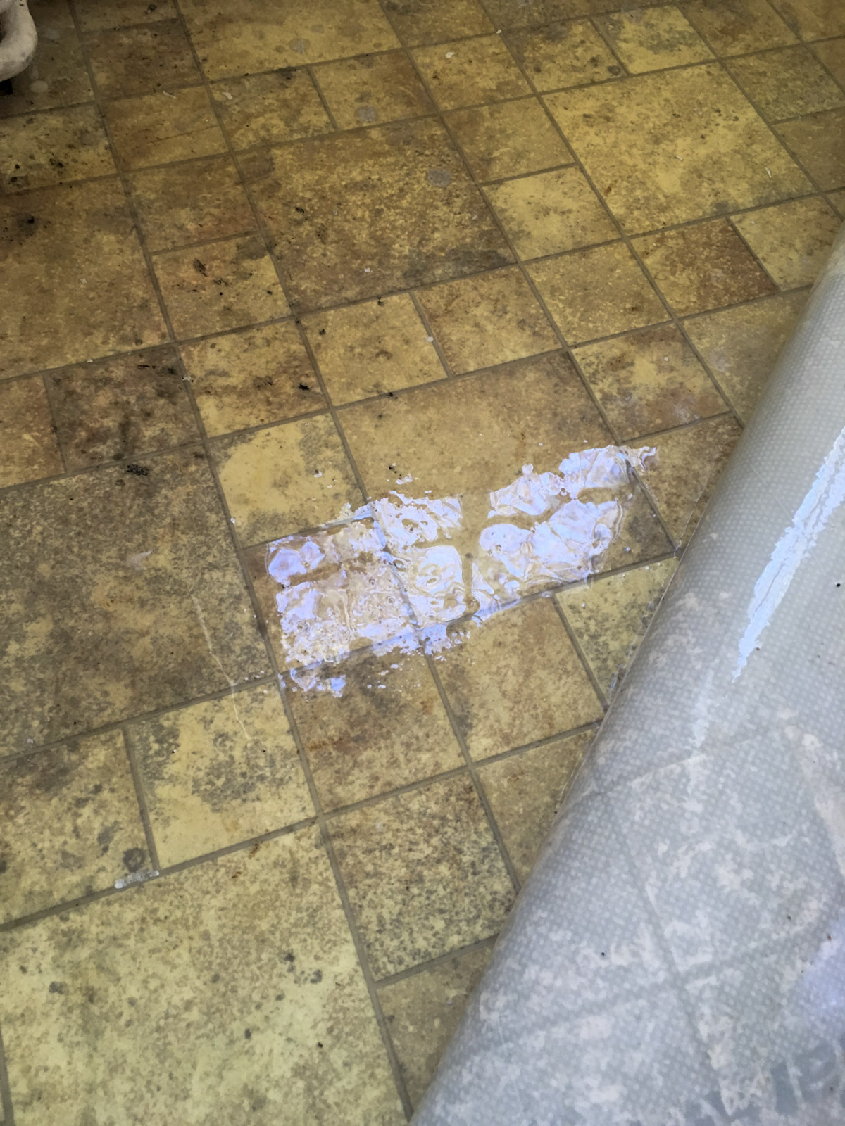

maybe someone did a bad move when disconnecting washing or dish machine or so as I discovered water
getting worse
removing the dish machine to get below the kitchen part
You know woods color right?

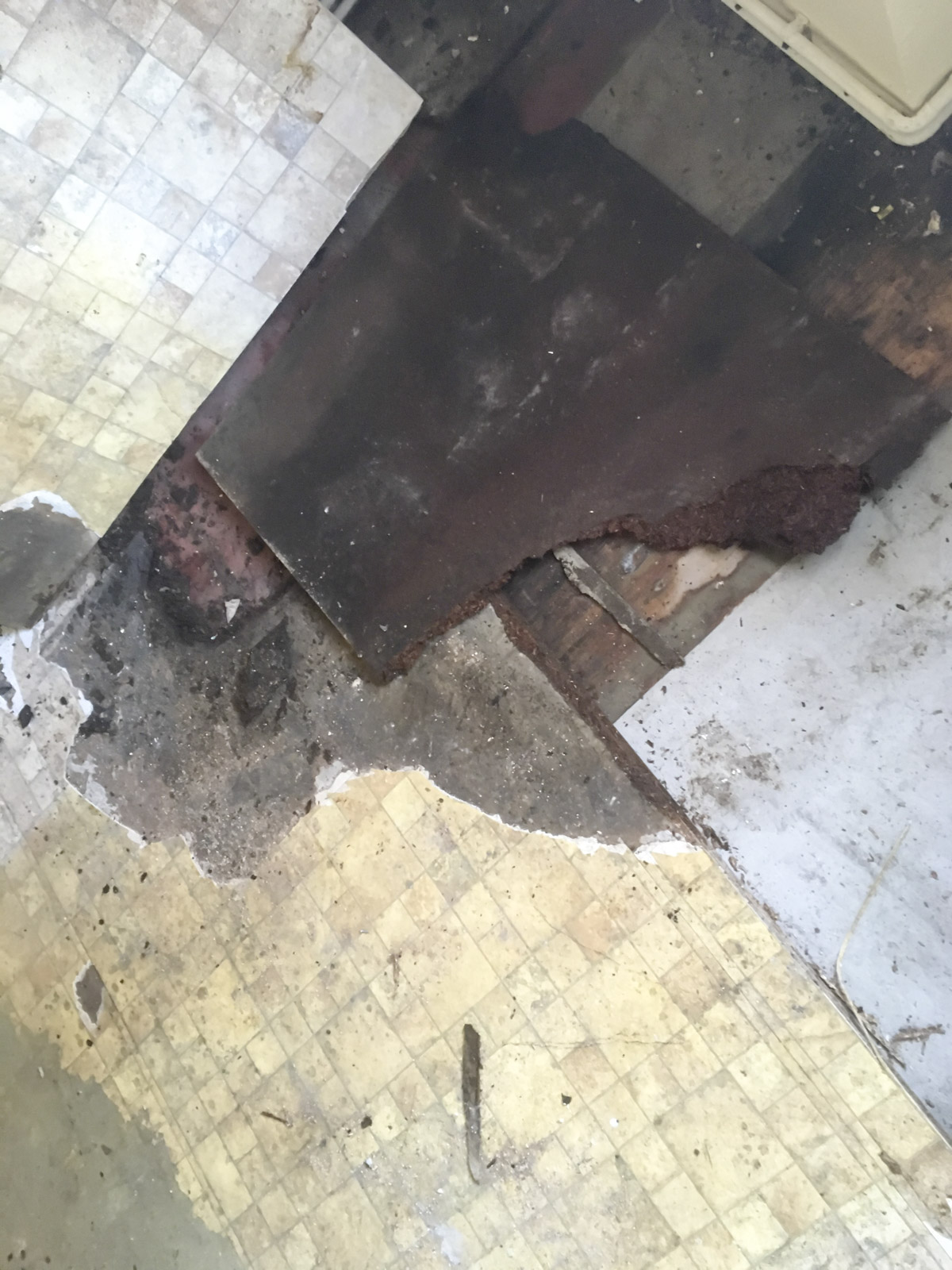

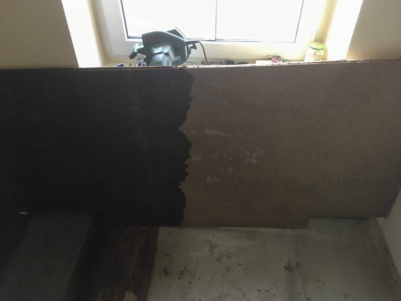

finally below the dish machine I found black stuff that turned out be have been wood a long time ago
had to remove kitchen for further investigation

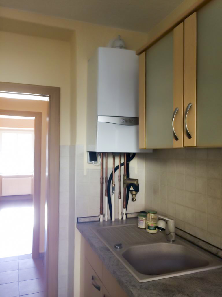

As I am not allowed as its house property not my apartment I had today first time a company here to replace the pipe

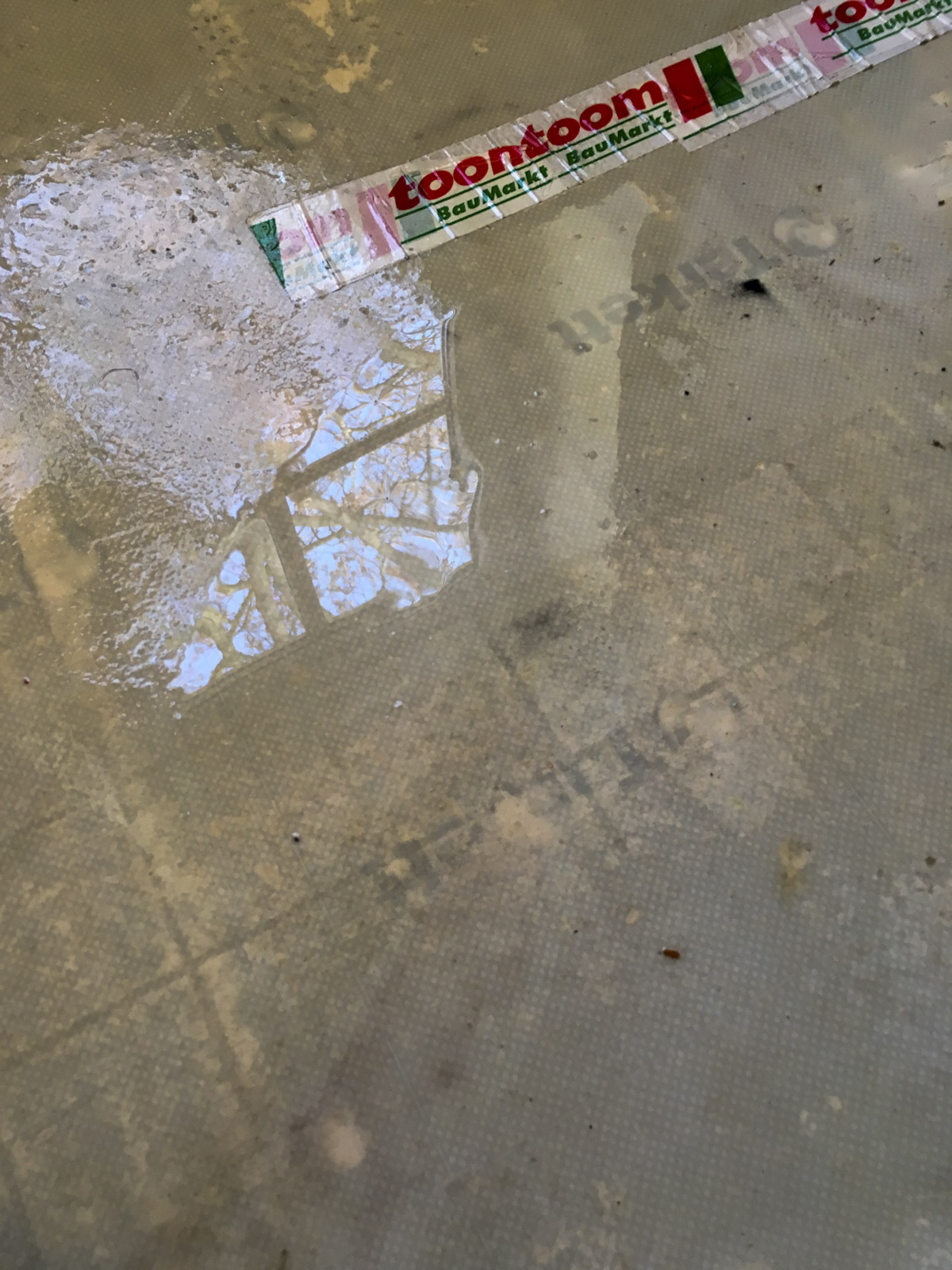

I finally got the permission to open the wall to get to the pipe before the workers come

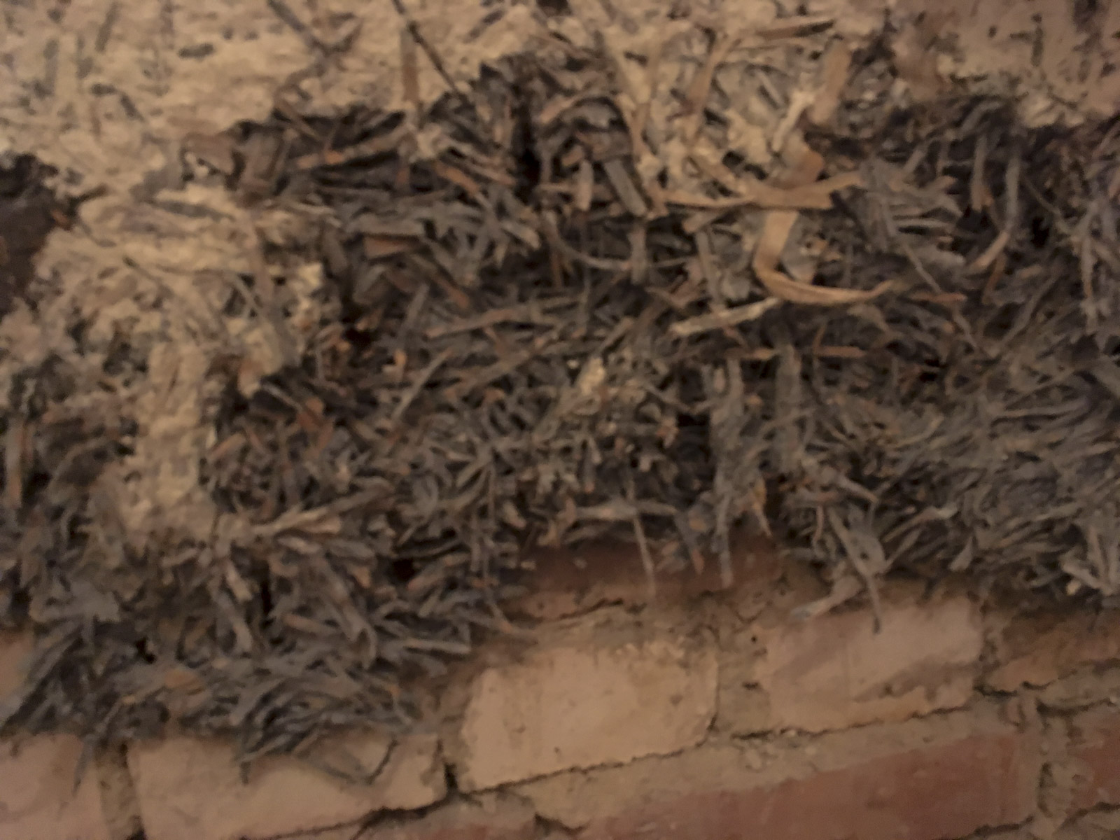

Today also more bad news opened the wall next to the pipe and below the plaster was wood plate, looks now more like mold than wood
so bought heavy breathing protection mask for toxic stuff and started to open all up and removing the mold,
a company would charge me way too much likely and would handle it like asbest stuff
the only mobile picture I made today
with good camara I made a lot today but forgot it there
Wow, that is bad. I think over here apartment renters can’t work on things, the building owners have to do all work. At least it does not cost the renter money to fix.
So do you have to pay for all the repair work?
Texas Ace Lumen Tube calibrated with Maukka lights
Hard to say pipe fix is definitely house insurance
Water damage on walls maybe
Not sure if the last owners insurance will pay for the floor its obviously an old water damage which leaked over many years a bit and now got worse
The problem was made 1995 when the heating pipes were made new, some idiot drilled through the wall into the pipe and they put some glue stuff on the ceramic pipe instead installing a new segment
Oh god! We bought our more than 50 years old house two years ago and every time we touch something we found that the previous owners wanted to keep every cent they can on any job. I can feel your pain!

I think I let speak pictures a bit, unfortunately only my phone camera I forgot there
getting worse
