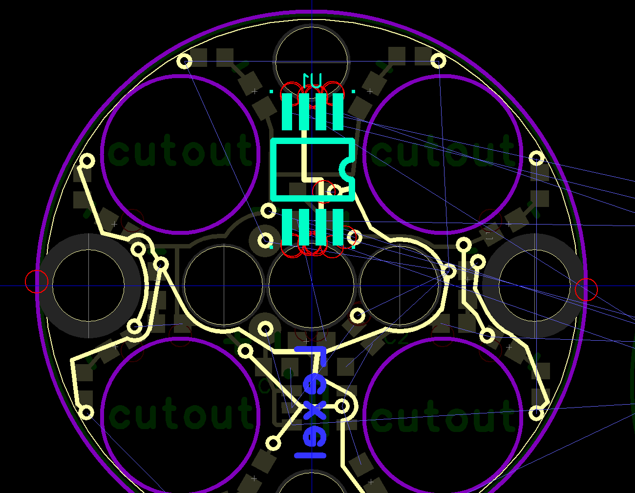

ZozzV6 wrote:
Lexel wrote:
I ordered Emisar D4 aux boards today
Lexel can you make an AUX board where half of the leds light above 3,5V and if voltage drobs below that it switch to the other branch and with different color I see what battery charge I have roughly without touching the light.
Basically I could add the Maxim chip that I am planning for my LVP Tail boards as well to the aux board, but there is like no chance to make it fit on the normal d4 for size reasons
It is planned to do a color change on low voltage and shut down at LVP
Problem is I am waiting on the first to be delivered even if I ordered them 4 weeks ago
so first I have to test the tail boards successfully and the basic aux boards
It would help to know the optics and MCPCB specs on the D4S

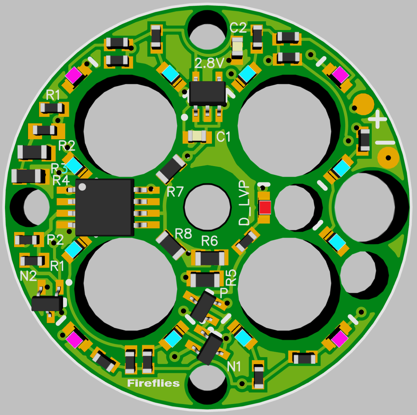

on a Fireflies light the low battery and LVP shut off fits barely on 2 layer from space and trace routes

Impressive work Lexel, I wasn’t too excited about all this but you make me want in! Smile
