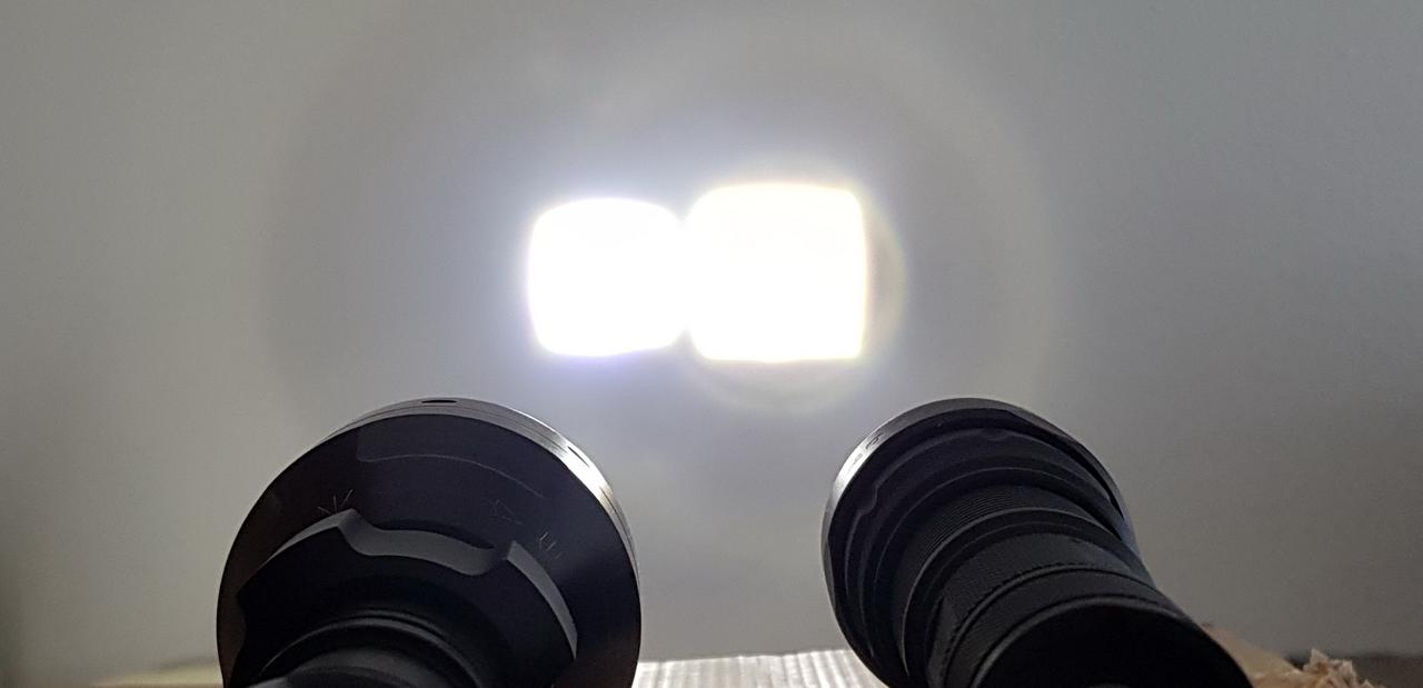

1504 on the left Cometa on the right 2,5m away from the wall (Cometa with led coverplate, 1504 without). Both lights with XPL-HI and both with DD Fet driver. But i really have to find a white wall that is 5-10m away (better to see the spot size difference). Picture is not as clear as i want but phone cam is having a hard time with the spots. In real the edges are much clearer.

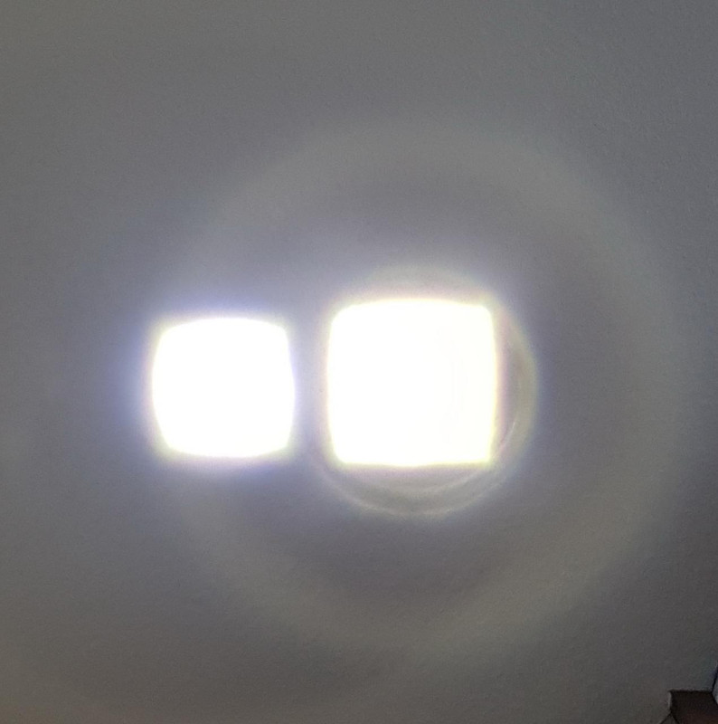

Look here, you can believe me or not but which is better one to you ?
I don’t have time for better shoot because I’m in big hurry, this is just for reference, but right one is without white plastic ring on led ( stock, how I got it ), and a left one is with white plastic ring on led like I post here :
With my eyes I see that better focused beam is this one with plastic ring than this one without it ! Also camera pick it up as you can see but I don’t have time in this moment for better shot I need to get to bed right away.
So don’t know it will this be in only my case or at the others, try then post results here. Led on my both samples was not perfectly centered just to mention.

Swap the plastic ring to the right one and see if you get the same results.
If not the left one is somewhere set up differently than the right one and thus doesn’t necessarily prove that the plastic ring will tend to work for all samples recently received out there.
Worth a shot for others to try the same experiment though. Couldn’t hurt.
