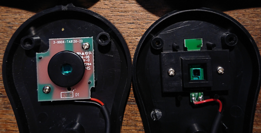

So I was very happy how the Tasi TA8132 of the test above performed, so I ordered the 'upgrade' TA8133 on Aliexpress: only 2 dollar more and in the lowest range it has a digit more in the read-out, it shows a tenth of a lux instead of just lux. I did not expect a more accurate sensor but I hoped for a stable enough read-out at the lowest range that the extra digit was meaningful.
It turned out different. I received a completely different luxmeter. It looks the same apart from the extra digit, but if you look closely, everything is different. And I do not know if this is specifically the TA8133 that is completely different from the TA8132, or that the whole TA813x series was overhauled at some point and that you may receive a 'new' TA8132 too if you are unlucky. Let's have a look at the outside:
"Good old" Tasi TA8132 on the left, "downgraded" Tasi TA8133 on the right
You may notice:
*slightly different colour of red
*red top on the left, black top on the right
*different colour LCD display
*more sloppy telephone wire on the right
*larger, slightly matted, and more opaque sensor diffusor on the left
*plastic texture of the sensor is bit different (can not be seen on pic)
This is all unimportant to me but it shows that they completely re-invented this luxmeter, nothing went untouched.
Now the inside of the sensors:
Sorry, reversed now, old TA8132 on the right now, new TA8133 on the left.
*the old type had a loose diffusor precision-aligned with some plastic posts, the new type diffusor is molten down (=not neccessarily worse, but cheaper to make)
*I received the new type TA8133 with something rattling inside the sensor, it appeared to be the optical filter that lived loose in the cavity yell. It was made press-fit into holes in the circuit board but to the wrongs specs: it had no grip at all when I pressed it back in place, I had to use cellotape to make it stay. After that the reading was completely off, I guess they calibrated it already without filter. The old type TA8132 has a screwed-down optical filter that will not go anywhere.
*the optical filter of the new type is not completely clear, and the sensor is heavily scratched (because of the loose filter going about?). the old type has a clear filter and fairly clean sensor
*the optical filter window of the new type is small and the sensor is well off-center, I fear for the cosinus-response of this luxmeter. The old type has a large window that will not influence the optical path to the diffusor.
*the sensors themselves are not the same type, they are of a different make (I did not remove the optical filter of the tested  TA8132 because I fear for altering the calibration, this luxmeter will still be used).
So with different optical lay-out, different diffusor, different optical filter and different sensors, in fact these are completely different luxmeters. I would have to test this TA8133 all over again to see if it is any good. And with everything looking less well done, I fear for less performance as well. But who knows...
Because I'm not sane and despite knowing better, I ordered one more TA8132 and one more TA8133 luxmeter, from different sources to see if these differences are consistent. They probably will dropship from the same source after all but who knows.
China is a weird country..

Thank you so much for  all the knowledge you share here !
The fun fact is that this thread pops up exactly while i was searching AE, BG etc for a cheap luxmeter after reading your previous tests and decided to have a go with the cheap integrating sphere Wink
I have access to a Konica-Minolta T-10A at my workplace and borrowed it once to do some quick comparison between whatever flashlight i had at hand but i would like to have something at home. I am not the "official" user for the T-10A and prefer not to over-work (not sure if this one is correct english) the permission i have for using it.
Edit : Holding my breath for your next update as i was about to hit the buy button for a TA8133 when i saw this thread

The TA8133 is exactly the luxmeter that I bought a few months later than the TA8132 from the test, and it came with a nasty surprise that I will show in the second post: apparently Tasi cheaped out and completely overhauled the TA813x series with by the looks of it inferior parts. If it is the TA8133 that is made cheaper than the TA8132, or that they swapped the whole series by cheaper versions, I don’t know.
Tasi has made some good products and now they are killing that little bit of reputation that they had (with me at least).

I got my second TA-8133 luxmeter in today (the type with the extra digit). From a different seller, frank hu’s store this time ( https://www.aliexpress.com/item/Handheld-Split-200-2000-20000-200000-LUX-RANG-digital-light-meter-photometer-brightness-meter-photometer-tester/32379016551.html?spm=a2g0s.9042311.0.0.558a4c4dRXGXDo )
My and most reader’s theory was that when developing the TA-8133 after they made the TA-8132 first, they did the downgrading too so all TA-8133 must be bad.
But no, that would make way too much sense, this is China so logic is completely absent: this copy is of the same build as the good quality TA-8132 that took part in the test of the OP. So it has the red top, neatly coiled telephone wire, matted and bigger sensor-diffuser, etc. So the downgrading is not type-related, you may even order a TA-8132 and get a bad one Sad
And it works well too, the calibration seems pretty close (looks even like within 0.5% for the warm high CRI light in the video (the Mobilux reads 3.4% low)) and reads right down to zero in a nice and stable way.
I did not tell it before but in contrast to this, the cheaped-out version has a faulty calibration (probably because the optical filter was already loose while calibrating), but worse: it stops reading below 24 lux, everything below that is zero. Pretty useful that extra digit Facepalm

They are both 8133!! The left one is the latest one that I got in the mail today, the right one is the one dissected in the second post.
Oooh I see! My bad I got confused, thought you were comparing the new 8133 to the 8132 we knew was good.
So maybe that crappy 8133 you got was just a really old production version or something, some retailers have stock that is many years old.
I would like to assume that they improved the production quality rather than made it worse.
So that means there’s a chance of getting an old crappy unit of both 8133 or 8132 depending on where you buy from.
At least it’s easy to tell which meter is good or bad simply from the appearance Smile

I just checked the sensor of my latest (“good”) 8133 and it looks almost like the “good” 8132, but the rim of the sensor is different, so yet a different version, although in details. Would this different sensor be related to the better resolution at low light? Nah, that would sound like reason, they probably use whatever component is available at the time of production, sometimes this one, sometimes another. Big Smile
