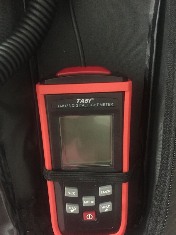

I can confirm I received a “bad” black top TA8133 inside the packaging for a good one from this seller. It seemed to be working reasonably well during informal tests, but my calibrated BLF-348 read extremely low. I did some further testing and discovered under about 60 lux (from my known “good” HS1010A) the reading is fixed at about 19.6 lux. Seriously Facepalm Above 85 lux it becomes reasonably linear with the HS1010A, but continues to rise. It can also be exceedingly slow to settle on a measurement.

I just got my 8132, it turns out to be a “red top”, but weirdly enough the red color of the top (and the power button) is more of a darker deep red compared the the body’s red. The display looks like the less green one in the “good old” 8132 in #2. I don’t have any other tools that can be used to verify the accuracy of this meter, I guess I can only hope that it’s accurate… Glasses

What you can do is to see if it displays 0 lux with some light, mine started to display more than 0 only around 65 lux wich is enough to read a book.

The bad luxmeter had several problems :
  • reading 0 until 60-70 lux and seemingly non linear reading after that
  • wrong response curve (the difference between a good luxmeter and the bad one was different depending on the light "color")
According to what the seller told me Tasi was admitting that there was something wrong with a whole batch (first batch new design ?) but that they were going to solve it.
0 and non linear readings should be easy to solve for Tasi (programming parameters) but i doubt then can change the response curve without replacing the filter and/or sensor.
Maybe yours is from the "new fixed" ones. That would good news but we still have to see if the response curve is  correct

It is red top, thusfar it seems those should be good.
Tasi’s story of a bad batch is complete crap, those blacktops have dozen’s of design changes for the worse, that is not a mistake, that is intent. The next batch will not have all that reversed because someone on BLF found out what they did. They cheaped the design and then make up a story.

They changed the sensor and filter and did not change the calibration accordingly : that was big a mistake (they call it bad batch) but that one should easily be solved as long as the calibration parameters can be reprogramed
I agree that it won't solve everything but at least it should make the new 8133 as usable as any cheap luxmeter (while the old was pretty good)
