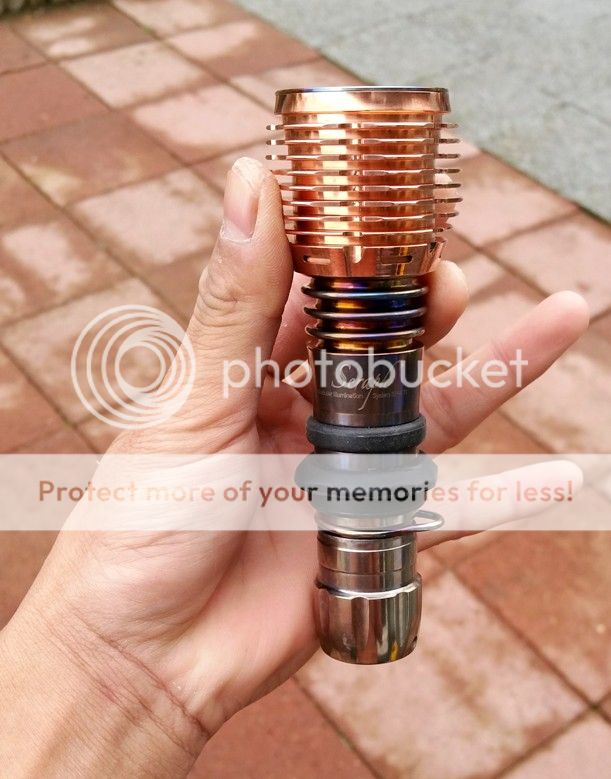

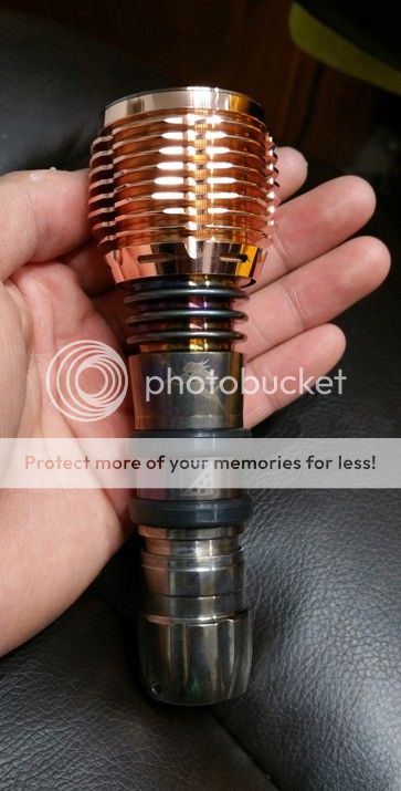

FWIW, while the Trustfire TR-J20 has the LOOK, it doesn’t have the heart. Those precious fins aren’t connected to the emitter shelf in such a way that actually transfers the heat. It’s fixable, and I machined a heat sink for two of them that works quite well, but of course it adds weight, quite a lot. But then, neither of the two I machined the sinks for were concerned with a mere 10,000 lumens…
Point being, the machined fins look good but they have to be interconnected to the thermal path to actually work. This is why the Eagle Eye X6 is one of my favorite lights and I’ve built dozens of them, in a staggering array of options.
The copper head on an X6 would be ideal with Ti battery tube and bezel. Just saying… (another FWIW, my Reylight Ti X6 is making over 10,000 lumens in triple XHP-50.2 configuration) This is not just a plug for Titanium, I love the stuff for valid reasons… light weight and strength being the obvious but the Ti actually has such low thermal conductivity that it almost acts like an insulator, protecting the cell from heating up when using, oh, say 7 Nichia 219C’s. Wink
Now, all that said, I really don’t see why this E07 is being configured with 7 emitters. Seems far too much for the size of the light and the size of the accompanying cell. I DO like the style, quite a lot actually, but 7 emitters? Looking forward to seeing some actual photo’s of proto’s and samples.
Watching…
Edit: Oh, and one more FWIW… the Stainless/Cu X6 and it’s little brother the Cu X5 had much deeper fins in the prototypes than in the production units. The proto’s were great, the production lights were disappointing.
Watching…
“Mere 10,000 lumens”??? How many lumens were you outputting?
Personally I’m not a big fan of titanium unless it’s for AA/14500 lights because as you said, it is basically a thermal insulator. But at least TI is better than SS, which has poor conductivity and heavy. Copper combined with aluminum seems to be the best in terms of price and performance.
Any idea why they couldn’t retain the deeper fins in the final X6 and X5?

Mildlyangryjohnny wrote:
Not that exact tr20 thingy— that looks like a ginormous 26650 thrower. But borrow some of the millwork concept, thin fins 1/16(1.6mm) or so thick, spaced the same on a ~1.5+ inch head they couldnt be very deep maybe 3/16”, or so. Yeah, and do it in copper. There was an astrolux i remember seeing a few years back— sc ? Maybe a bit like that form factor wise but slightly deeper on the fin milling. But narrow 1/16” fins and spacing. This, as opposed to the e07 cad drawing with 3 fins at approx 3/16 – 1/4” thick.
I think this is what you’re looking for. That’s the best finning I’ve seen for a light of that size and it’s actually done in copper.

That C8TT is nice too. I have it and it looks better in person.
Wow!! What is this treasure called? Where is it for sale?
Sorry for my poor english.
