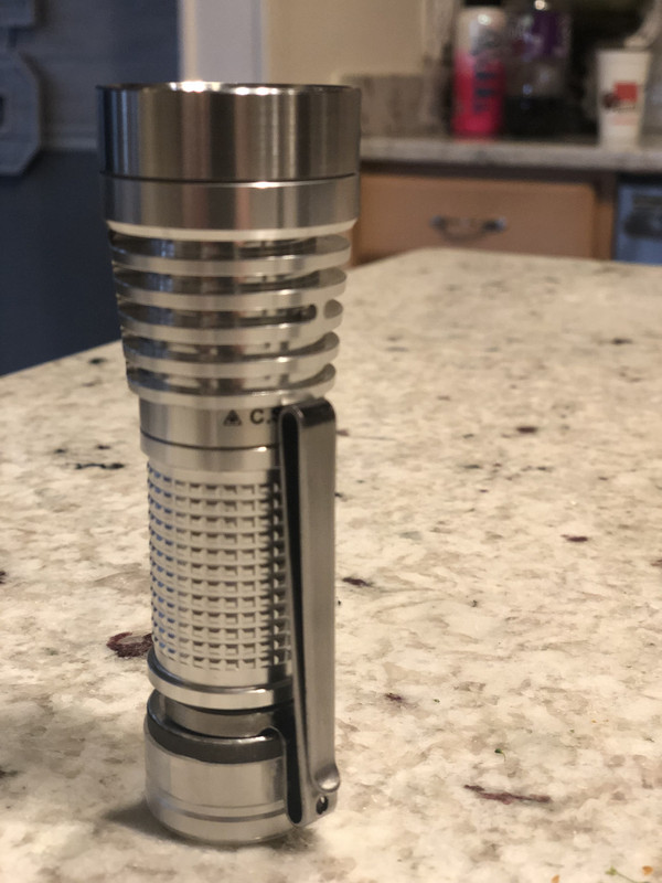

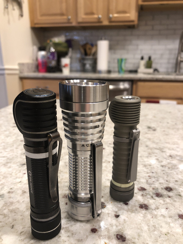

Black paint removed from h2r nova clip to use on E07. Much better! Ordered a silver Olight S1R/S2R 2 way clip but it’s much shorter, so I did some pocket clip swapping around today. Zebralight clip went to the h2r, new Olight clip went on my old zebra h600w, and the h2r clip was sanded and put on the E07. Still have some polishing and clear coating but it looks good and much better than original clip Thumbs Up

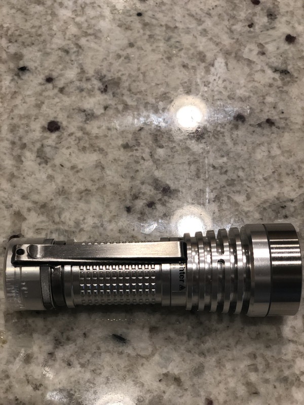

That looks like it would be very difficult to clip onto anything in a bezel-down orientation for deep carry. The lip of the clip, where fabric should slide under, seems to be blocked by the smallest heat fin. Is it as difficult to use as it appears?

It works better than the clip it came with bezel down cause the original clip was so tight I had to struggle with it to slide over anything. The Olight clip, being longer, is easier to lift and slide into my pocket bezel down. But because the head of this light is bigger than the battery tube I MUCH prefer bezel up. It makes it much easier to pull out and return to pocket without fighting getting past the larger bezel. Plus I get to look down anytime and see those cool aux lights and see the light is not on. Others notice it also and inquire about it. Pretty cool:) I remember one time my Olight h2r turned on in my pocket and scorched my leg and burned a hole in my pants Facepalm . That’s the day I started doing mechanical lockout on that guy Big Smile This also solves that issue. Don’t get me wrong, I’m still dreaming of this design, but haven’t found or tried making it, yet……
