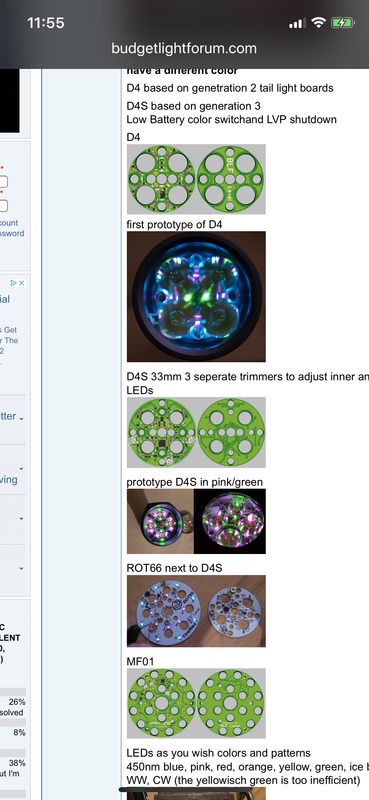

Does anyone know of a way to get just an aux emitter board, of say, yellow/ red aux LEDs? Is that something Neal would be able to sell (since he seems to be the only person with alternate options, but I’m also sorta assuming that’s just all pre-stocked…..
Thanks Smile

Neal told me he was just getting his lights from fireflies directly. I did see a post somewhere here for aux tir boards.

Thanks Firemedic, I’ll keep hunting!

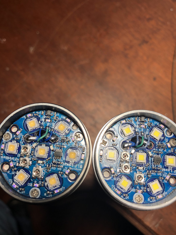

Following in the footsteps of others, I’ve swapped emitters to LH351D 5000K W6. This is easily one of my favorites now and have to agree that moonlight looks delicious!
(This is a little blown out, but a good representation of the wall of light the LH315D | 30T combo produces)

Cool mod… where is the best place to get those LH351D 5000K W6?
DB Custom
DB Custom's picture
Offline
Last seen: 1 hour 25 min ago
Joined: 01/13/2013 - 22:28
Posts: 20568
Location: Heart of Texas
I actually like the 70 CRI 5000K W6 better than the 80 CRI 5000K U6, just seems whiter to me and that’s what I like. AAAND, more powerful. Big Smile
DigiKey has had them, not sure if they still do… pretty cheap as well. Wink (they show some 720 in stock as of a few seconds ago)

Dale, you were the inspiration behind this swap, so thanks for showing me the light. Big Smile
I got 35 of them from DigiKey recently.
