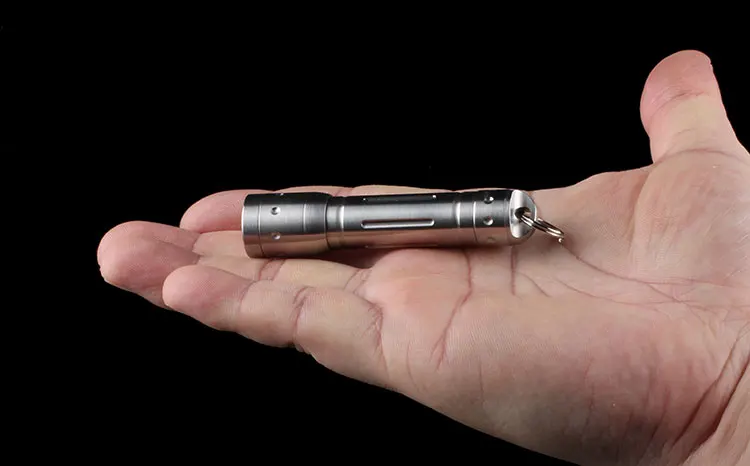

I see that a Rofis Store on Ali offers an AAA flashlight that they say is from Convoy.
It is SS and somewhat resembles the Convoy Ti prototypes, especially wrt overall shape and size. Actually looks better to me.
https://www.aliexpress.com/item/32811288894.html
Is that actually a Convoy?
I thought there were issues with the driver?
highzlik
Offline
Last seen: 9 hours 57 min ago
Joined: 06/02/2019 - 18:18
Posts: 6
Location: Czech Republic
It is. You can found it also in Simon’s shop.
https://s.click.aliexpress.com/e/FxxmEd5I

Untracked link:
https://www.aliexpress.com/item/32730506517.html
Now it opens a number of questions. Smile
  • Will there be a Titanium variant?
  • Diameter?
  • Does it accept 10440?
  • Will it be available as a host?
  • What is the driver diameter?
  • Will the driver be sold separately?

I don’t think so, the light is on Simon’s Convoy store for over 2,5 years, i have never seen replacement parts for that particular light, but you can always ask Simon.
