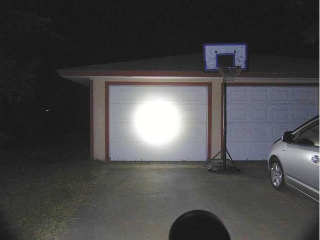

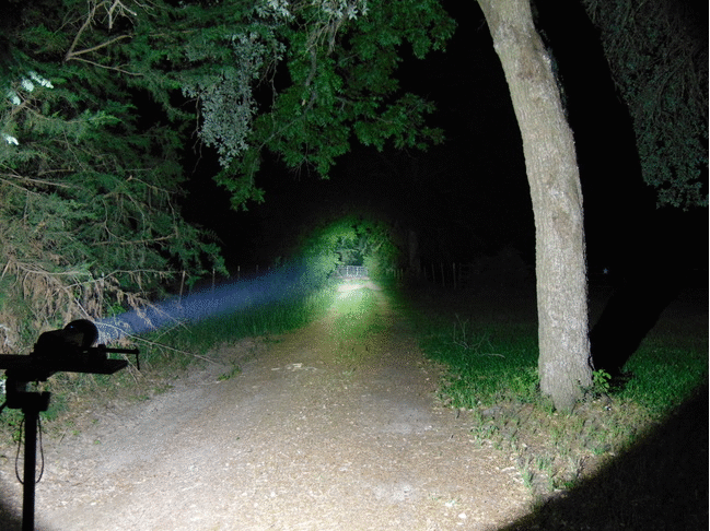

Actually it should be easily noticeable when you go from High to Turbo as the below GIF’s show.
22 feet from Garage door
100 yards from Gate
