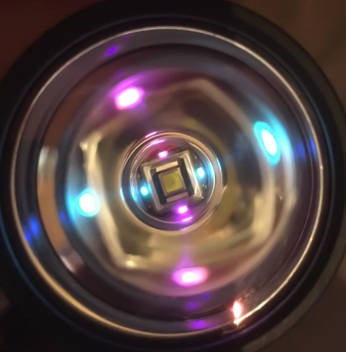

Aha! So it does actually have to do with the emitter itself, "cross" or no "cross" regardless - nothing a small piece of sandpaper couldn't handle Wink Just carefully sanded the whole surface of the dome and.. Voila!
Well, idk how much luminance I might've lost, if any, but at least the blueish dot is completely gone! That and a perfectly smooth corona - as in rotating the flashlight you wouldn't notice the beam rotating on the wall.
I guess this method, (new to me) if not wasting any luminance (I would imagine not.. ) might be a better alternative to using a "DC-Fix", as it's not messing up with the optics, but just the emitter surface area.. ?
Really don't know how to use this phone's camera for some decent results if even possible, but this is the best I could do for now.. also, this time, the beam actually looks better in person and also no banding.
That's only the corona and the hotspot, the spill is not visible at this level (Low - 50LM) against the ceiling lamp (had to keep it near a similarly bright light source, because of my phone's camera narrow levels range.. )
Also there seems to be a heavy magenta tinge overall (judging by the ceiling, which it's quite white.. ) and the tint shift in the corona it's exaggerated towards a light teal, when in fact it's more like a creamy yellow and less pronounced.. The tint shift in the corona seems to be a bit washed out compared to the original, before sanding the dome, that must be just a side effect of the whole emitter surface area being better "blended", with no sharp contrast and defined shapes, basically, just your "average Gaussian blur" effect.
Tried my best to take some pics of the emitter at the lowest set ML mode (should be 1LM according to specs.. )
Wish I'd had a small fine sandblaster.. ^^ Or maybe is the dome getting foggy if wiped with Acetone.. ?? Like some plastics are.. ? I'd imagine not Flat Stare
