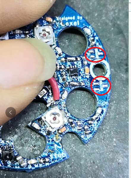

I had to make fast prototypes ordering boards in Germany now
After some problems with the Astrolux driver maker who did not manage to solder the Aux board prototypes with a soldering iron Facepalm
this is a really ugly looking soldering job, flux everywhere and on top he forgot to solder some parts

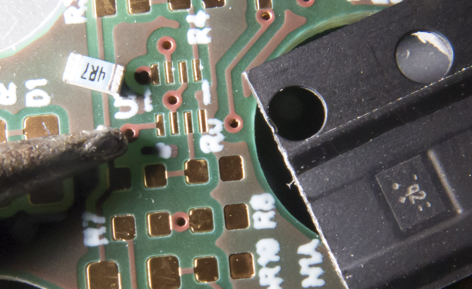

here I made a simply size comparism between a 0603 resistor, a fine solder tip and the new footprint comparator
no wonder with the tiny components on the Aux board the driver maker messed it up

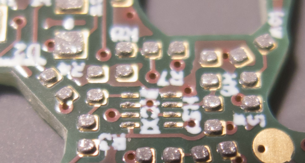

Solder paste Macro, I also changed the solder paste shrink so bit more paste sticks to the pads in production
parts carefully placed with very fine tweezers

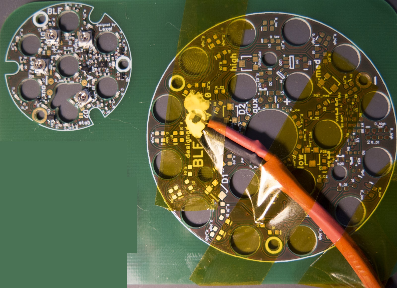

also had a MF01S Aux board there but Mouser let me down the delivery moved from friday to monday, while the PCB fab delivered thursday instead monday
I put a PTC on it as the darker color likely heats up different than my usual white boards and indeed it was a lot hotter than the reflow oven dummy boards

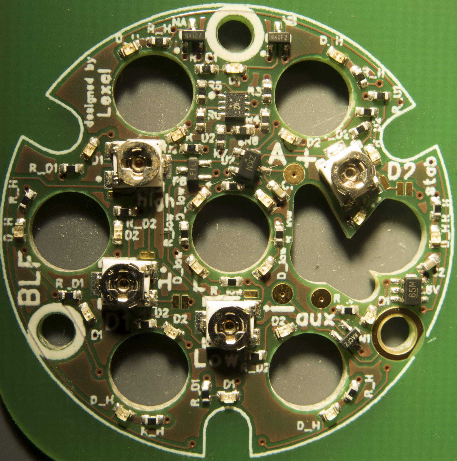

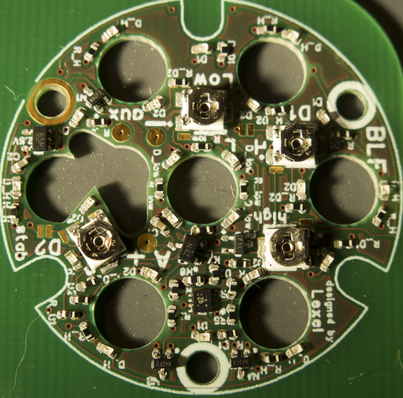

after reflow
Piggyback 0402 cap to fix voltage break downs after the MAX809 or before the LDO, not sure which one of the 2 parts caused this to happen
here the lower board is fixed, the other still have the strange behavior and power breakdown
also can be seen the much smaller footprint NCX2220 comparator
this was choosen as its cheaper than the Maxim or Microchip ones in Umax 8 footprint and also saves space on the boards which are very dense already
