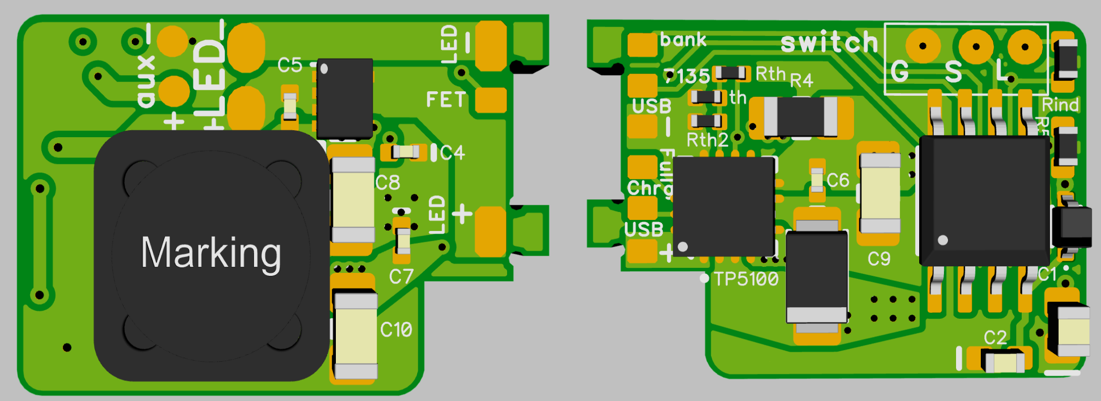

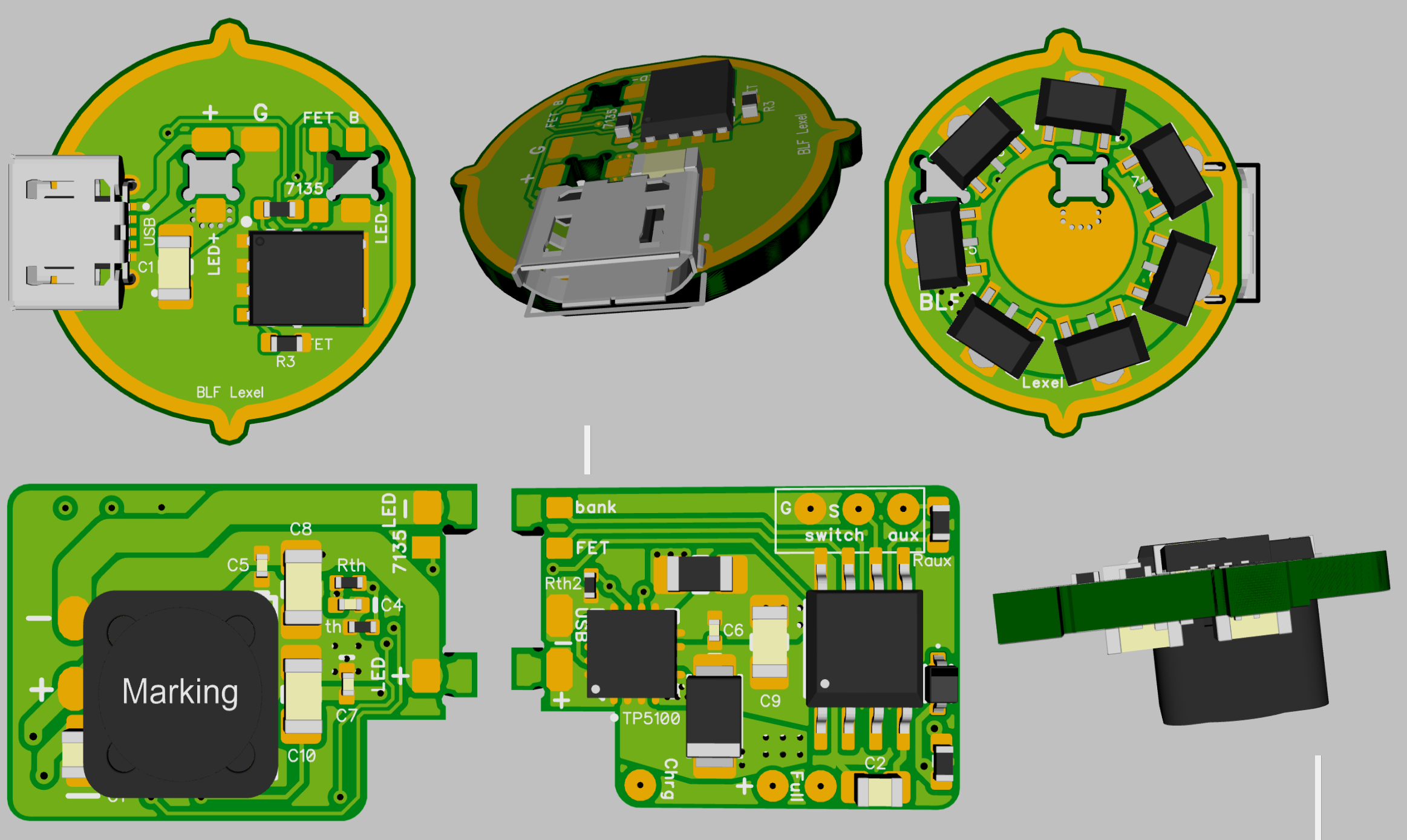

If someone wants to know All PCBs and MCPCB design is made by me
Early in the design process without charging added
First planned USB Micro, but later type C was requested
Almost finished charging board
Final driver design may look a bit odd on the AMC side but it’s a matter of like 0.2mm if it fits somehow or not

Hi Lexel. I am little curious which is that 3D software with PCB in that you can get 3D measurements? Is that Diptrace, which I think that you use for your PCB designs?
Dr.Phillip wrote:
Have you done any tests Lexel? How fast will the light throttle down from different ramp levels? Are the AMCs well thermally connected to the flashlight body?
From posted images and from video of vietnamreviews I can see there is very good thermal path. Also the flashlight body have thick walls and it is massive compared to another L shape based flashlights which is very good. From that design I think is possible to drive SST20 at full power for very long time. But we will need real test for that.
In that PCB design I do not like that PCB joints where are connected two pcbs. The main current flow will passes through solder joint which is only of one side of PCB. There are I think will have a little problem with mechanical stress betwen two PCBs.
