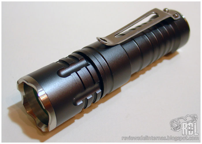

I wonder what colour will come after if I cook the FF S3:
