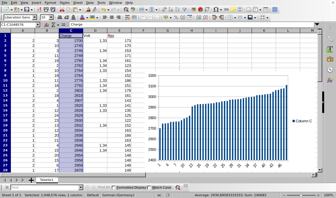

The other day, I've run an analysis session for all my 48 Laddas and manually copied the charging capacity into a spreadsheet (and resistance), to see what would be a good threshold for worn out Laddas and mark them as "mid-aged". I've used 300mA to keep everything not too warm. My Laddas have been on duty very randomly are a few years old and have not passed many charging cycles. They have been charged not over 700mA, mostly 500mA or so. (Slow charging keeps your NiMh fit.) Therefore I expected some quite different values. I've sorted the data in an ascending way and made a graph. Great, somewhere around 2800mAh seem to indicate aged or untrained units:

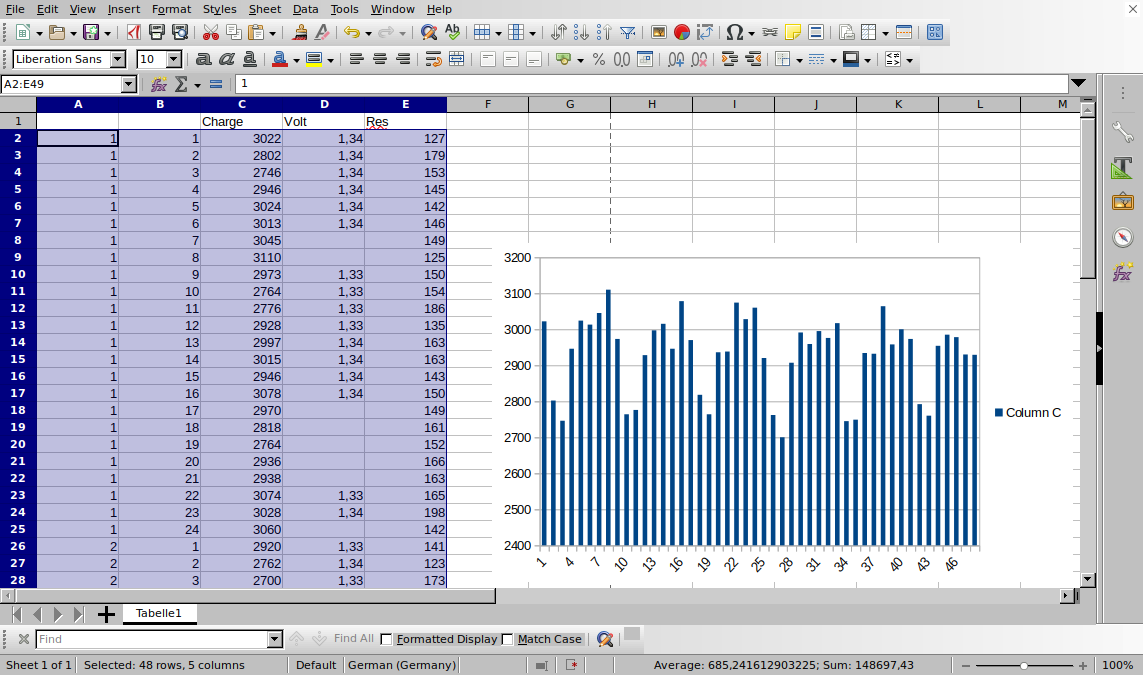

...Until, I've sorted the data back to the position in the charger. Wait, what???
There is an unexpected pattern, that matches the six blocks of eight bays architecture of the two N24 chargers. Probably, heat distribution distorts the measurement significantly. My conclusion is, that this thing is not really useful for analysing batteries, at least, not fully loaded and I need to analyse with my 4 bay Maha C9000.
