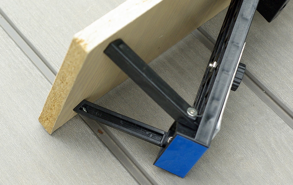

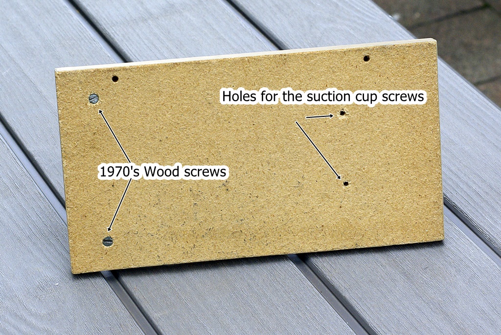

I plan on affixing this one to a board ..
Remove the rubber feet / cups .. Make some holes in the board to match , and glue it down .
Should improve things a lot ..
I have another sharpener kit that came the same day , it clamps the knife blade . Should be much better for profiling an edge . Also ordered some diamond sharpeners that fit the guide rod . For heavy duty work . The included stones do the job for edge maintenance . Now if only I could find some ceramic sharpeners that would fit that guide rod . I do like my ceramic sharpening rods .

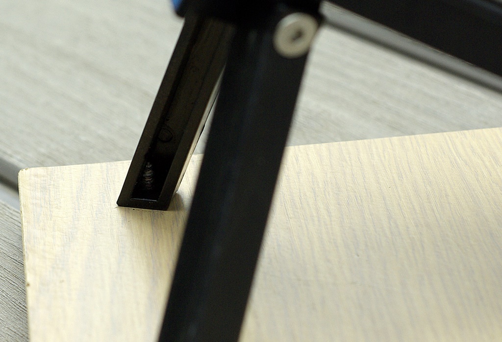

I put a base on the guided sharpener . No glue needed . There is enough tension from the rear screw to front to avoid glue . Front wood screws hold the legs and the rear screws that held the suction cups were simply pushed into the drilled holes . And hopefully will work now with little to no muss or fuss !
