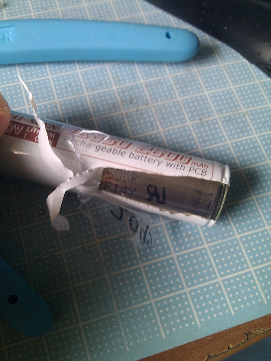

I talked with Shane at The Pro-Tactical Shop and he is going to peel the wrapper back on some and check them but he won’t be able to do that until tonight around 6pm or 7pm.
Here are pictures of the HI-MAX that I got from Shane. He just sent me these.

Well, its a question does he has same batch as pingyi.

Ecig wrote:
Well, its a question does he have same batch as pingyi.
That’s where he orders his from.
What I am suspecting is that maybe the factory employees do a switcheroo on some of their cells, so perhaps for some of them they put in the good “Himax” cells we’ve come to know and love, and for others they swop in some old lappie cell.
At least that’s the impression I got from the email reply.

I just did it for one, seems like it is quite unlike anything I’ve seen, apparently there is no other layer of shrinkwrap inside and the printing is on the cell itself:
And this one’s a Sony.
I’ll try to find one with the Sanyo. Just as a disclaimer though, I didn’t see the “MEHM4CA” through the shrinkwrapping, but what gave it away for me was seeing some of the distinctive “D” symbol that is normally on the Sanyo cells.
A comparison with a “real” Sony:
Pardon the gross mouse! Now I better go wipe it with some detergent!

Better res picture

Figured I can get adventurous with the two particularly crap cells too:
