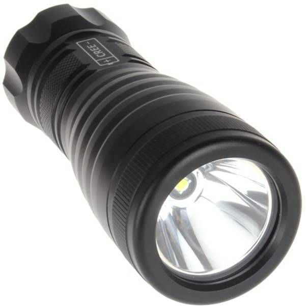

LED:  (1) Cree XM-L T6 with smooth (SMO) reflector
Lumens:  500 (FL1 standard cf. link)

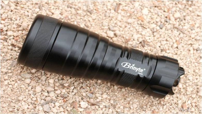

This is a short and stocky dive light.  Length is about 5 inches, with a 2 inch bezel width.   Turns on by a simple twist of the head.   Has only one mode (Hi).

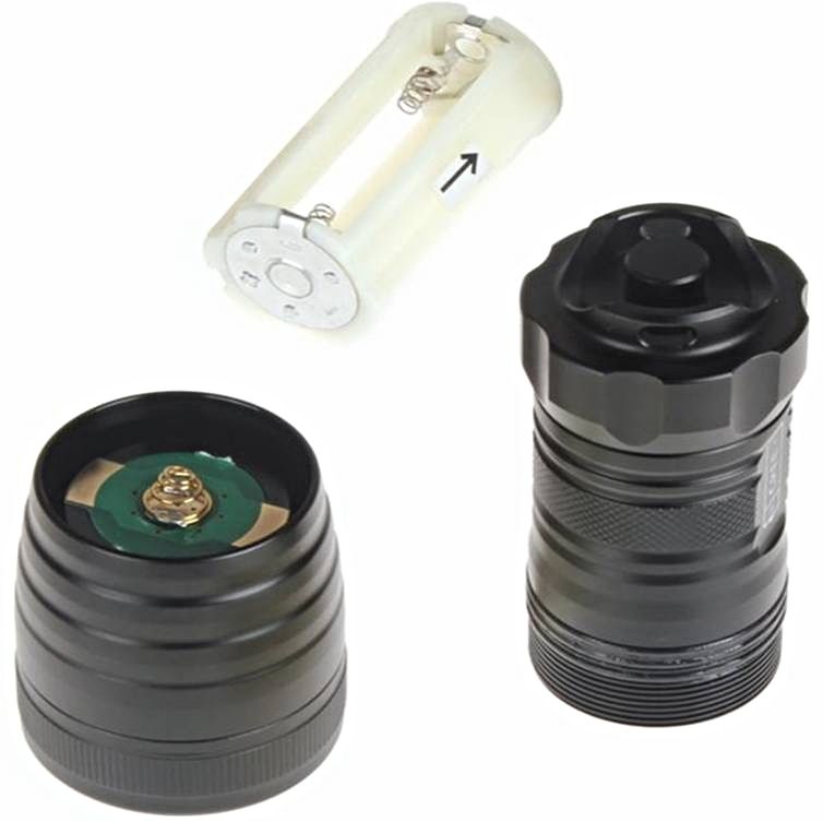

I prefer to use a single Li-ion in the light.  This replaces the AA battery carrier.   Use a piece of cardboard to keep the battery from rattling inside (see pic 1, pic 2)
Haven't tried the Efest 26500 - which probably has a higher capacity then the 25500 Trustfire & Ultrafire cells I used.  But this was all I could find at the time.

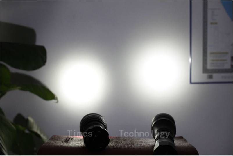

Beamshot:  DIV03 vs. DIV01 (right side)
For comparison with Brinyte DIV05 (see Post mouseover

Very robust light.   The wall thickness is thick giving it a solid feel.   It's also bright which is a must for me.
Uses 3 o-rings where it comes apart, which should seal out water nicely.

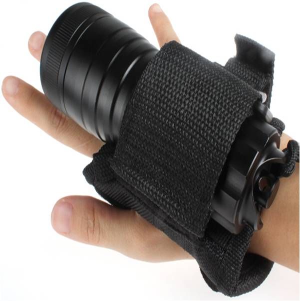

                                                                         Can be conveniently attached to the hand for hands-free diving >
Comes apart in only one place - Very nice! - minimizes potential for water intrusion.

3.  The AA battery carrier fitted with some rechargeable Ni-MH cells won't fit back inside the light.  Some rechargeables make the overall thickness to wide and the battery carrier won't go back in.   My newer XX Eneloops would not fit - they make it too thick.
These rechargeable batteries should fit:  Duracell, regular Eneloops, Maxwell, Sony.   I think the problem is that the battery carriers are not exactly the same.   Regular Alkaline cells fit fine.

I tried to put the cell your talking about (unprotected flat top 26650 KK) in there and it wouldn't fit.  So I cut the rear tailcap spring and tried again.  It still wouldn't fit.
But I managed to smash in the cathode end (+) of my KingKong. Frown   So 26650s don't want to cooperate in this light, but I tried my best Laughing
As far as the Efest batteries I mentioned... they will fit.  Their size is 26500 not 26650, which I think you were thinking.   Meaning the "nominal" size for the Efest is 26mm wide x 50mm long, and 0 = cylindrical shape.
BTW the inside tube diameter is 1.2'' (30.5mm) where the batteries go.
  in the hand size
