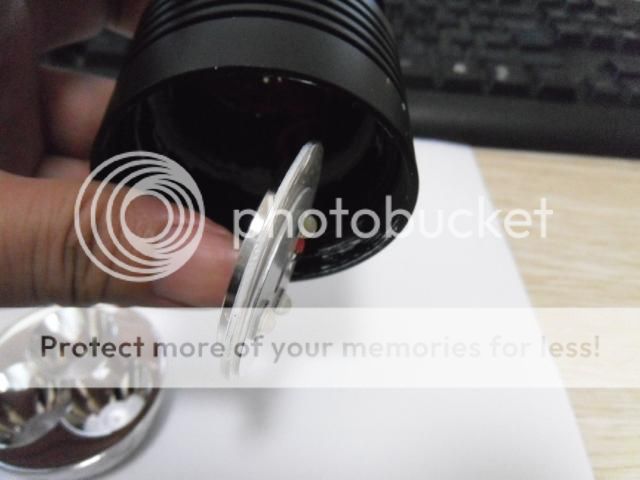

I just received 10 black 3x XM-L2 SRK's from an eBay vendor without emitter shelves, the triple board is screwed into the bottom of the reflector and just hangs there.
first off is this normal? I've handled several other SRK's (even the cheapest DX ones) and they have all hex a screw in shelf, these have the threads for them but no shelves.

Seen it before. Happened with my latest SRK. Mentioned here.
I was going to ask in the thread where you posted the pics about the SRK`s about where you bought them since you took the chance to buy 10 pcs from someone.
Its always a gamble. The pill-less SRKs seems to be something that have gotten a bit more common in the later months as far as I have heard.

The threads are there because a heat sink belongs there; it’s not an option — it’s part of the package:
http://upload.wikimedia.org/wikipedia/commons/7/7f/LED_package.jpg
The guy selling them got cheated by his supplier, one presumes.

That is totally SNAD. A thermal path to the body is critical. LED’s generate heat and that is why the body had cooling fins and such. I know you know that. Just giving you ammo for the claim. Demand a refund. This kind of crap needs to stop.

This is how my original gold SRK came..just a 3*XM-L 46mm aluminum star that sat on a shelf, no heatsink or anything, screwed directly to the back of the reflector
My new 6*XM-L2 I can’t even check because the bezel is glued on and so is the driver (and until I get my 3*XM-L one back up and running I don’t want to risk boogering up my only working SRK…even though the 3*XM-L was brighter than a 6*XM-L2 stock…bleh)
It even looks like they machined the threads off to make it a heatsinkless SRK too
There is a seller on Etsy that sells 50mm stamped copper rounds…going to get one of those and 3 XP-E/G 16mm sinkpads and direct solder bond them to that to rebuild my gold SRK…then might just go hole hog and fill the backside with say 1/4” of epoxy…can’t for the life of me understand why they would remove the heatsink threads…other than to make a buck off someone

I’ve seen a bunch that have no threads for a heatsink, just a single triple/quad/etc MCPCB sitting on a 2-4mm lip. Tired
This is the primary reason I recommend a Supfire M6 over any of the Chinese lottery SRK’s. Even at the SRK’s cheapest ~$25 it’s not worth the risk of getting a junk one. Spend a little more ($5-10 more, in most cases) and get a great quality flashlight.

Quick update, hopefully good news, seller sent me an email asking why I felt this “Aluminum slice heatsink” wasnt enough, it pretty much proves my case, I’m giving him 24 hours to make an offer to fix this or I will be going to paypal, he pretty much provided me the only evidence I will need.
(this is his pic)

No that’s not what I got, that is his picture of what they “should be”, below is my picture of what they are.

Got ya!  Now you've got some evidence. Tongue Out

That pic from the seller is almost just as bad as having the mcpcb floating. :Sp

New update (also paypal case opened but seller is still responding at this point so not escalating it yet)
5 of the lights have heatsinks! Not the normal screw in shelves like I’m used to, these are just drop-in pieces and the I.D. threads on the body have been removed on those 5 lights. This means even if he supplies me with 5 of this style HS I would have to turn them down or turn the threads off the body for them to fit.
Man I’m so glad I opened one of the no-HS ones first and found out, it would of been terrible the other way around.

Mcpcb on a shelf with a big ol’ hole in it and the shelf rests on a tiny ledge… :~
What are your plans to move forward? Keeping the 5 with the dropin piece of shelf?

Right now my plans are to either return them for a refund and buy from somewhere else (and risk getting ones with XM-L’s therefore costing me nearly $100 more buying emitters) or get a partial refund of ~$100 and either buy HS’s from bucket or have my guy make something better to fit.
If the end result is me having my buddy make something to fit I’ll probably have him go as far as to turn the I.D. threads off the 5 and make 10 press-fit, solid emitter shelves, with a tight press fit it should be better than any stock configuration anyway.
