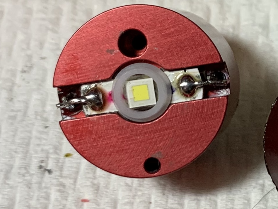

Finally got this one done. Dropped a 4000K 219C in a SPL-120. Unlocked the stock driver.

Is the output noticably higher than before?

It’s pretty significant, especially in the highest mode. I really hated the stock emitter.

What pill was in it?

The one on the right

Cool the good one from my testing. I’m getting 589lm with just an emitter/board swap XP-L V4 3C tested on my T/A muakka tube.
Been removing the good drivers and putting them into the round mcpcb pills… Resistor modded a few… of the others.. just to play with..

Wow, how did you get the potting out?! These things are built like tanks

It’s a RTV silicone potting… I soak them in a very strong thinner. I take a small drill bit and by hand remove the silicone down to the driver contact board, the 2 holes opposite the lead holes are for filling/ venting the pill, remove the silicone from those 2 areas and soak in thinner. It takes time and patients but eventually the silicone breaks down enough to push the driver out. I used to hot air the spring contact board off, now I just soak them.
