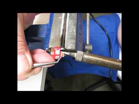

Just a short? video on a different approach to soldering wires to a star. The problem is flat reflectors like the HD2010 and many others. It is usually a problem in many thrower lights. When you use thicker wires, then there are issues with the reflector hitting the wires, or not being able to get the reflector down far enough, to focus the led. Hopefully, this video shows a solution that most modders can do, if they think it's worthwhile. Some of you may already do this. There's nothing new about modding, from what I have found. Usually someone else is already doing it, but I haven't seen a video on it.
You just have to use Very little solder on the wire, so that it doesn't migrate and touch the side of the star. It needs a really fine point iron tip. With the insulation flush like that, it keeps the solder joint restricted and helps to avoid having a short to the star.

I am using a small piece of flat copper sheet stock about .012" thick and butting the wire up against it, so that only the thickness of the sheet is on top of the star.
So after being skeptical this was any better than my nickel band method I went ahead and tried this on my EagleEye X6 yesterday night and it worked great. Its sort of different methods for different applications, not really competing methods to do the same thing, this way wouldn’t work if the holes in the HS wern’t spaced ~16-20mm apart but in lights like that of works great.
