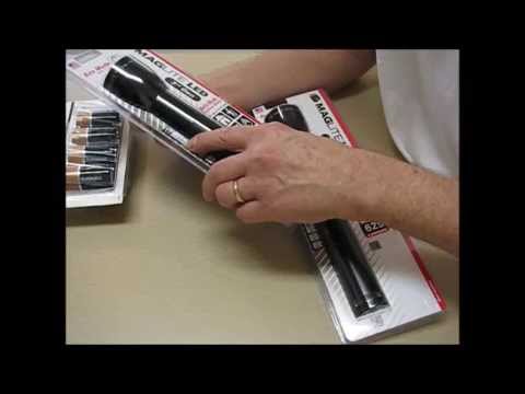

Ok folks, here it is and it's a long video, with a couple of "double takes" in it, but it will show the tear down y'all want... I hope.
Totally new light! A Major design change and they really did some good things to the new Mag!
I love this new light!
