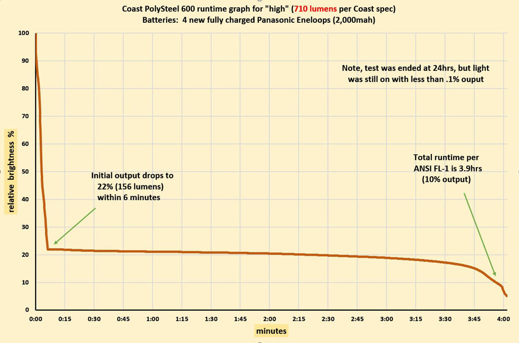

Ran into this extreme down-regulating when I did a runtime graph on my Coast Polysteel 600, advertised at 710 lumens on high. I knew it would throttle down, but didn't expect that much.
good example

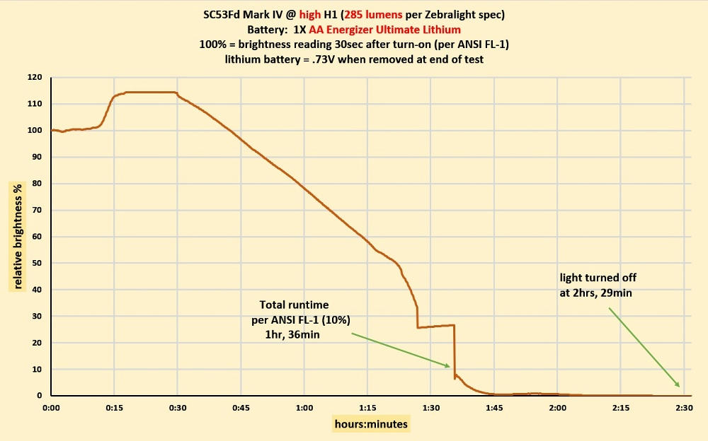

Interesting co-inky the subject of runtime graphs for single AA Zebralights has come up. Ran several runtime graphs on my SC53Fc last month. Was going to post these on CPF before things there went south. FYI, this floody version was a Zebralight custom build when I ordered it, but now it's on their regular list.
Three different batteries were used:
(1) Energizer Lithium
(2) Panasonic Eneloop Pro
(3) Energizer Max alkaline
Make your own conclusions on how well regulated this model of Zebralight is.
This first graph is with an Energizer Ultimate Lithium. You get about an hour before brightness drops to 70% (or about 200 lumens). I can't explain the wonky rise in brightness during the first 35min. Anyone have thoughts on why there's a rise in brightness that didn't occur on the Eneloop or alkaline battery?

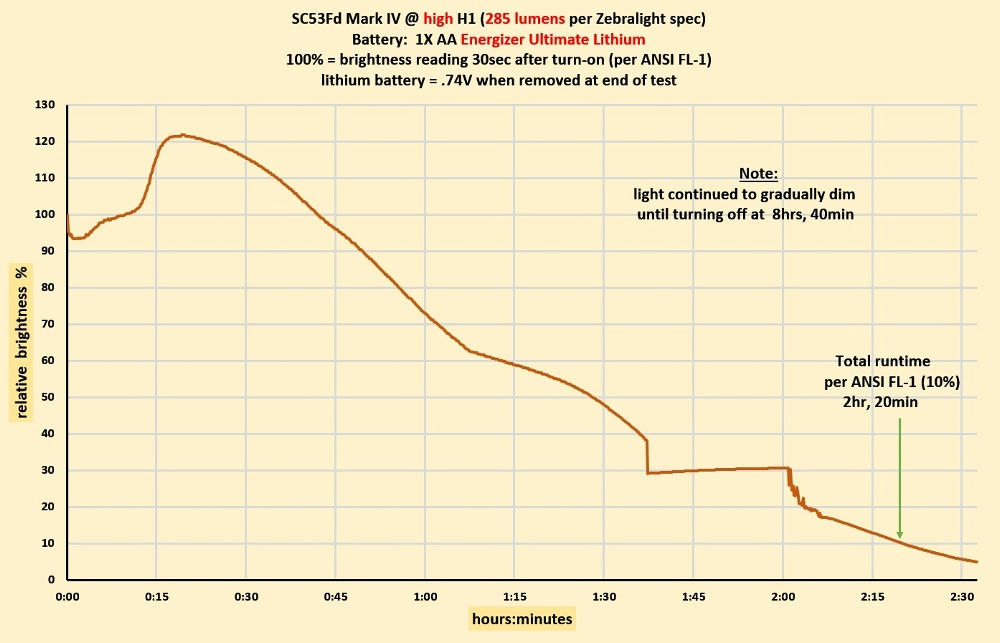

The wonky rise in brightness above made me repeat the test again, to see if it was duplicable with another lithium. It was.

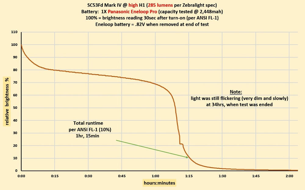

Panasonic Eneloop Pro. Here again, we get close to 200+ lumens for about an hour, assuming the Zebralight spec of 285 lumens is valid.

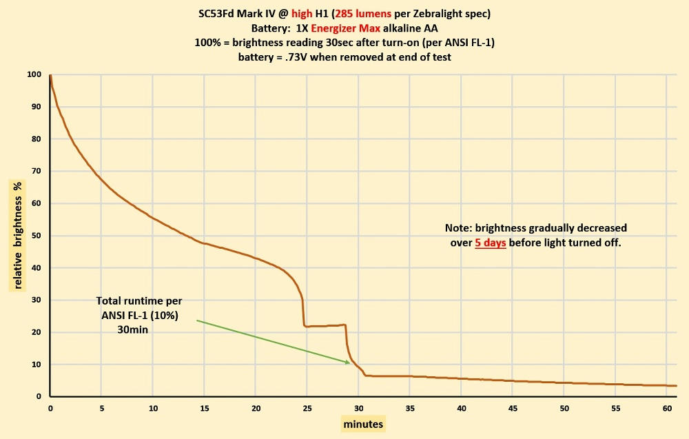

Finally, an Energizer Max alkaline. Even though ANSI FL-1 is only 30min, the bunny kept running for 5 days, a testament to how well the Zebralight can run at moonlight levels down to about .8V. Also, I suspect the alkaline's ability to recover at very low current draws, contributed to the 5-day runtime.
Yes, you definitely need to use an Eneloop to make the Zebralight give a regulated output. I think those SC53Fd graphs match what the SC52’s deliver, though I think the cool-white and neutral white “w” versions are more efficient than the Fd.

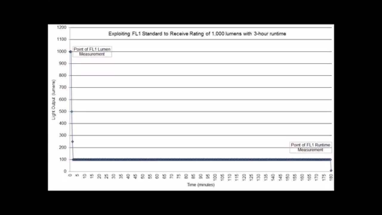

Very informative video, thank you!
Now I know ANSI FL1 Standard is pointless, because it can be so easily manipulated.
I will use my way of calculating runtimes - sampling every minute and waiting for the output to drop below 50% of the so-far averaged output.
This way Sofirn SF14 does 131 lumens for 3 minutes at High, and 27 lumens for 8h36min at Medium.
