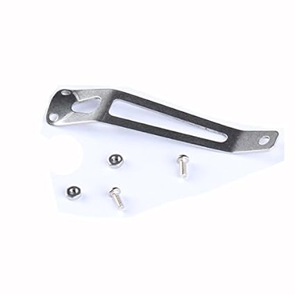

CRX where did you get that pocket clip?
From a knife, can’t remember which.
Reminds me of the old Convoy clip, but smaller
