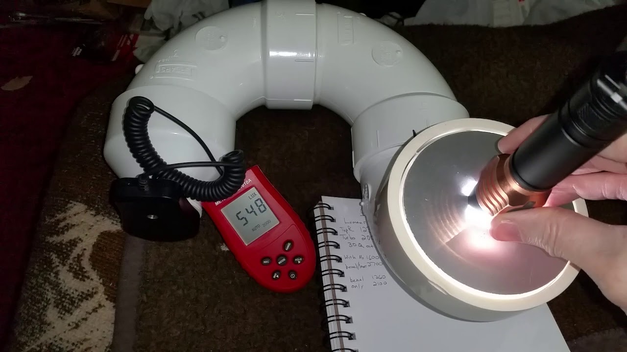

The lumens and amps are at 20 seconds due to the rapid heat build up. Turn on results are a little bit higher, but no big deal.
Top of ramp was 1230 lumens and 8.3A
Turbo was 2000 lumens at 18.6A
That’s some serious amperage right there. I think most folks like Maukka and M4D M4X only measured about 15 amps on turbo.
This is using a button top Samsung 30Q 18650. Lumens are measured on a Texas_Ace Lumen Tube calibrated with one of Maukka’s calibration lights.
Amp draws were made with a thick wire and a UNI-T UT210E clamp meter.
Parasitic drain with switch lights on 106 microamps. With switch lights off I got 24 microamps.

As mentioned by Tom E, the bezel does seem to block some of the light output. With the bezel and AR coated glass lens removed I saw 1600/2700 lumen (at turn on). With only the bezel on 1260/2100 lumen (at turn on).
