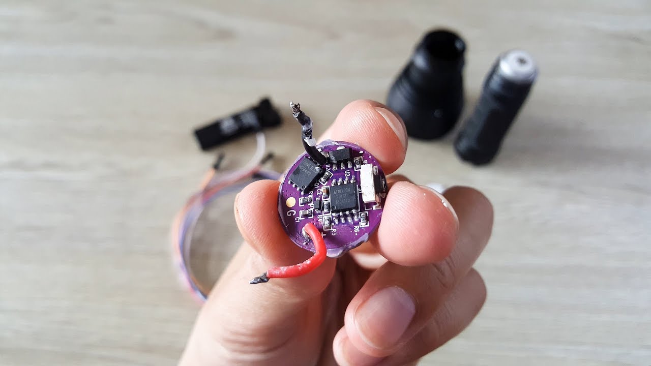

Hi Jeff
The head should not be glued, it might be hard because of the rubber O ring below the bezel, just apply more force.
Hi Yokiamy,
Could you post a picture of the SP36 with the bezel removed?
Maybe that would give me a better idea of what I need to do to get it off.

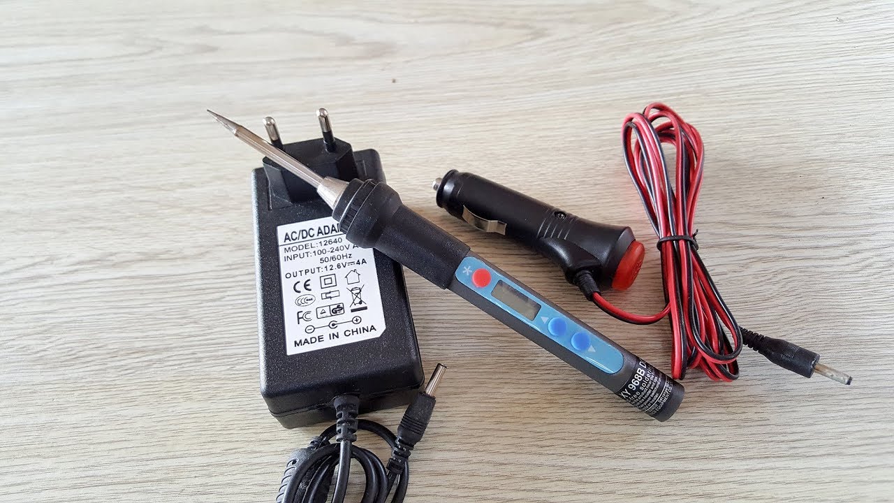

What soldering iron is that?
It looks interesting and slim to fit in tight spots.

Hi Jeff
Check THIS link
It might be that this review is already posted on BLF in English (i believe this is Russian or so) but the pictures will give an idea
I can spin the bezel off an SP36 and post some pics - but I’ll have to wait till tonight to do it.
basically, the top half to three quarters of an inch of the head spins down onto the lower portion of the head. The one I took apart required a rather good grip. You might want to try a rubber strap wrench or one of those jar lid opening grip pads to help.

Thanks for the offer. No need to grab some shots.
Yokiami’s post pointed me to a sight that has the light broken down.
Thank you Yokiami.
I must say that Russian review is the first I’ve ever see with X-Rays as part of the review!
Thanks for the help both of you.

FYI - Once you get the bezel off, don’t get feisty with the reflector. It’s screwed into the body from inside the driver cavity.
Good to know!

This is my soldering iron. It is not really good for this job. You must have a lot of experience to be able to use it.
