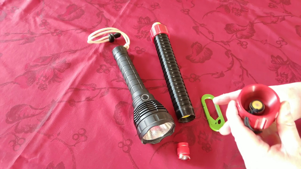

1) Joining black handle and red top end piece. You’ll notice the red part has 2 threads, one for the blade and one for the handle.
2) Pushing blade components into each other and the handle and glueing the end cap to the end of the blade. The end cap has threads for fixing the collapsed blade with about a quarter turn. And it has a ribbing for better grip.

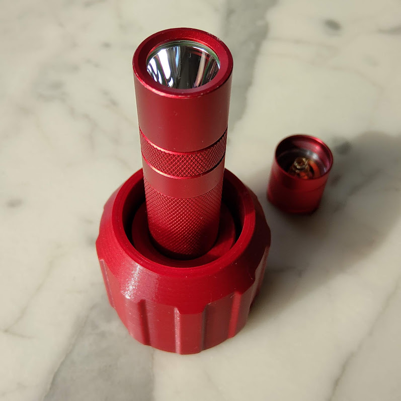

3) Mounting the flashlight to the red bottom end piece and joining the end piece with the handle. There is a lip in the red end piece where the flashlight is firmly held in place by only screwing together flashlight body and tailcap.

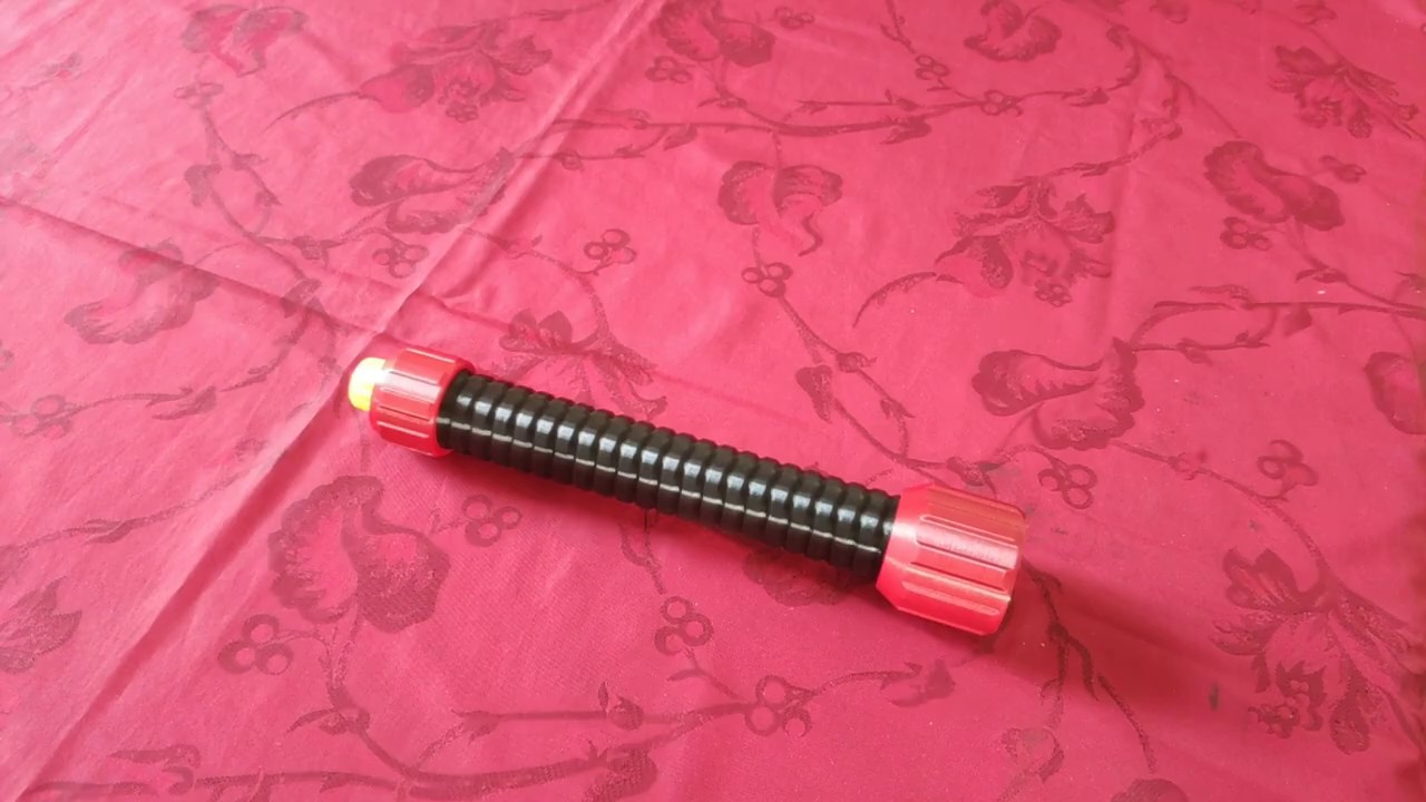

That’s it, here are some more pictures of the collapsed and expanded lightsaber. There is also a hole in the bottom end piece which allows to mount a lanyard. For size comparison I added a Convoy L6 to one of the pictures.

Length (collapsed): 31.5 cm
Length (expanded): 103.5 cm
Diameter handle: 4.0 cm
Diameter (largest): 6.0 cm
Weight with cell: 325 g
