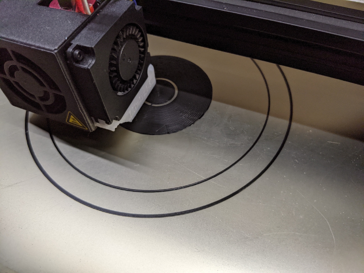

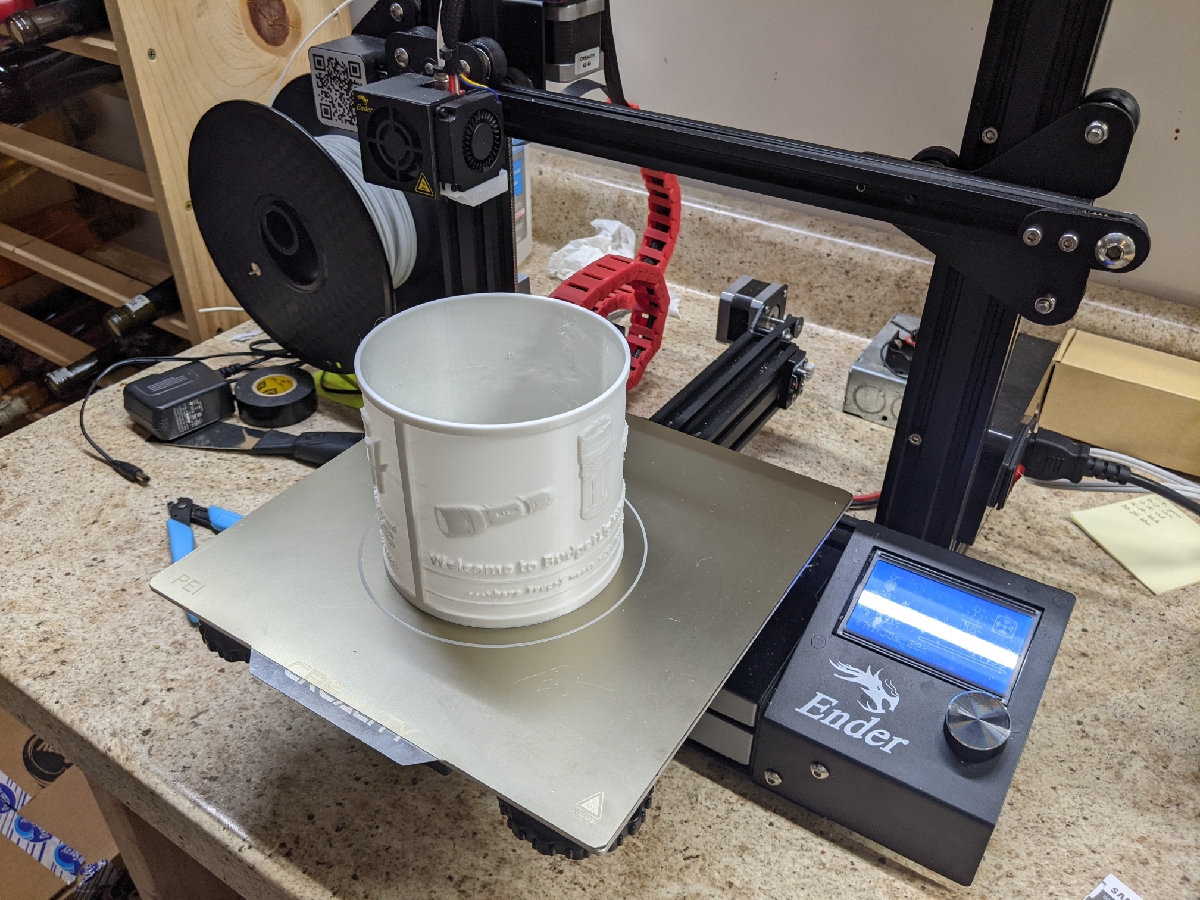

First off, a clip of the first piece being printed:
And here’s the end result of that:

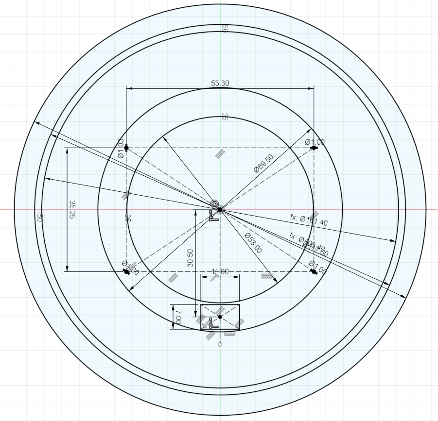

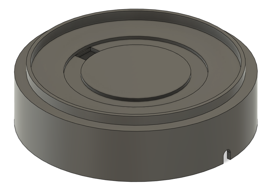

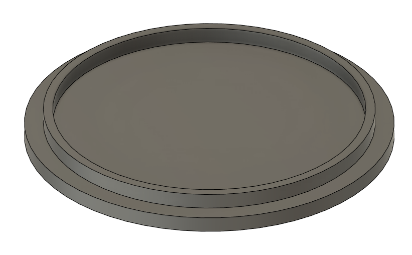

With the middle section complete, time to design the top and bottom pieces using Fusion 360:

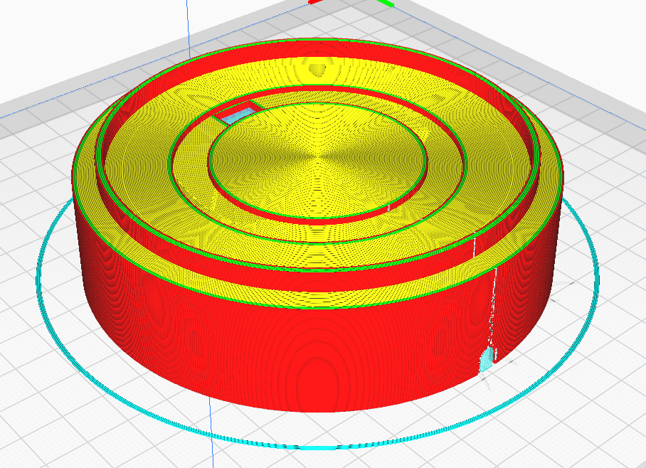

And here’s a shot of that lower section being “sliced” in Cura (taking the 3D model and turning it into 3D printer instruction code):

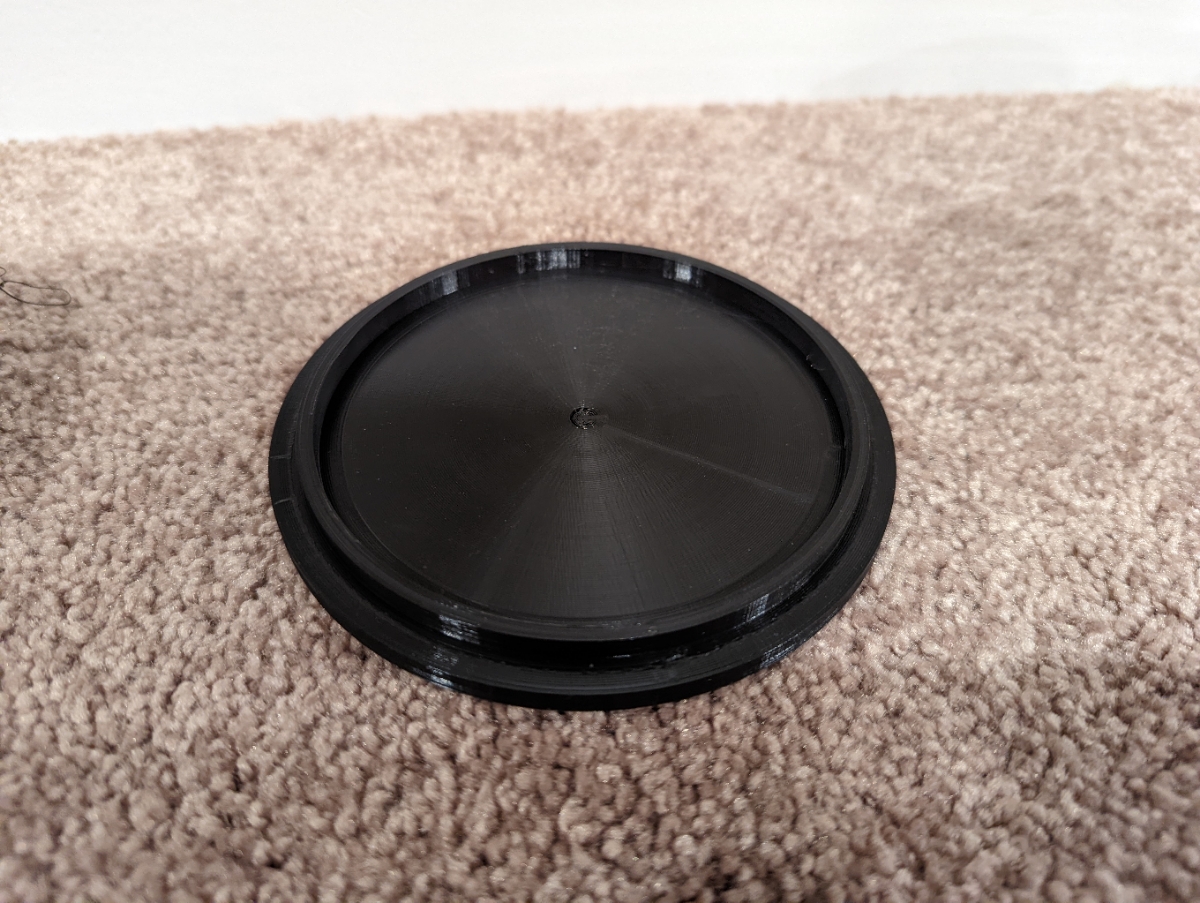

Here’s a shot of that top cap being printed:

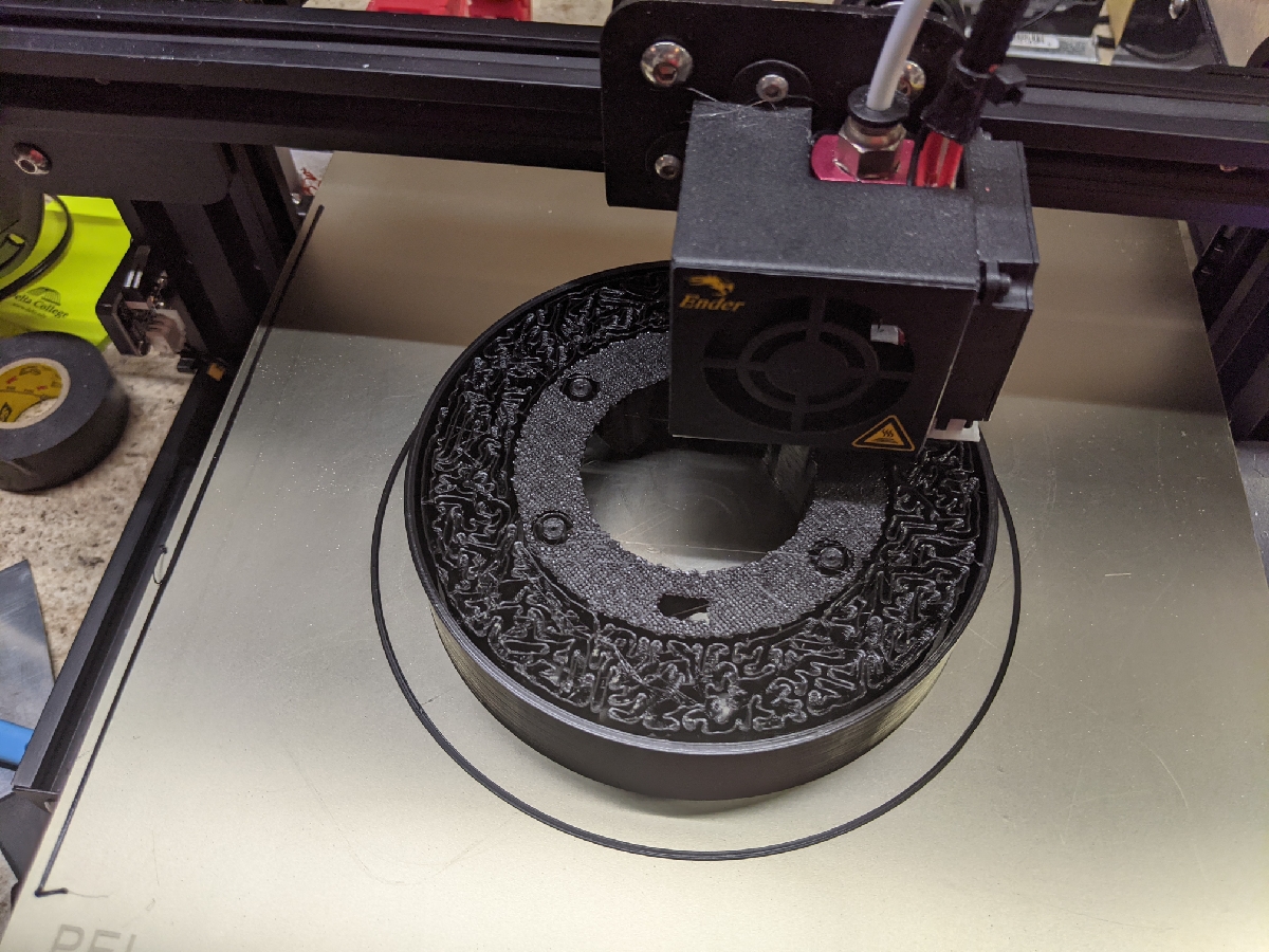

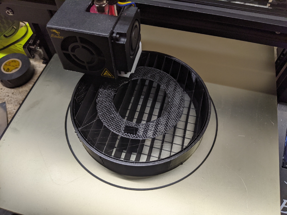

The first iteration of the base being printed. Notice the organically looking structure in that middle. Those are “tree supports” that give overhang something to print onto. You can’t just print in mid air!
And, well, I didn’t get a couple pieces of the design perfect on the first try. So back to Fusion 360 for a couple adjustments, and back to the printer. This time I used a more “normal” support structure of lines. The original print of the base took 18 hours. I didn’t want to wait that long for the revision so I greatly increased the speeds and played with the support structure settings to get it down to 6 hours. What a difference some of the settings came make. Generally speed comes at the expense of quality, but it worked out fine for this model.

The pieces:

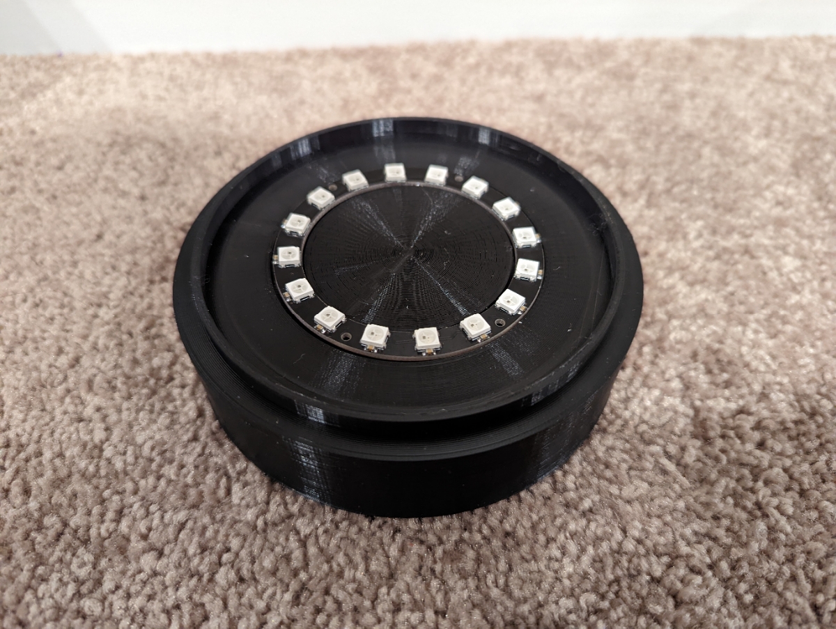

Top of the base with it’s Neopixel ring

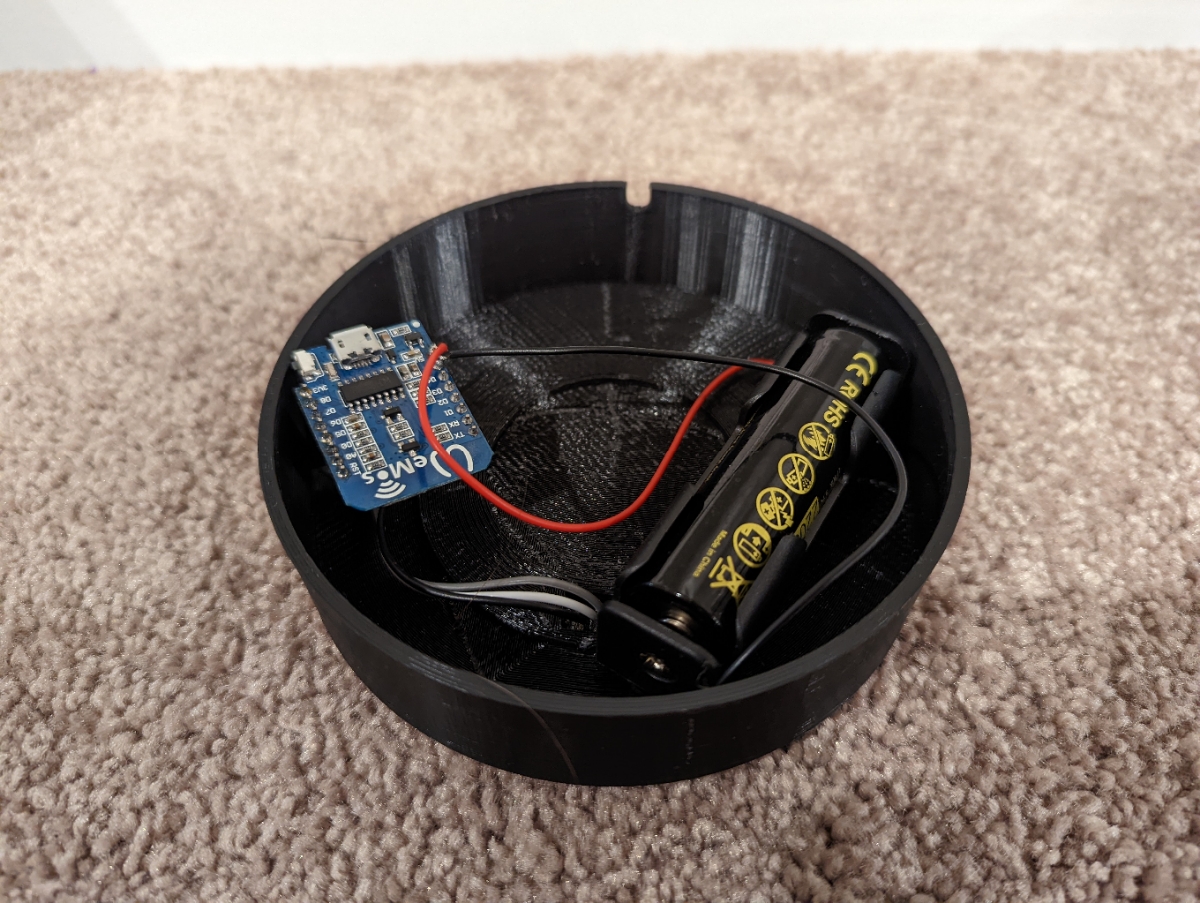

Underside of the base with the Wemos D1 Mini (an Arduino-capable board with wifi) and a battery
Top cap, nothing too special

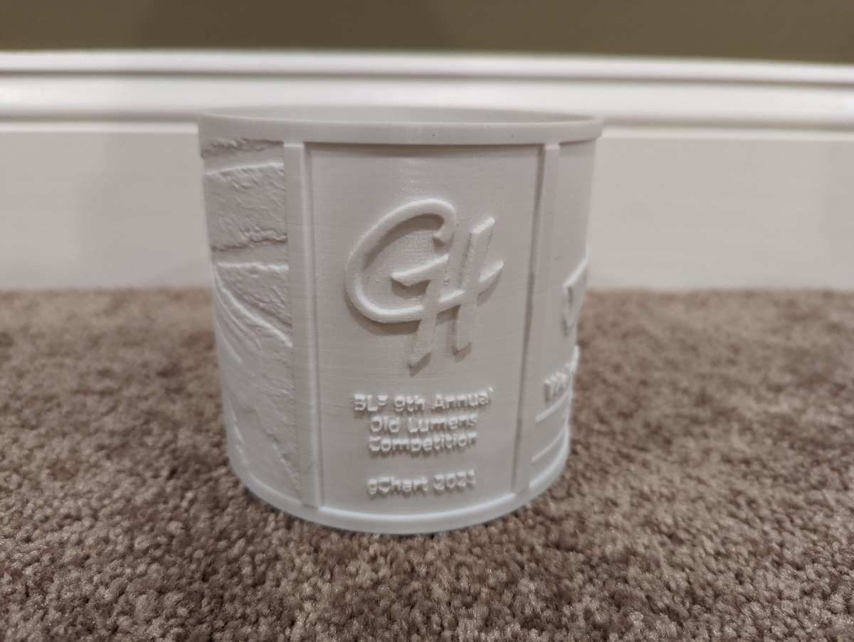

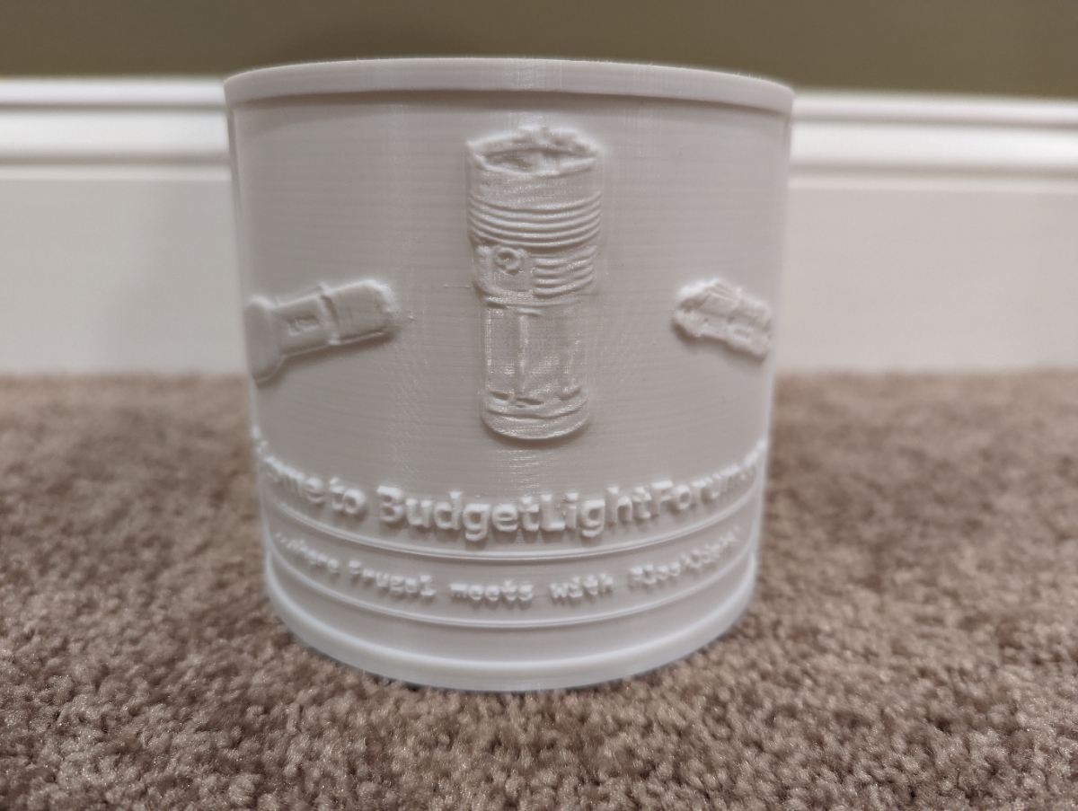

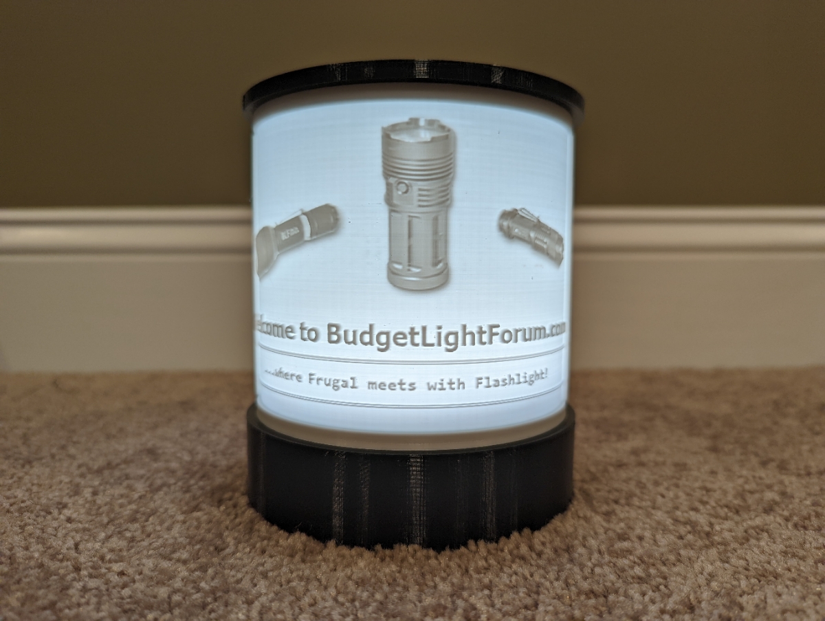

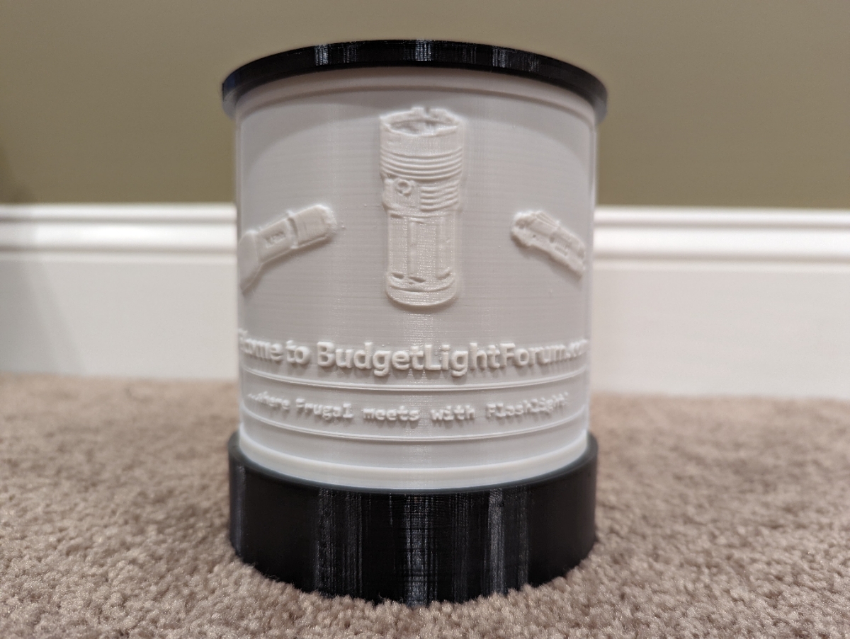

Lithophane, panel 1: the BLF web banner

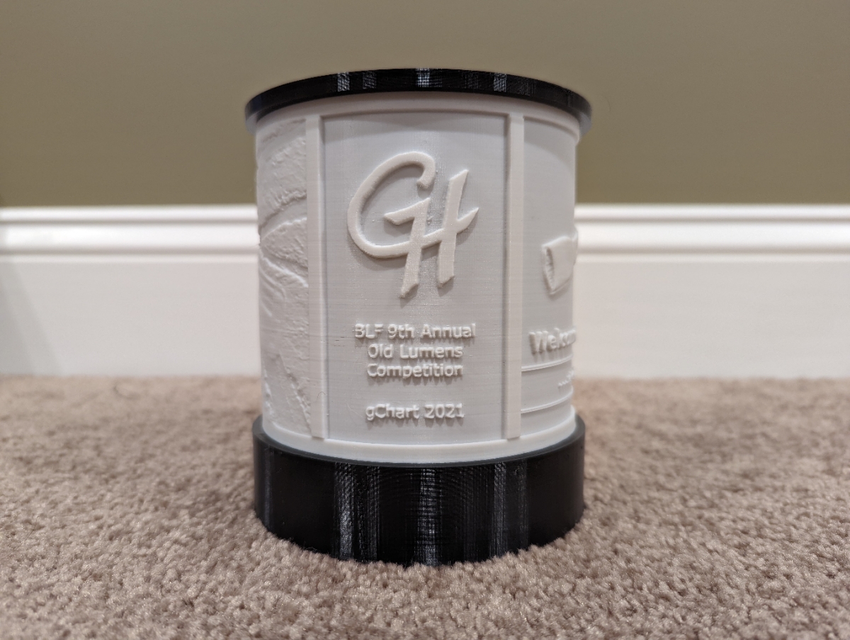

Lithophane, panel 2: my initials and info about the contest

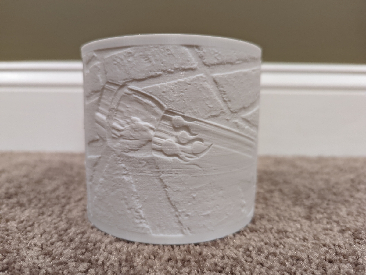

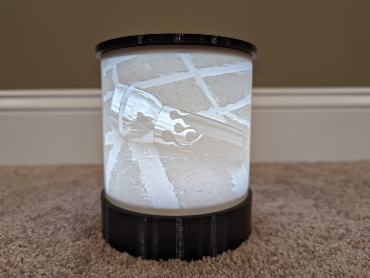

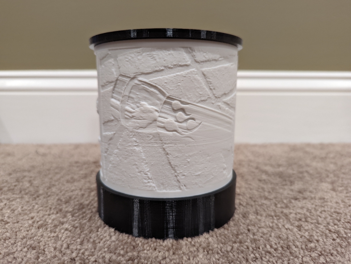

Lithophane, panel 3: the awesome flamed MagLite that you see in Justin’s (Old Lumen’s) avatar. What a special and great looking build!
All assembled, unlit
Here are the three panels of the lithophane with everything assembled but unlit

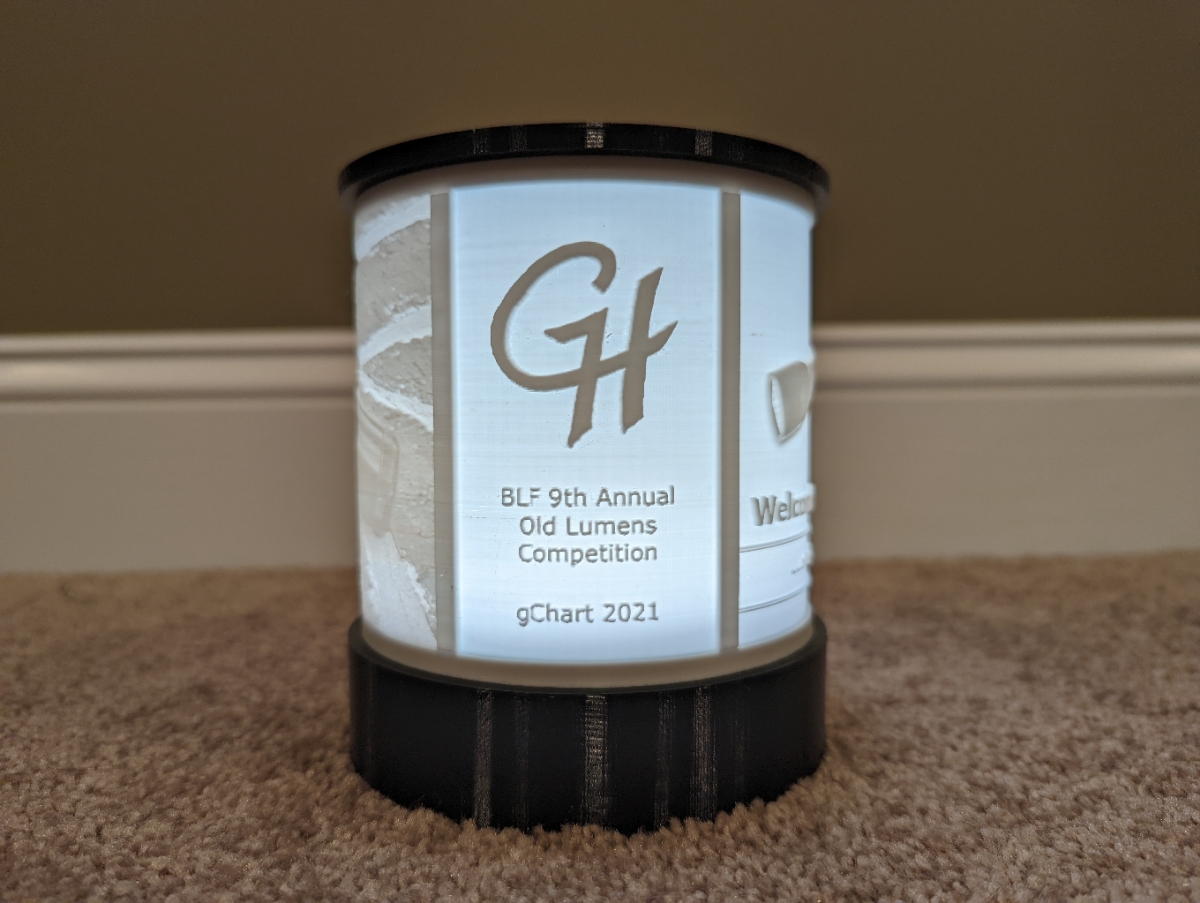

All lit up
Same thing, but now lit up!
