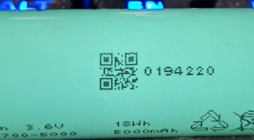

Mine reads out:
1PBU13F0194220C it is not enough numbers and the decoder complains the 4th character is wrong.
This site has a table… but none of the numbers we got seem to work..??
Yeah, these websites appear to be specifically for LiFePO4, as you mentioned earlier already.
For Molicel batteries, information including the cell date code is available, for example here for Molicel P45B. So far, I have not come across something similar for EVE 50PL.
For what it’s worth, I got a 50PL from Convoy three weeks ago with the green wrapper that looks exactly the same as the pictures shown here. I don’t think you have anything to worry about.
Yup. At this point it is strictly curiosity. Especially considering that pictures that I have found of the 50P and 50PL look identical. The answer would be to just test the darn thing. But I don’t have gear that can test at anything over 30 amps… which either should handle. I suppose I can pull out the AC IR tester and see what it can tell me. I think I will do that later and report what I get.
I would like to buy a few more of these Eve 50PL (if that is what they are) but can not find them in stock anywhere in the US.
My very basic test against a new Samsung 40T in both the NS14R and A54U shows these batteries to be much more powerful. I would love to see some test against some of the newer high discharge heavy weight batteries.
Answering myself…?? Anyway I tested the AC IR on some cells. Two Molicel P45B cells two JP40 cells, and the 50PL (?)
The two P45B cells measured 7.27. and 7.24 mOhms. the two JP 40 cells were at 3.85 and 4.02 mOhms. The 50PL measured 3.09 mOhms.
Based on these tests and having tested a couple of hundered cells with the ame setup, Yes I think the one I have is a tabless cell.
If the accounts saying the 50P in not tabless are true, I guess that means, at least the one I have, is a PL version.
