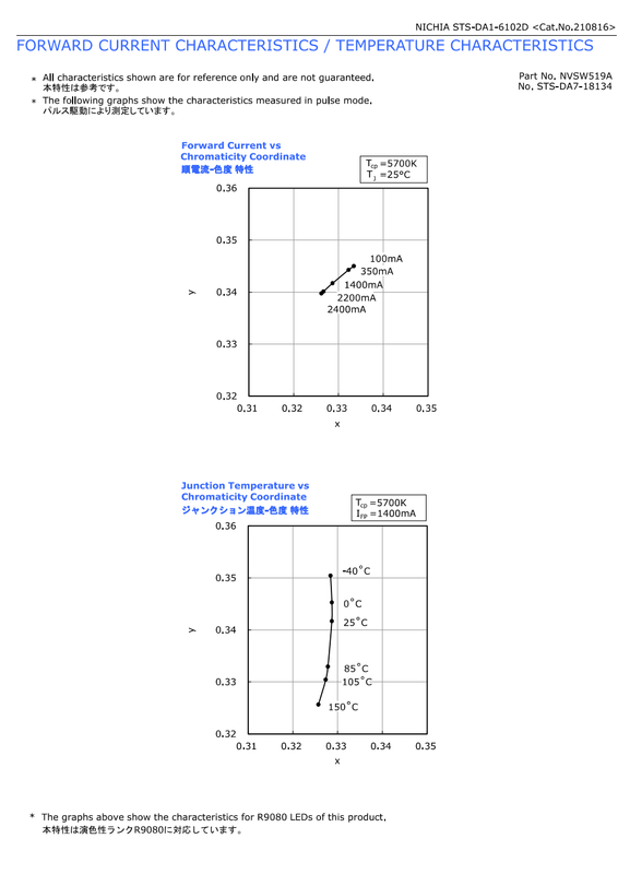

The tint shift with heat is normal for almost all emitters. Current as well, but of course they are closely related and the electrical inefficiencies compound that, too. If you look at the data sheets for various brands/models you can get an idea of what to expect (from bare emitters). Hopefully this shows up legibly but here’s the page for the R9080 5700K. They’ve got one for forward current and one for the junction temperature (where the base of the emitter meets the mcpcb, not the measured temp in the head or driver). For the 519A the effects on the lower temp models are somewhat drastically different than shown here for the 5700K (they only provide 3000 and 5700 on this one). Not all emitters have such a huge difference between temps or sometimes just in the shift itself.
@Correllux that’s a great and helpful find - thanks. The magnitude and direction of Duv change seems to correlate well to what I see so far. At least, it seems like my amateur home test is in the ball park.
If I understand the diagram correctly, and I don’t know exact current nor temp in my light, plus need to check calculation again (lol many if’s) but from approximating x,y coordinates of the 2 graphs:
Forward current and Duv
100 mA: Duv 0.0013 CCT 5431 (x=.3340, y=3450)
2400 mA: Duv 0.0060 0.0019 CCT 5743 (x=.3270, y=.3400)
Duv becomes more negative by 47 points as forward current increases (vs my observed 48 points swing that I noted here)
EDIT: I made a mistake calculated above part. Duv actually stays about the same.
Temp and Duv
25° C Duv 0.0020 CCT 5650 (x=.3290,y=.3420)
85° C Duv –0.0022 CCT 5706 (x=.3280, y=.3330)
Duv becomes more negative by 42 points as heat increases (vs my observed 30 points swing that I noted here )
Yep. And this is just helpful so that we know general behavior - and that some emitters may look drastically different in different modes vs. others (like the way the SST20 tends to shift a whole lot for most bins and the standard CRI versions). It’s not like we’re needing to be exact to engineer a circuit or measure really accurately, so with most emitters the data sheets almost tell us everything we need to know, save for how much overcurrent they can handle and where they start to get angry.
Remember those X/Y coordinates are all relative to the BBL, too, so 20 points in one temp range won’t be the same difference as 20 points on a different temp emitter. And too (sorry) that the Opple is just never going to give all the data from its sensor (it can’t), and we don’t really know what the software is fudging with the data it does receive, just some of the quirks we see in the results (such as the oddball warm temp favoritism in CRI, etc….stuff outside the expected range of error/accuracy for the components and that is unaffected by how carefully we try to standardize the conditions).
The lights will never ever reach the junction temperature of the emitter (thank goodness). But that factor is why back in the day some smart people started to design and get manufactured the nice DTP boards we use today, which is great since many emitters also have lower thermal resistance now as they evolved over time. Switching to hosts with integrated shelves for the board to sit on also helped a ton compared to pills, so we can start to dissipate heat a lot better than we used to, and sometimes enjoy less tint shift while the light is in use unless we’re really overdriving them and trying to maintain that output/heat saturation.
All of those if’s, and ya change one and it affects one or three others. Complex little alphabet soup. :slight_smile: And that’s just bare emitters! lol The science and physics of Light is just fascinating really…way more to it than I would have ever guessed…and human eyes to boot.

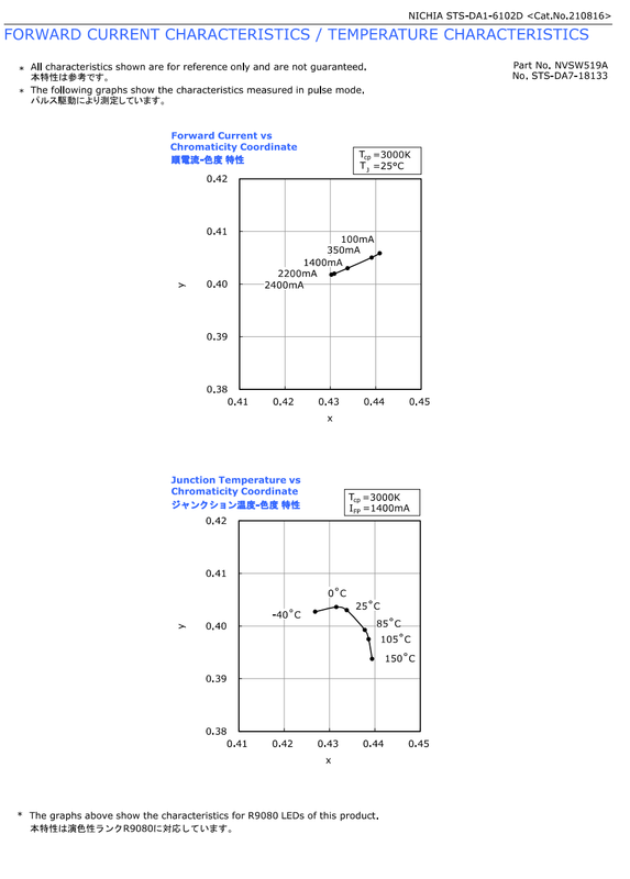

Now check out the same info for the R9080 3000K emitter. Makes a hard turn for Albuquerque compared to the 5700K.
They never specify bins for these, but binning does also often matter a lot. Often people complain about something and aren’t aware of binning or that they may have gotten a less-prime bin (LH351D seems to be a popular opinion victim of that, maybe). For these 519A emitters the bins may not make as much different but they do have several bins per temperature as well as I think 8 chromacity groups within that binning. What we get and see just depends on who bought what. :slight_smile:
I did my own approximation. I cut the graph where x and y axis has 4 grids (0.01 times four). I scaled the 4x4 grid to 400x400 pixels (notice x axis and y axis are scaled differently), so that each pixel would equal to 0.0001.
100mA is located 235, 150 from the top left. So, I get 0.31+0.0235=0.3335 for X, 0.36-0.0150=0.3450 for Y
2400mA is located 163, 202. 0.31+0.0163=0.3263 for X, 0.36-0.0202=0.3398 for Y
Plugging in the numbers in www.waveformlighting.com for duv and CCT, I get:
100mA, CIE x: 0.3335, CIE y: 0.3450, DUV: 0.0016, CCT: 5453
2400mA, CIE x: 0.3263 , CIE y: 0.3398 , DUV: 0.0022, CCT: 5776
@limsup good catch - thanks. Did you have a chance to check what I got for temp?
If we assume 5000k behaves similar to 5700k, then this means the temp factor alone would be an explanation for why TS32 looks so green with lower output. At least, this was my observation for the 519a 4500k (I sat and watched y drops with time).
The way that temp curve from Correllux drops straight down the y axis is impressive/interesting and a sure indication of temp causing Duv drops, I think.
I’ve read about LED being green at lower output and less so at higher output from other reviewers. TS32 is probably the most obvious change that I’ve seen, green at lower output and beautiful at Turbo.
I just checked the first one. The reason I checked it was because the numbers did not look right. You noted higher CCT for lower current, which I thought was odd. After checking the numbers myself, it was apparent that you mistakenly flipped the numbers around.
I observe that too that in lower output the light appears more green and looks nicer at higher output. I notice it on my TS25 (Nichia 519A 5000K) and notice it more on SP10 (Samsung LH351D 5000K). However, my measurements are somewhat inconsistent with what I see. I measured DUV for 7 stepped output on my TS25 and they clearly have upward trend along the output levels. That is, higher the output higher the DUV. DUV for 3/7 (about 10lm) output was –0.0017 where as 0.0010 for 7/7 output (about 900lm). Also, the shifts in CCT along the output levels were quite large. Lowest was 4490 and highest was 4879 (max difference 389). I think DUV comparisons do not give consistent results with what I see when CCT changes a lot.
At first, I thought higher DUV for higher output applies to all 519A leds, but I was wrong. I recently reflowed 519A on my TINI2 with the leds taken from my broken TS25. I checked DUV across different output levels (15lm to 500lm), and they pretty much stayed around –0.0038. The shifts in CCT across output were WAY smaller compared to TS25 (4824 to 4984, max difference 160). So, I think the way leds are driven (and possibly different optics) matters a lot. It may also have to do with the number of leds. There are 2 leds on TINI2 and 4 on TS25.
I will have to investigate it more. What I can say for certain so far is that CCT tend to go higher as output increases.
@limsup I was just too happy to find (wrong) numbers that support my hypothesis and committed an “investigator”’s no no. :person_facepalming: :slight_smile:
But as usual I’ve learned more from a mistake than a success (don’t we all). And that is looking at Duv curve and predicting what is happening.
I was confident of a Duv drop with higher forward current, from the curve dropping downward (lower y coordinate - a classic sign of more negative Duv) at 2400 mA. But what I didn’t foresee is the BBL curve also curves downward as it moves left. And since Duv is relative to the BBL curve (Correllux mentioned this), Duv values stay the same for both low and high forward currents. I hope I didn’t lose everyone here. I am sure I did lol.
