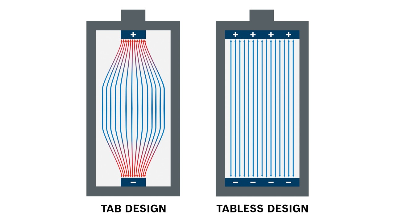

AM04 and JP40 both tout their “tabless” design. I have no idea how unique this is (are they the only ones who have it?), but curious enough to find this article:
The enhanced efficiency of the ProCore18V+ battery is achieved thanks to the tabless design of the integrated 21700-series battery cells. In conventional lithium-ion batteries (left), each individual battery cell inside has a narrow connection band to the anode and cathode on both sides – the so called “tab”. These tabs create a bottleneck for the power delivered by the battery and contribute to the cell’s electrical inner resistance, causing heat to be generated. To ensure that the battery doesn’t overheat, particularly during high-performance applications, the tool shuts itself off, leaving the remaining energy in the battery unused.
In tabless cells (right), the electricity can flow through countless paths across the entire length of the anode and cathode rather than being restricted to one or a couple of tabs. This new design reduces the inner resistance of each individual cell by around 50 percent and therefore substantially for the battery pack as a whole. Significantly less heat is generated as a result, which is a limiting factor in demanding applications. All in all, this translates to up to 71 percent longer runtimes compared to conventional batteries thanks to the combination of tabless design and precision-tailored battery management.
The AM04 (identical to the JP40), JP40, 40PL, VX40, and 45D are all “tabless” designs.
Interestingly they all have a single tab to the top contact. :joy: The only true tabless cell so far is the Tesla 4680 and maybe other 4680’s. All are “continuous tab” or “full tab” designs though that does indeed significantly reduce the IR of the cell.
Do these “ture” tabless cells have any significant advantages over cells like the JP40 and other “half-true” (?) tabless cells?
IMO we can”t say yet whether there is a practical, noticeable difference when using fully tabless cells. The individual cell chemistries and construction might make a bigger difference than the tab.
We’ll have to wait and see if fully tabless construction is ever used on the smaller (18650/21700) round cells and then start comparing performance. Could be months or even a year or two before that happens though.
Though I’m a big fan of diving into the tech details IMO it’s best to just compare specs and actual performance vs what construction or chemistry is used when choosing a cell. Tabless or not doesn’t matter once we put the cells in our devices. :slightly_smiling_face:
