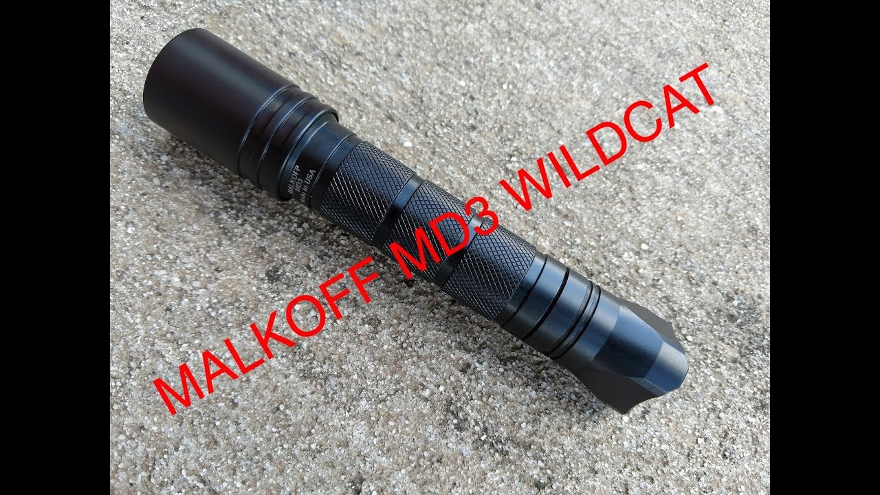

Malkoff Wildcat or Hound Dog can realistically do 1000l for an hour but not in a USB charging body.
The Head can be loose or tight for Low or High output or you can get a single speed too if you really need to?
They are really great lights and about as rugged as anything can be!

A step up from the Pflexpro are Elzetta’s. You want USB rechargeable and waterproof, but those don’t go together. The toughest most durable light is an Elzetta. They package says it is submersible to 10 meters, drop distance 5 meters, but I am sure it would work fine as a dive light, and they work after being dropped onto concrete at 300 feet from a helicopter. The Malkoff V6 Wildcat is a great light. I love mine too, and on a MD3 body it is not too long. You can run rechargeables in it. I use the MD4 Body with 2 18650’s but you can run it with 2 18500 cells in a MD3 body. The Wildcat is a serious flood light.
Yup, I just finished reading a bit about Malkoff and Elzetta, especially about your question to compare between MD3 4000K neutral and Elzetta Charlie.
Question: Is there any benefits to get continuous OTF of 1100 vs 1500, since that’s your choice, especially in terms of battery?
The Malkoff V6 Wildcat looks very interesting. I tried looking it up on Youtube and only found 1 video. I kinda want to pick this up instead of a ZL.

I am guessing you found Gear Runners video. If so, I would say he did a very good job at explaining the light and also the way the light looks in real life as much as possible.
