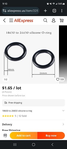

I don’t have that charger but after reading your post, I think as a workaround you could use these when charging 18650 batteries:
They are available from the Convoy flashlight Store on Aliexpress:
https://www.aliexpress.us/item/2251832820119349.html?spm=a2g0n.search-store.0.0.7eb3upCWupCWTt&browser_id=f525e57ce85c44dd8fe2a7850c7d151c&aff_trace_key=c6480e0e7d974d19a1bf1d7484690f90-1695347465374-07234-_ePNSNV&aff_platform=msite&m_page_id=emwcgbpscaausylh18ae3dd57941af4f4752ee76f4&gclid=&algo_pvid=448e50f0-7c30-40c1-a176-56ffd82952df
I am going to try that fix. Thanks for the suggestion.

If you have Harbor Freight in the area, you can get a whole box of O-rings for uses like this. Some flashlights have peculiar sizes and you may have to play with various O-rings to fit.
