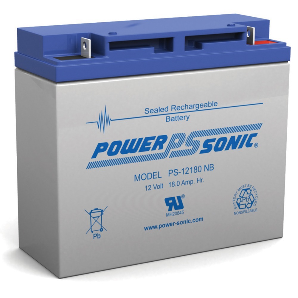

Just get a Powersonic 12volt AGM battery of appropriate size for your needs and a suitable 120Volt inverter. Simple, safe, cheap, reliable and done.
( I have one of these at 6+ years old and still tests close to original capacity, only needs topping up every 3-4 months when not used)
