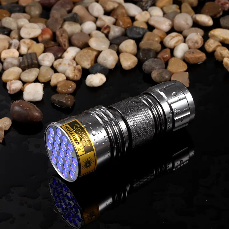

I’ve got 2 of these:
28 LEDs
With a modified tail switch it can now both tail stand and fit an 18650 (unprotected though).
And one of these on the way:
21 LEDs

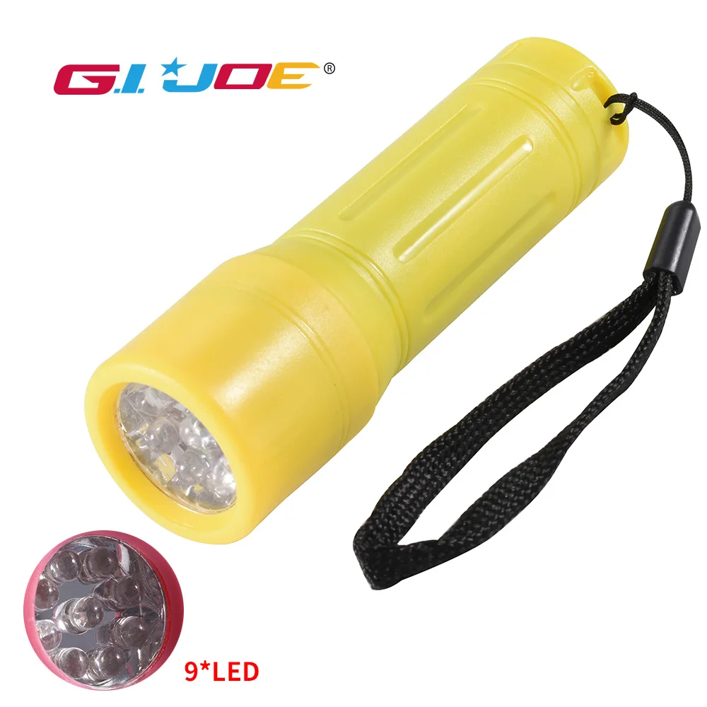

That 9 LED ones will most likely run unregulated with 3*AAA batteries. I’m not sure if I can recommend those.
Jerommel
(Jerommel)
303
They all run direct drive form 3x AAA in stock form.
So they need drivers, or at least some 7135 current regulators.

I have modded the 9 LED 3aaa flashlight to add a 7135 regulator. The 7135 + & - pins will straddle the traces on the LED mounting board. remove the center pin and solder a wire from center tab to feed spring. …now isolate the spring where it normally contacts the outer trace on the board. I added insulator then glued it to the board. (My favorite shoe goo for that!)

I’m gonna order one of those super crappy yellow plastic 9 LED ones too, just for fun.
