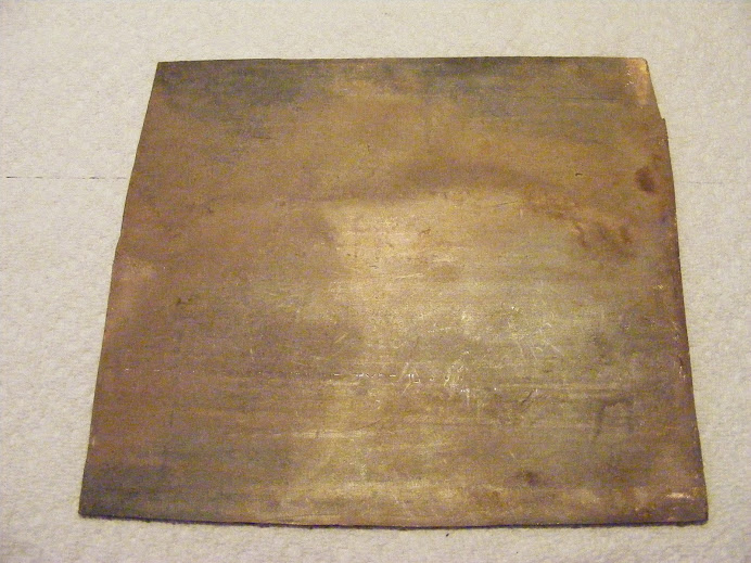

- The emitters and drivers will all be on one large copper plate with only one positive power wire and momentary switch wiring to disconnect for removal. Oh, and 4 mounting screws.

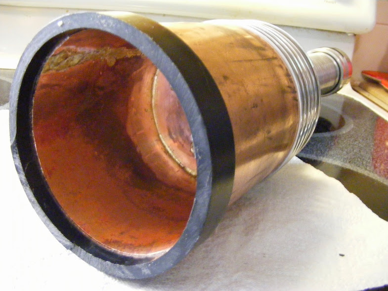

Here is a sketch to get an I idea of what I'm shooting for. The tube may be longer depending on driver choice. The reflector portion of the head will be longer. Still debating about having a handle. Also thinking about a different tail configuration. I like the size of the tube, but my wife would probably want a handle. The head will be about 5.25 inches (133mm) in diameter. This will help with heat sinking to handle a hard driven emitter.
The upper head will be built from copper. The cooling fins for the lower portion of the head will be made out of 6061 aluminum disks with a copper round bar through the center to transport the heat from the emitter to the individual disks. The primary battery tube will hold as many as 12 18650's, but the light can run on just 2 cells with a spacer, if needed. Will have a side switch.
Some parts are laid out in about the length that the light will likely end up being The ABS coupling is there to get a sense of the size that the head. To give a sense of proportion, the smallest cooling fins are bigger in diameter than the bezel of the T90 in the picture.
The biggest challenge will be the head. A 5.25" diameter aluminum tube is very expensive. I will fabricate that part of the head. Another challenge will be the large size of everything on the light. It will make many of the tasks such as polishing more labor intensive and awkward. There are some other challenges that will even be worse if I have the time to include a couple surprises I would like.
