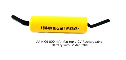

And yeah, I can find three AA cells with solder tabs and do the work myself. I got lazy and figured I’d look around.
What I need is probably about what the OP needed —- 3x 1.2v NiCD (NiMH would probably do fine) shrinkwrapped in pyramid fashion.

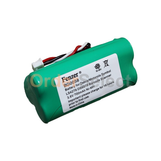

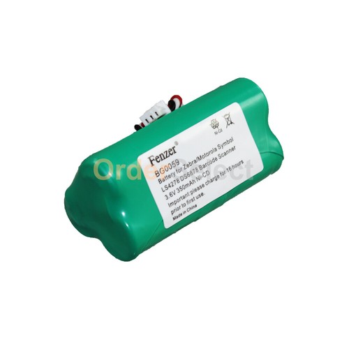

Well, I found 3AA batteries in the desired configuration, both NiMH and NiCd — but they come with three wires — red, black, and white.
Anyone have a guess what the white wire is connected to?

I could be wrong, but the white wire is most likely going to a board meant for charging (connects to the 3rd pin of the charging port if it has one). Those are meant to sense when the charger is connected. It would be helpful if we could see a picture of the actual battery being replaced.

The battery being replaced has 2 wires, red and black. It’s the replacement batteries in the same form factor that come with 3-wire setups.
I ’oogled and found that a white wire generally is meant for a thermistor, in more modern battery charging designs, to protect from overheating.
People cut them off or ignore them when using 3-wire batteries to replace 2-wire batteries on old hair trimmers and the like.

Regrettably, the NiCd packs for sale are 350 mAh, which is pathetic.
So I guess I buy three cells with solder tabs and make up my own.
