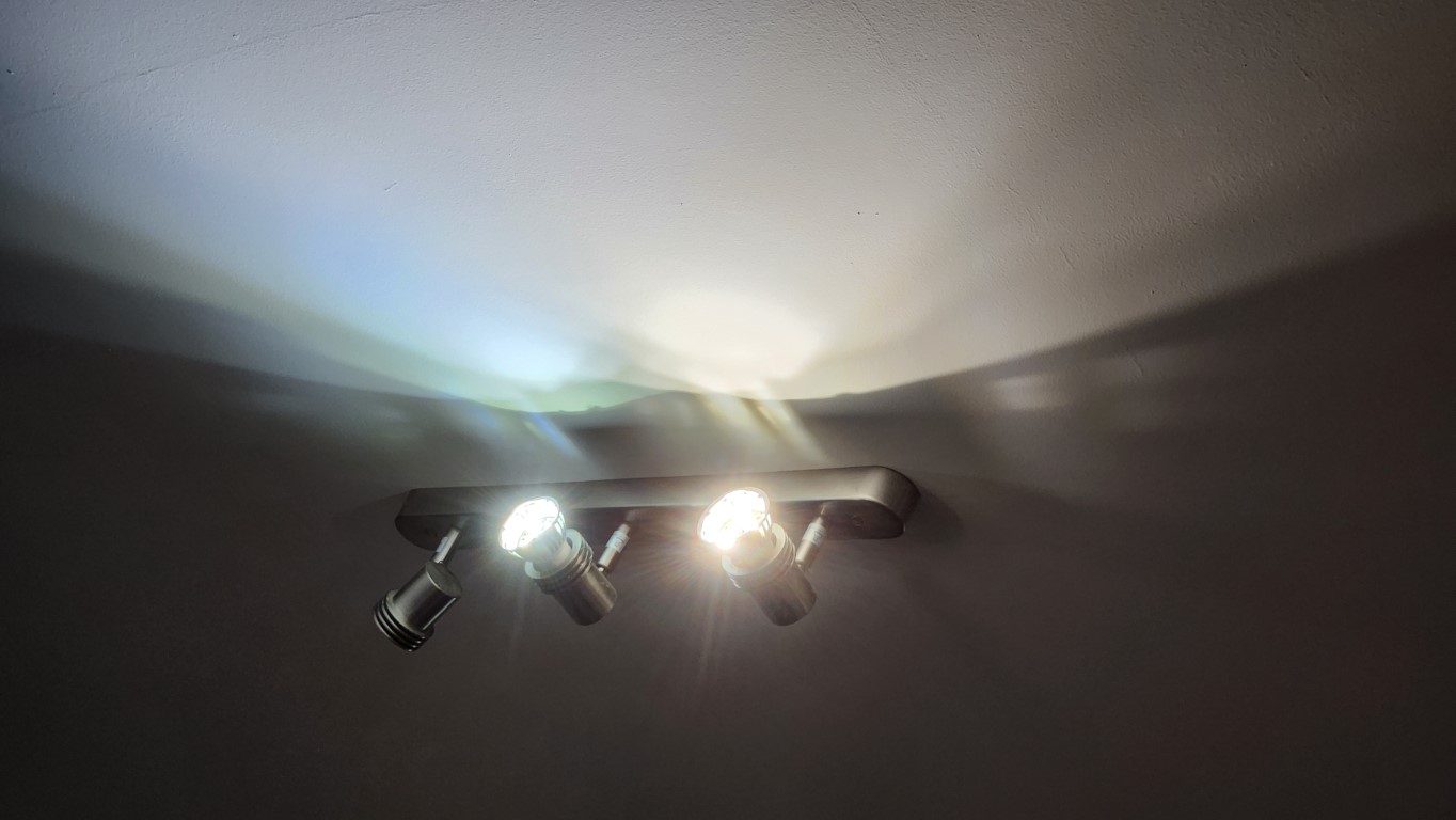

The first three done - on a GU10 LED bulb for a house light fitting- and they work fine.
Be gone hideous low CRI 6500K light. Original LED’s in the LHS, “Natural white” 90 CRI replaced in the RHS.

Thanks. I ended up changing the LED’s over in eight GU10 bulbs, each has three LED beads. (The beads are only 1 Watt each too, not 3W.)
The bulbs would be over 13yrs old, and out of about 15 only 3 have died in that time. They’re only Banggood cheapies too. Changing the LED’s made more sense than buying new bulbs.
That’s some really impressive longevity, especially for being cheap non-brand lights. Good job swapping the emitters!
