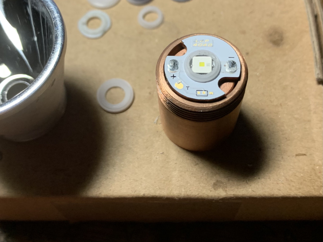

Maybe make the emitter hole round, to reduce the rotational force on the LED pad when tightening single emitter reflector lights…
Great idea^^^^^

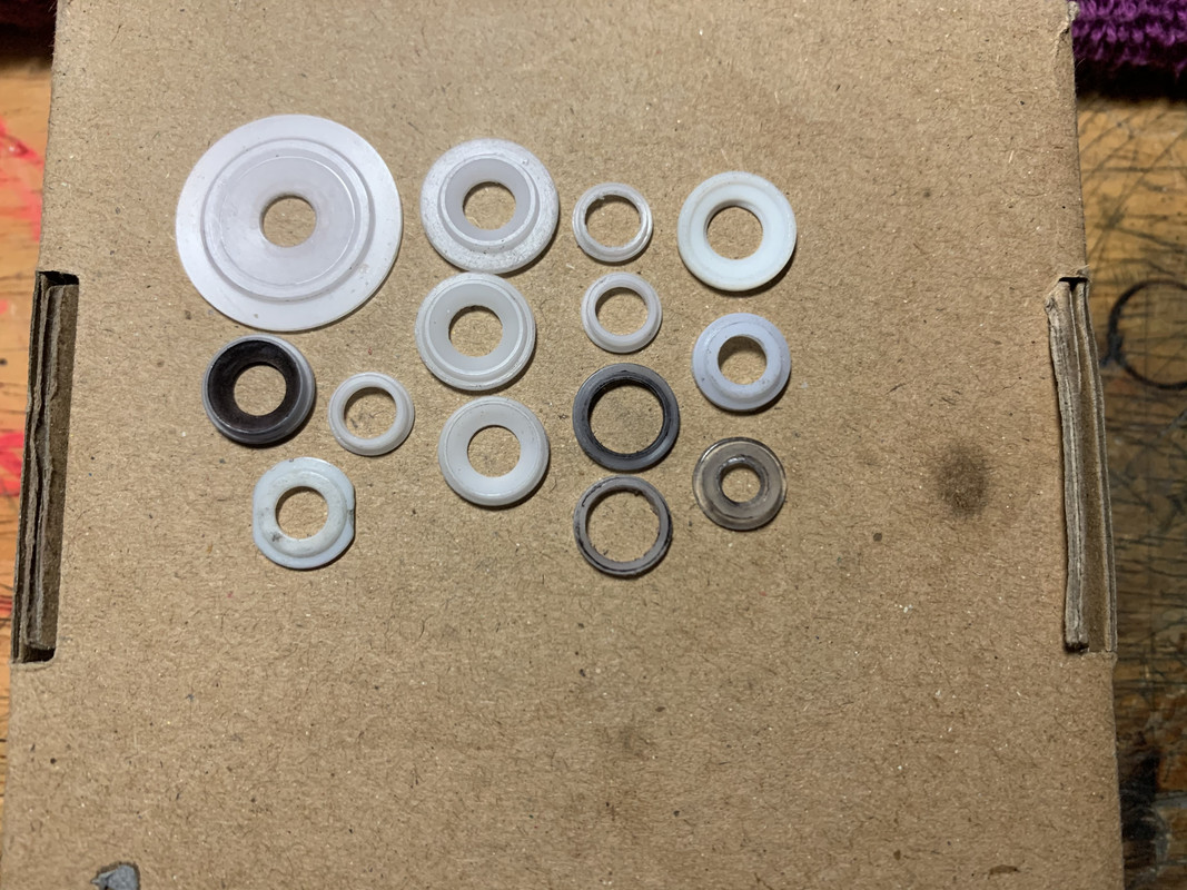

Like this?
Yep…
I don’t know why I didn’t think of this before. From your last picture, you have a centering, but it looks like for a 7mm hole. Do you have a pair of calipers you can measure it with? If I can get a measurement for the thickness of the shelf the reflectors sits on, I wouldn’t have to worry about verious sizes, would I? Currently, I’ve got 8 sizes in increments of 0.01mm. The largest is 0.75mm and 0.68mm is the smallest.
