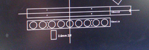

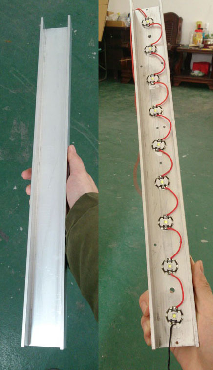

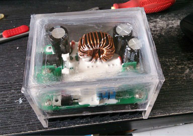

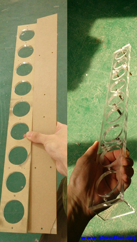

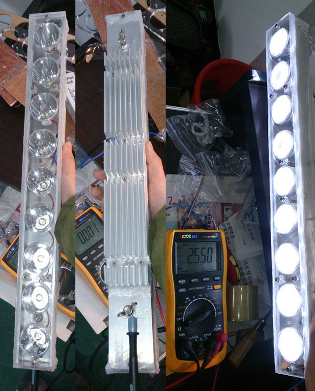

Takes me about a week to complete it. The original setting was 3A, I reduce it to 2.5A to decrease the temp heat.

I uploaded all my design pictures. You cannot see them? It’s strange, my friend in German says he can see them.

Some additional fins on top would likely help with the heat.

Thx for the suggestion, I could try to add it in my next model~
For now, There is only On-Off button. On means the full power which is 2.5A. The plan for next model is designed in 3 Gears which are 20, 50 and full power. BTW I am a FPV fan too.
