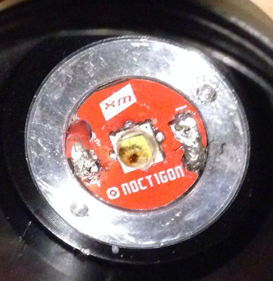

XML2 driving hard with a cheap black gasket salvaged from a SolarForce P-60…
Smoked the emitter. I think the gasket was made out of the same stuff electricians tape is made from.

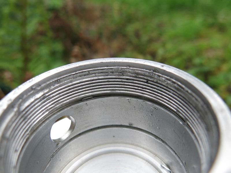

After rewiring my COURUI big head in series, adding a tail switch, building a heavy duty copper pill and a 7A driver, I was ready to go.
I installed batteries and began screwing on the head for it's first modified blast of light. I had about one turn to go and the cheap threads collapsed and jammed.
It would not come apart. I had to hacksaw it in half.
This made me cry. To get the light apart the head was damaged and the thread here and the battery tube was buggered. This was after two months machining. It nearly made it into the bin and yes I cried a lot.
